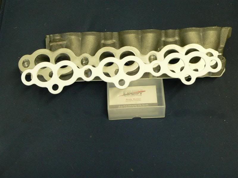

does anyone make 172 ones? I made one for somebody and was thinking about selling it as they don't want it anymore and was wondering how much to ask. Was just going to see if anyone else made them? Possibility of being able to get a batch made up in the future.

3mm thick, hum, you might encounter fitting problems there dempending on which rocker cover brether setup you have
If you put that on you may find that the inlet wont mate with the plenum correctly. Benr said to me before that its not really possible on these engine as the gaskets are too thin to have any benefit and if you made it thicker it wont fit. Would be interesting to try although not worth 35 quid imo

we had a couple of sets made for the V6, was very effective..... inlets were colder and FAR less heatsoak from the engine at standstill....
trouble with the F4R is the gasket is alot thinner... a 3mm one wont fit at all well...
its a product we would like to roll out, does depend how many people would buy it..
the gasket would really have to be the same or very close to the thickness of the OE gasket
(info from Andy)

Depends on PTFE thickness - I'd estimate 2mm gaskets about 20quid? Not a lot...
(info from Andy)

The company on ebay made no calculations at all with this. It's the worst thing ever, I'm returning mine. http://www.cliosport.net/forum/showthread.php?t=294427&highlight=ptfe
I think they should be 2mm. agreed 3mm is probs a little thick, but 1mm is just not enough to get good insulation surely.
those GDI V6 PTFE gaskets look to be 2mm
