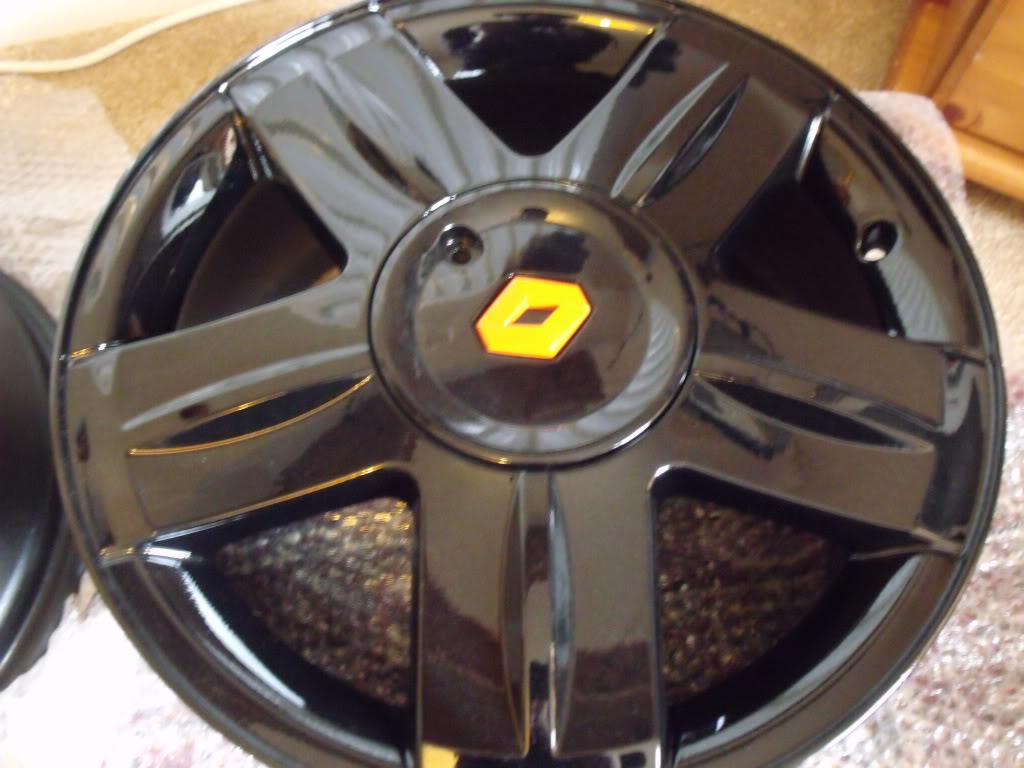

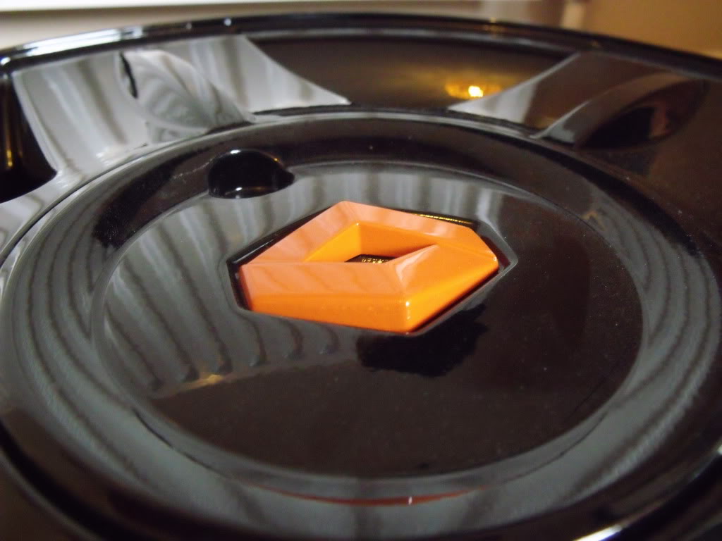

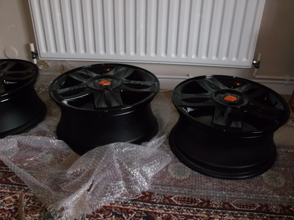

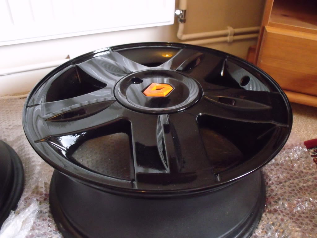

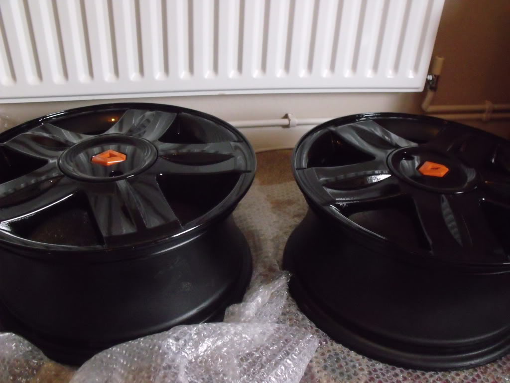

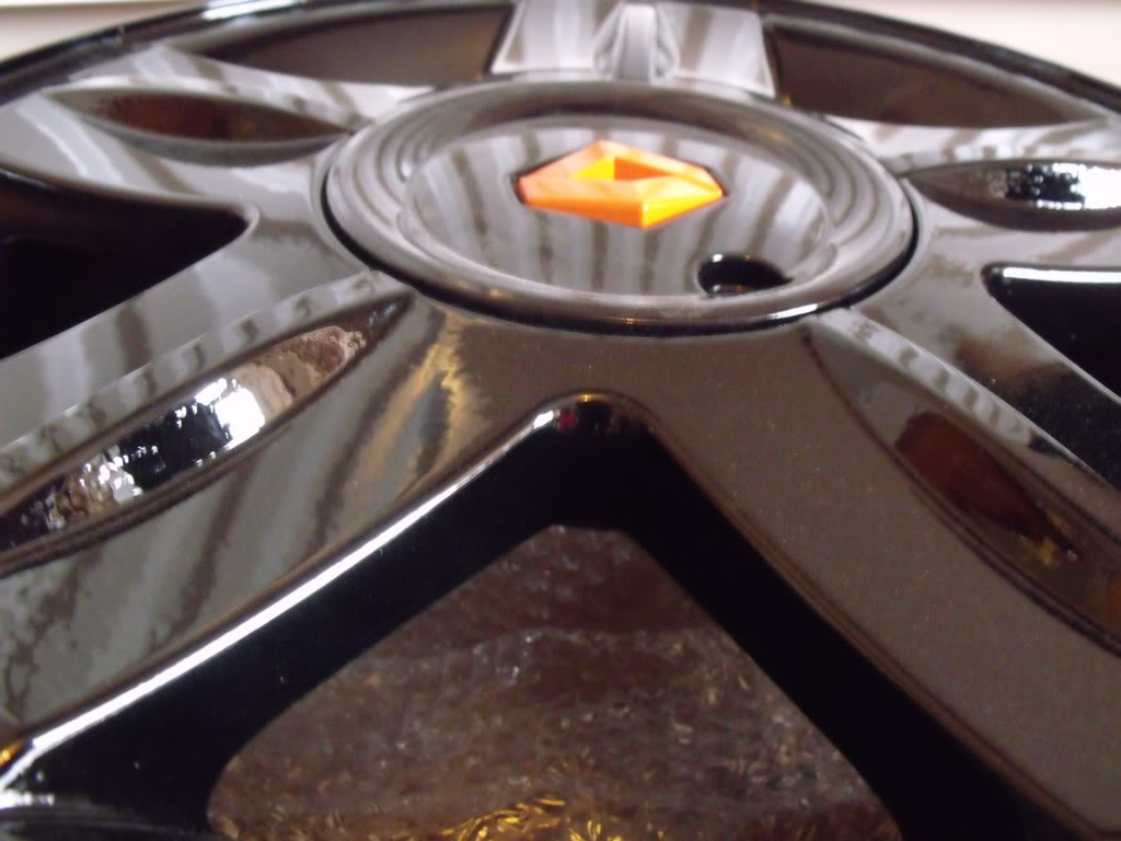

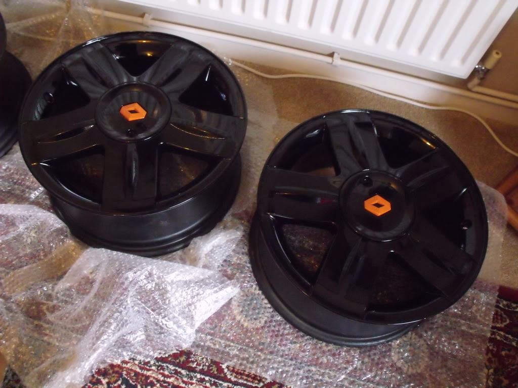

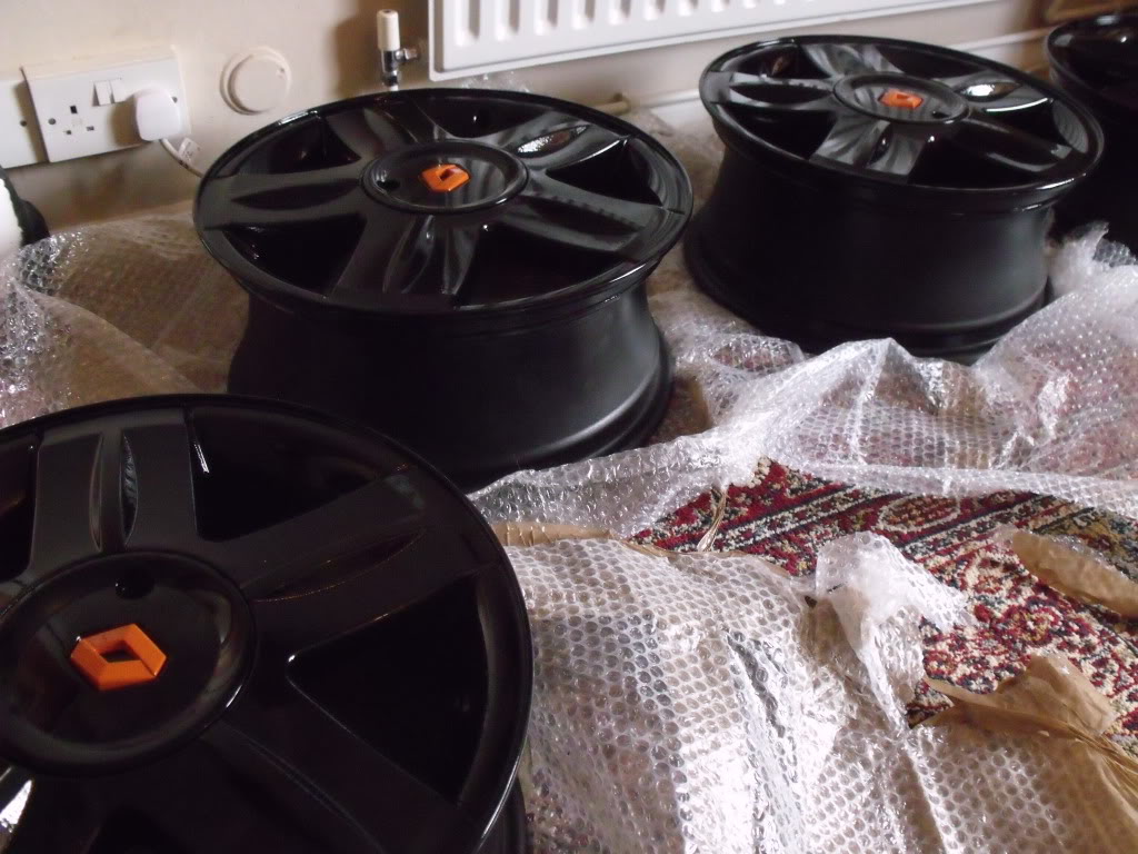

172 wheels back from bodyshop
  MG ZR+ 105
Not on the car yet but I couldn't wait to show them off :rasp:
tyres just came but are not on yet

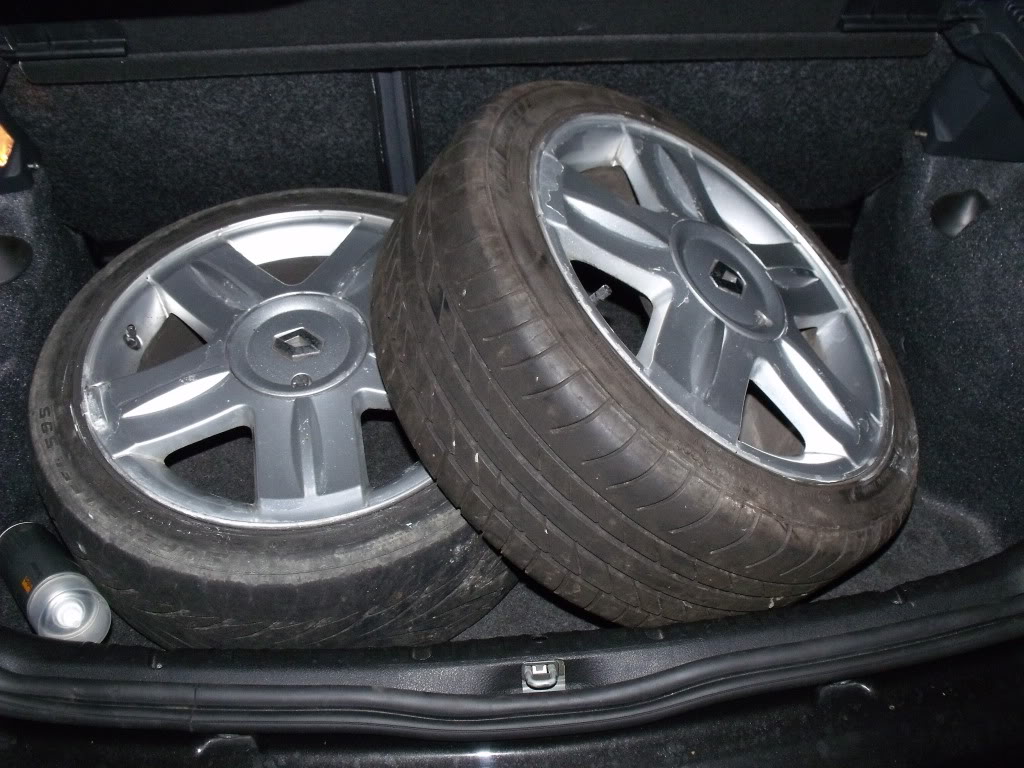

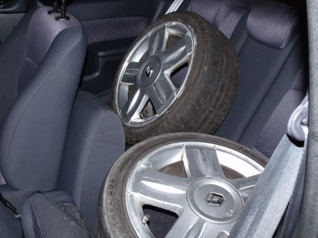

BEFORE:
(I told them to get rid of the tyres as they were fecked)

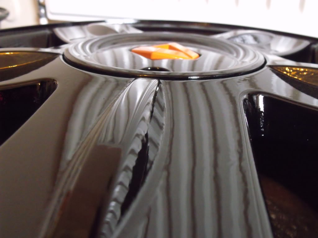

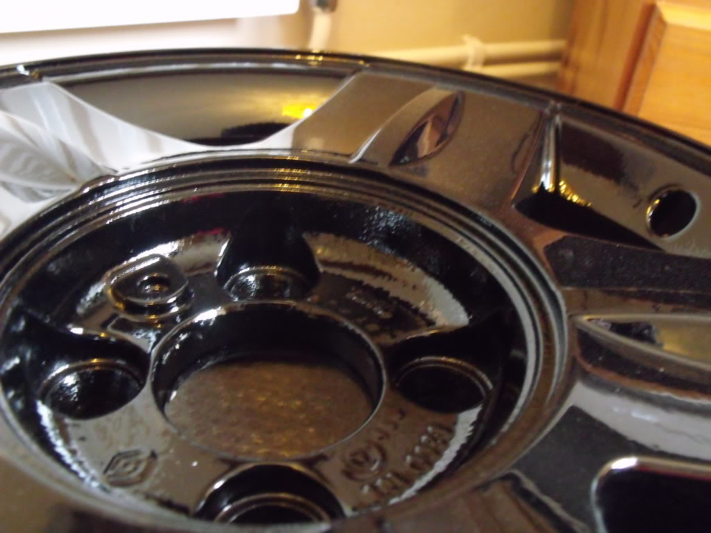

AFTER:
Sorry for the lack of pictures :rasp:
(they also still have dust on them from the body shop in the pics, I've cleaned them now :))

Lovely finish mate, looking forward to pictures.

Very nice indeed, first thing you should do is screw in the wheel nuts and scrape out the paint from inside the holes that the nuts go in, this is a safety thing.
Then get some wheel guard on em before you put them on the car.

ok thanks what will happen if I don't do this (just out of curiosity)

The wheel nuts will work themselves loose as the paint/powder breaks up. Think about it, just screw them in now and see how tight they are, when you take them out a bit of the paint/powder will come off.

ok I will sort them out then
don't want a wheel coming off... again lol (wolfrace alloy came off on my old Ph1)

They failed to tell me about this and me being daft didn't pick up on it until I was getting a very scary feeling through the steering wheel not to mention the noise.
Trust me you need to do this before you put them on the car.
(they being a different place, not the same wherever you got yours done)
