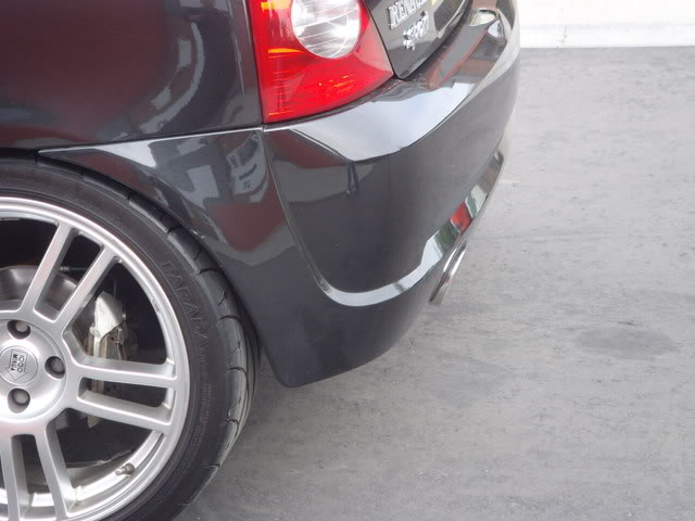

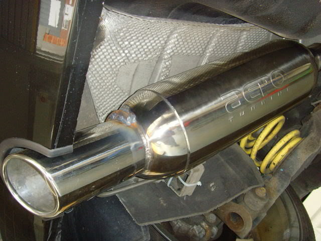

I also have a 182 for 2 days on the 24th and 25th of April so with a bit of luck things might get moving on the Jig....This customer wants a twin rear box system... using the 2 x AT2525XL Silencers and the same tips as Matt had (cut down in length) to fit the boxes... If this combination works well it could be the way to go for the 182's
Will get pics and a Vid no problem at all

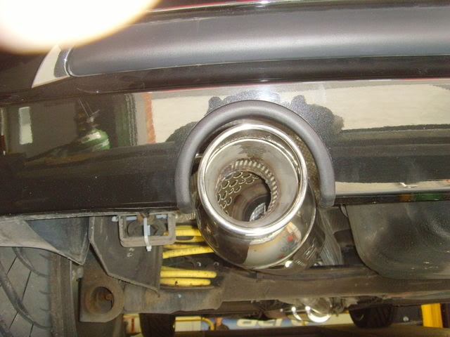

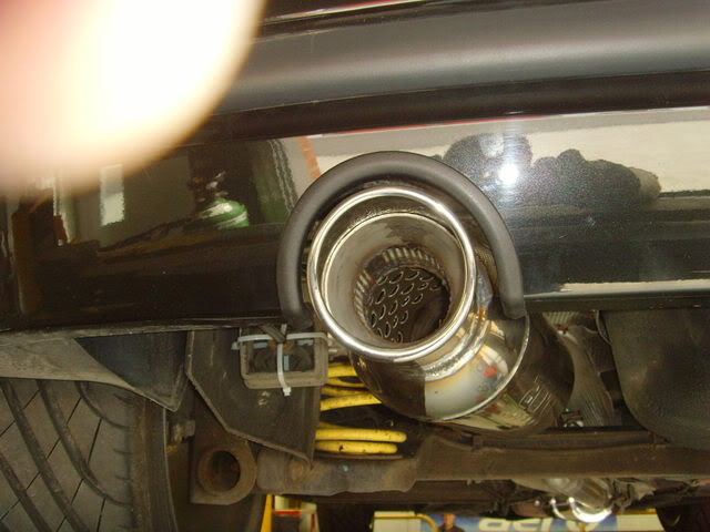

Well, Another 182 was finished yesterday.
Totaly different from the first one, and a lot more work this time
We ran out of light and time for pics and Vids but he is comming back on Monday so we can get some taken...
This one does look and sound well! Very Deep tone to the exhaust note,
79 db on tick over 92 db 1/3 throttle 99db hard reving. It sounds different to every other Exhaust for these cars IMO
I have a few options to quieten it down if need's be but its to the owners taste
This one has a High Flow CatCo USA Cat (Made for BIG engines) then into 2 x AR25 then y'ed and into two AT2525XL (With the Aero Turbine tech inside) and straight out the back by two ST2535F Tips

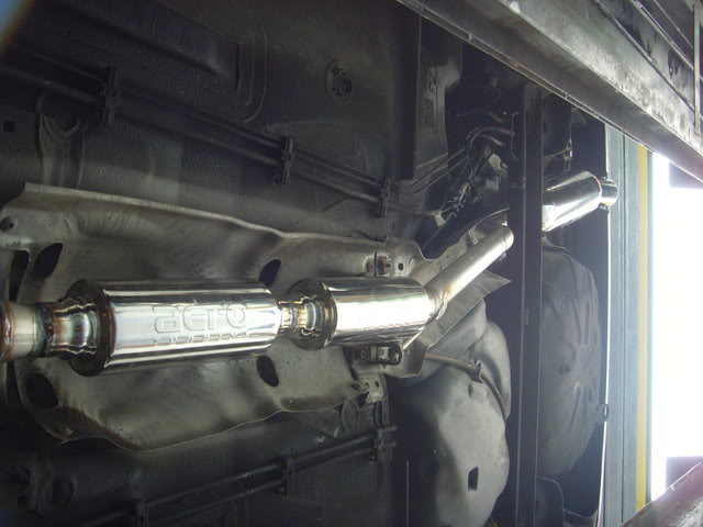

First 172 system was done yesterday, And to be honest not a complete sucsess. BUT I know how to solve it and Im reworking the system on Thursday.
THis system wanted to be quiet but sporty. Well Ive got it down to 90.3 db at 1m away, which is abaout as low as a straight through system you can get. With a great sounding Deep tone. Stand at the front of the car and you can not hear the exhaust note over the engine noise... Stand at the back and its burbling away
So I was happy...BUT we have found that the deep tone travels directly through the car and resonates at around 3000 to 4000 rpm , Its sounds like it comming straight through the rear hatch :-(
On thursday this week Im totaly rebuilding the rear silencer in to a custom resonator to deal with the problem. Im also going to look again at the hanging solutions we have available as the front OEM mount is useless and the one rear mount wont hold the system solid enough for my liking.
All part of the development work Im affraid and nothing I can not sort with a little time and effort (now in my time and all FOC for this customer...but its got to be right)
So Andy, Dont worry I'll be able to navigate around this issue before you come over, and we will know exactly what we need to do.
Oooh by the way. One of the 182 Exhaust cut out plastic trim's on the back looks good !
Pics of the system so far to follow in a bit

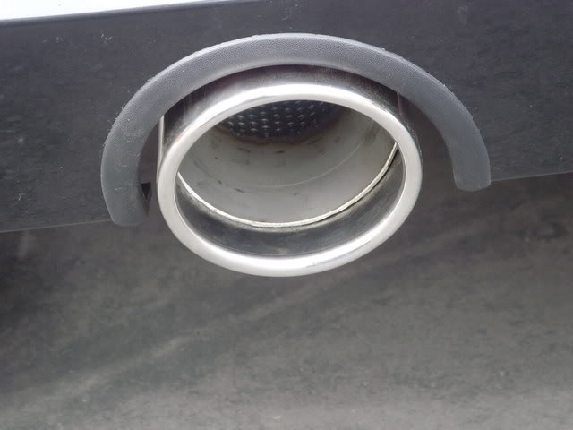

Just to add the end of the little resonator silencer cone in the tip will disapear from view once a bit of carbon forms on the tube
Fin, let us know what solution you come up with on the OEM hangers, cos both mine are shot and if you come up with something, i won't replace mine yet, i'll get it done when i bring it to you.
Also the resonation at 3-4K happens on mine but has been reduced when i moved the middle box back towards the back of the car, with the pipe you sold me.
the 172 system you made, has it got 3 aero silencers on it? if so is there enough space if you moved the 1st box to in front of the over axle bend? if not how loud would it be with 3 aero boxes?
