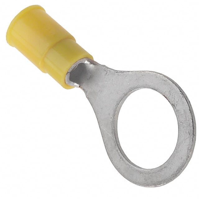

I'm going to strip the wire back a bit and slide one of these over it, no idea if I need to crimp it in place or not though.
Dr HMS Derv Destroyer
  MK1DTi/vivaro/corsa
yeah, the yellow bit needs to be crimp't to to te cable. it acts as a crush clamp on the wire to hold it still. iv tried it with pliers before but it doesnt hold very well

I used a heavy duty o-ring like this one below.
I would not be using some small thin one like this.

Yeah two crush fins inside the plastic casing. Strip the wire back and push it until the wire starts to come out the crimp. Dont crimp it on the wire casing or it'll melt it. Or make a bad connection :)
you want a big ring crimp. Bit of red heat shrink ( or any colour ) and srink the heat shrink onto the cable and the crushbit of the crimp after you have secured the wire. Or cover it in elec tape
