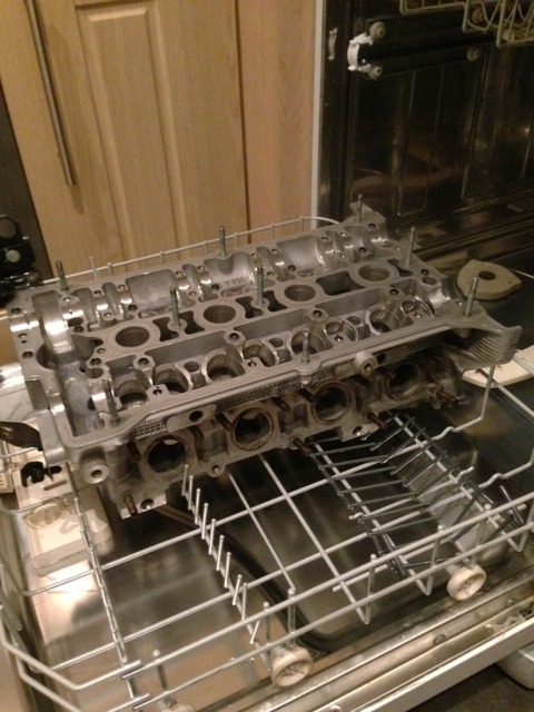

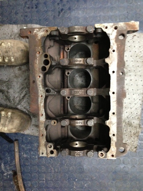

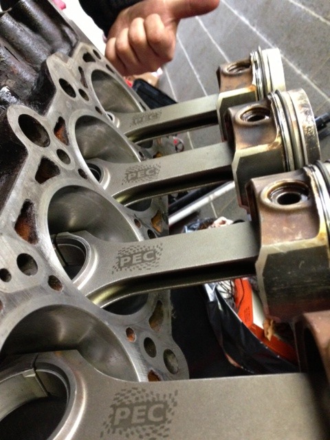

After a seriously god thrashing the car decided to "drop a valve at 7000rpm! so i had to simply look at what had happened and why, the valve set is good and prooved for 450/500Bhp, the 20vt suffer very much from worn valve guides, and this is exactly what this was the valve came doen on a angle and hot the pistons with a very bad impact.

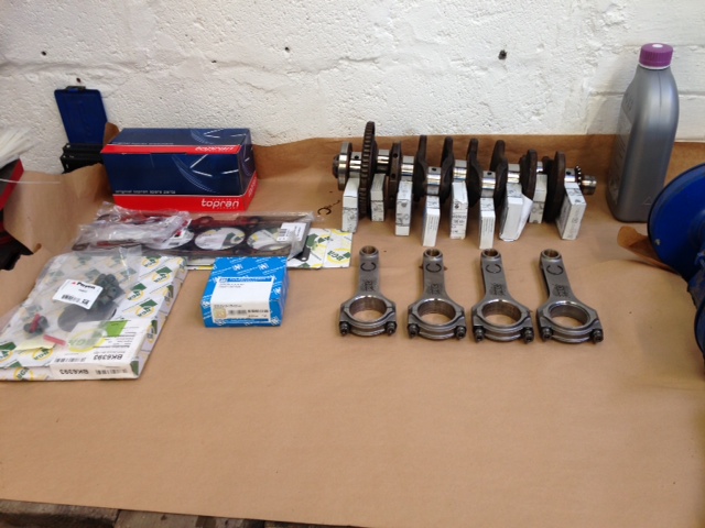

Never mind, i got my self a BAM engine and started again..
Fored PEC ( wosigner ) Rods
BAM Pistons with lower compresion
BAM head
ARP Bolts
Sachs Uprated vr6 Clutch & Fly wheel
Crank Balaned with Fly Wheel
Uprated Oil Pump
New Tensioner for Head Chain
OE Bearings
OE Rings
OE Gaskets
Block skimmed and decked.
BAM Oil Squirters
Here are a few pictures,

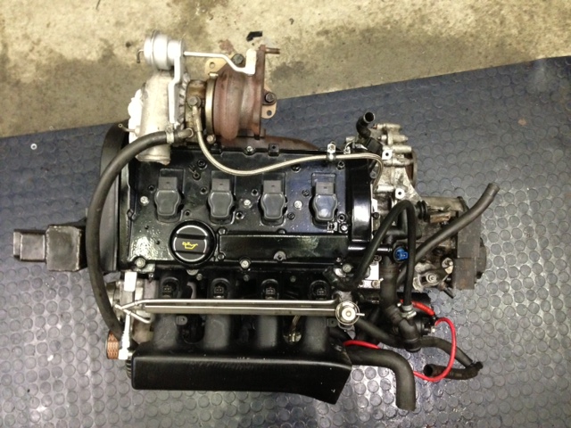

Oh and a IHi Vf35 :) 620cc injects and a 325lph Pump :)

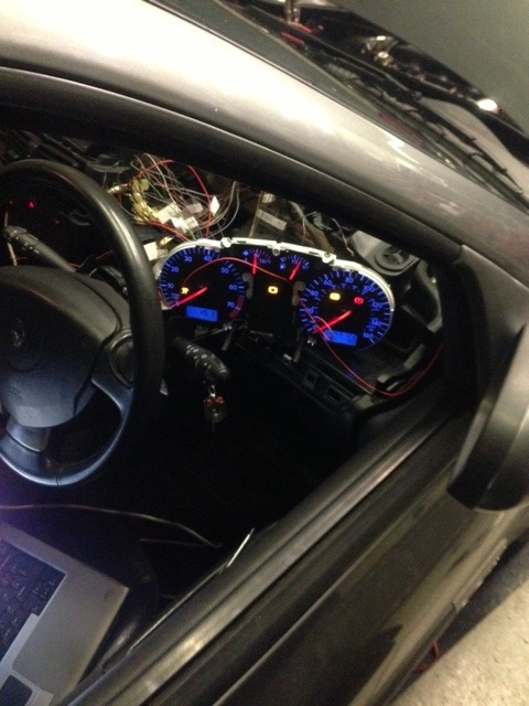

Ive also sorted the speedo/rpm and all other clock things out by fited the VW golf clocks :)

these were trial fit pistons the items i used were brand new from Audi

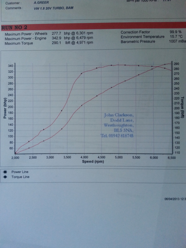

Let the clio HIT the dyno :)

its not a case of chasing power Chip, i want torque to the red line that the TD04 cant do :)
The car is awsome even at 1.bar it delivers the power so well and belive it or not it DOESNT just wheel spin the 1.4 Map however is crazy but boost per gear still needs set up and mapping finished
Power is nothing without control, definately the mapping is important.
I find throttle angle vs rpm the most useful thing to map against for boost not rpm per gear though TBH (well unless using something like autronic where you can do throttle angle vs rpm vs gear in a 4d table by combining GPC tables, but most ECU's cant do that of course!)
