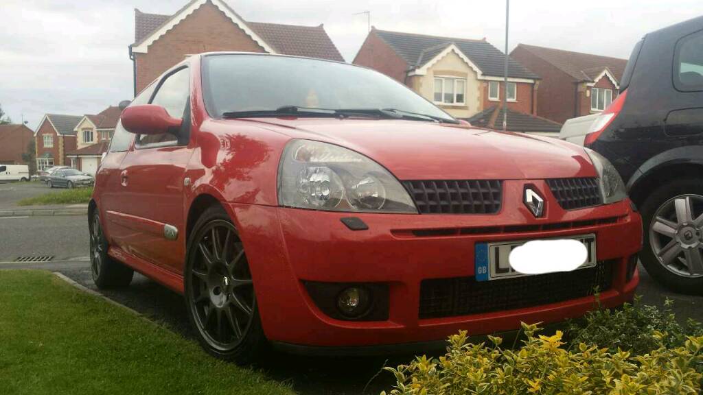

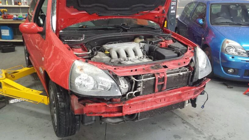

Well I purchased clio trophy at the end of 2013 with a few minor faults and tlc needed.
I've been so busy with customers cars that I've not done any thing to the car what so ever apart from change the oil and filter and stuck some d's 2500 pads and PF fluid in her and went to knock hill.
After missing 3rd gear I shone a synchro and now the poor girl crunches into 3rd when at 6000 rpm :(
The belts need doing and the dephaser is rattly, the clutch release bearing Is noisey and is documented from two years back that it was then.

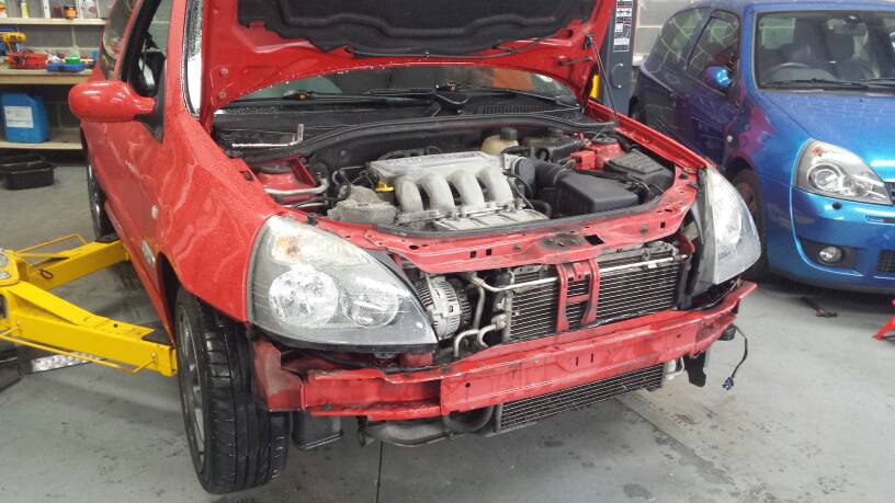

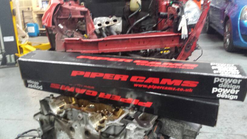

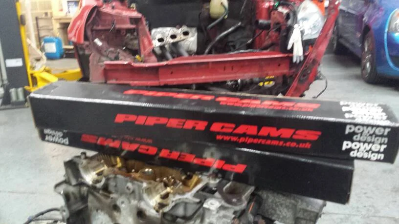

So today after a MUST do this and awaiting parts for jobs we've started the engine pull to do all the bits on one go.
Piper cams
Adaptronic ecu
ported and polished clioturbo inlets
Clutch
Gearbox that's been re furbed
Pure motorsport gearstick
PM strut tops
Valeo clutch kit
Dephaser
Timing belt
Aux belt kit
Spax sxr coil overs with sachs going to refurbished and to keep with car.

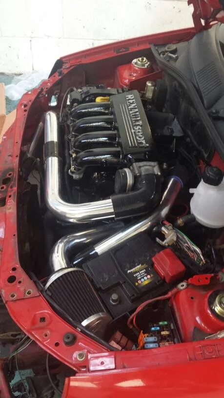

Hi guys.
After a long time I've never had time to update my thread.

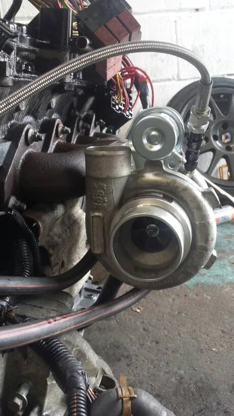

We all knew it wouldn't stay NA long. ...

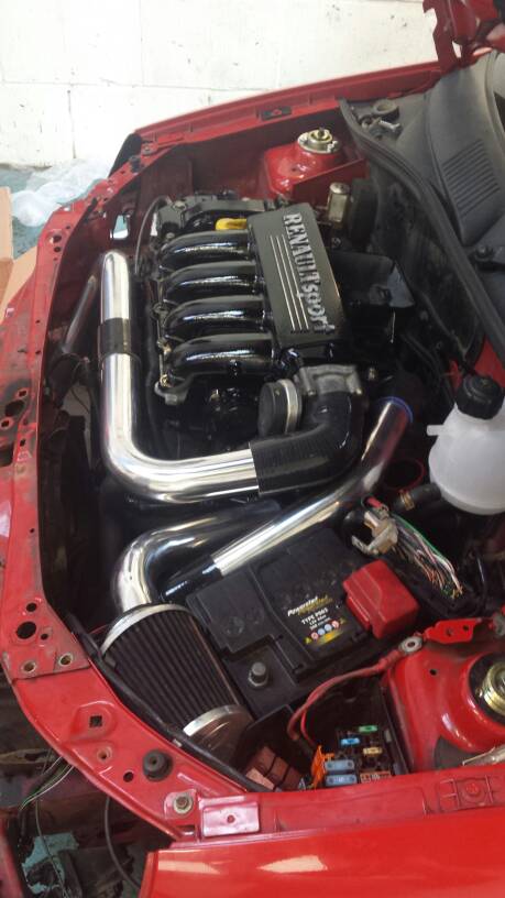

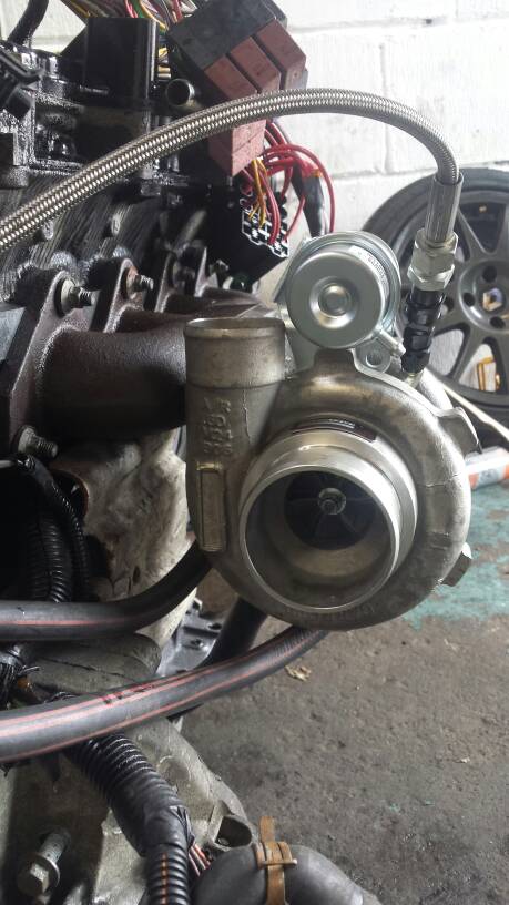

I've went a little bit mad and stuck a set of pistons and rods in her and a Snail.
Few photos

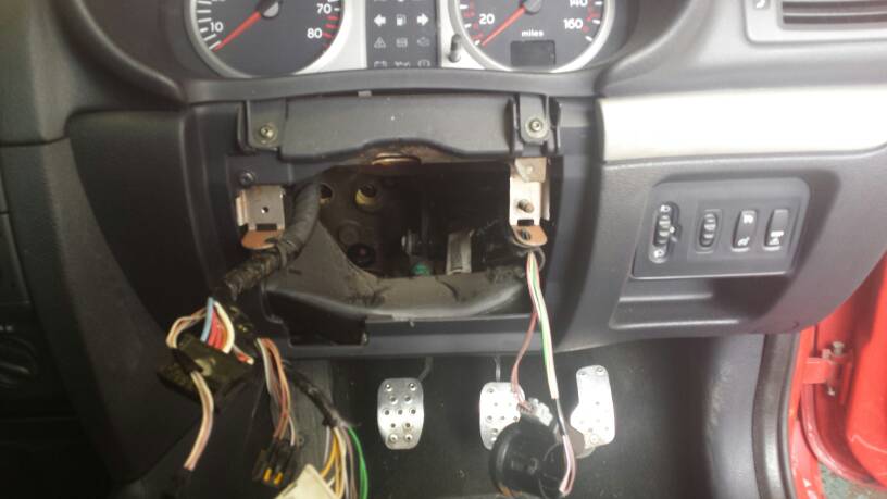

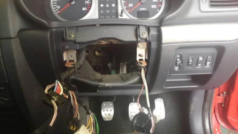

After a pas pipe fail and nearly taking the aux belt after pump sized I've decided to go epas also! Such a simple and easy conversion just hope the steering feels as it did with the adjustment I have with the adjustable resistor
uploadfromtaptalk1403592649206.jpguploadfromtaptalk1403592664810.jpguploadfromtaptalk1403592681688.jpg

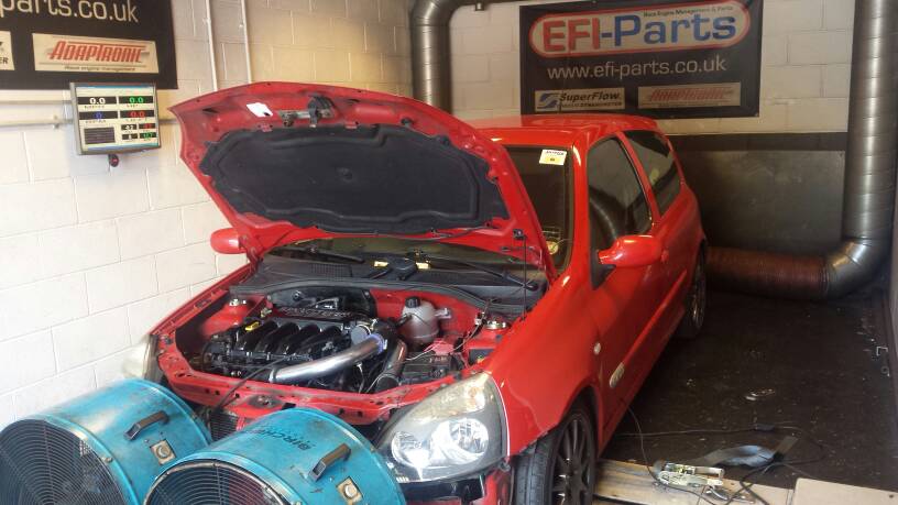

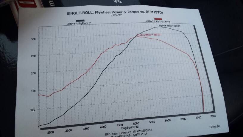

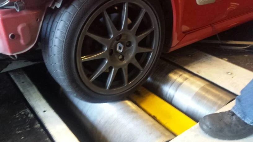

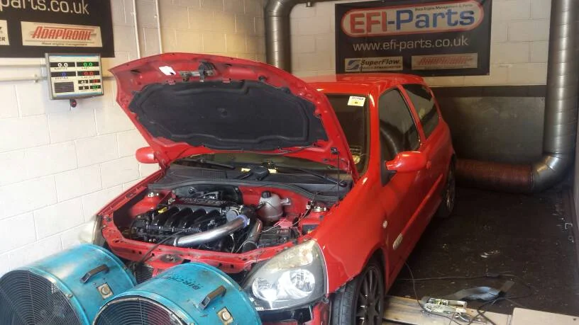

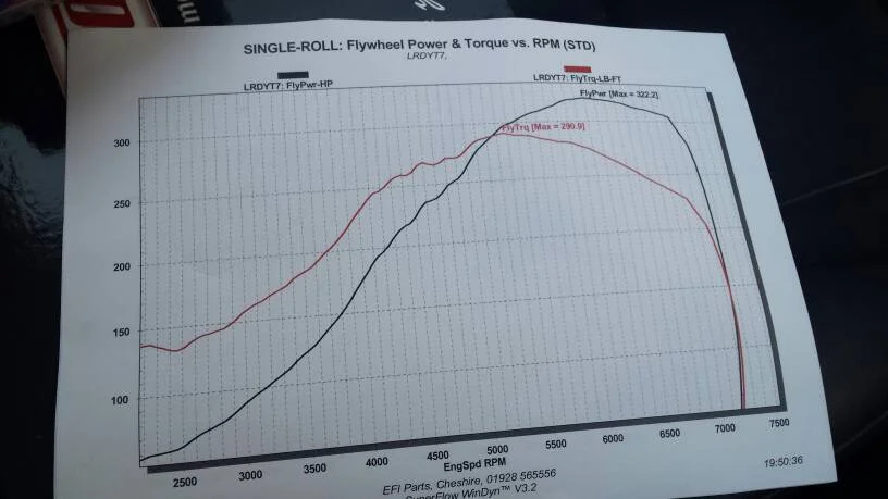

Well progress went well last week and we got to the dyno at efi for tweeks on the mapping side of things again big thanks to chris

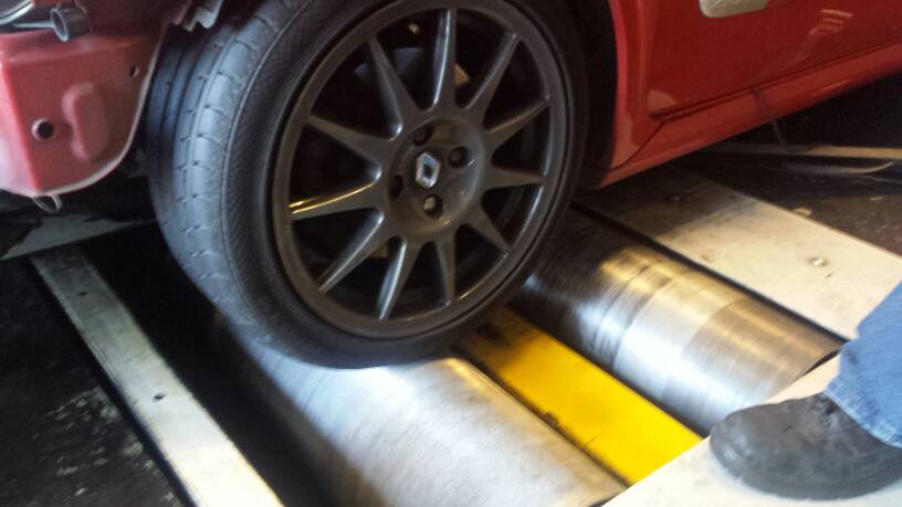

We managed to make a lovely number at 1.15 bar and the car pulls so we'll, we had to strap the trophy to the single roller ( the big boy Billy roller) as me and chris mate kev called it. As the car was spinning up

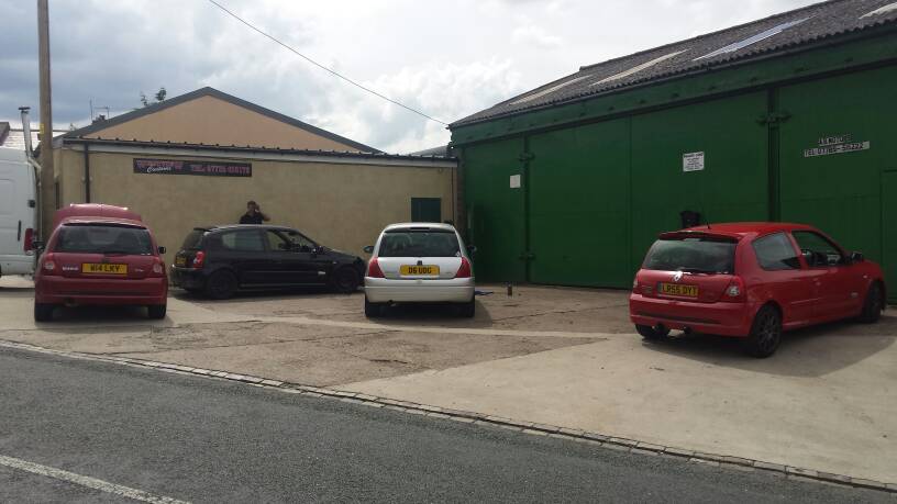

Little shot of over 1200 bhp of cars today too!!! All tinkered with by us!
uploadfromtaptalk1405236675544.jpguploadfromtaptalk1405236695799.jpguploadfromtaptalk1405236710440.jpguploadfromtaptalk1405236719126.jpg
