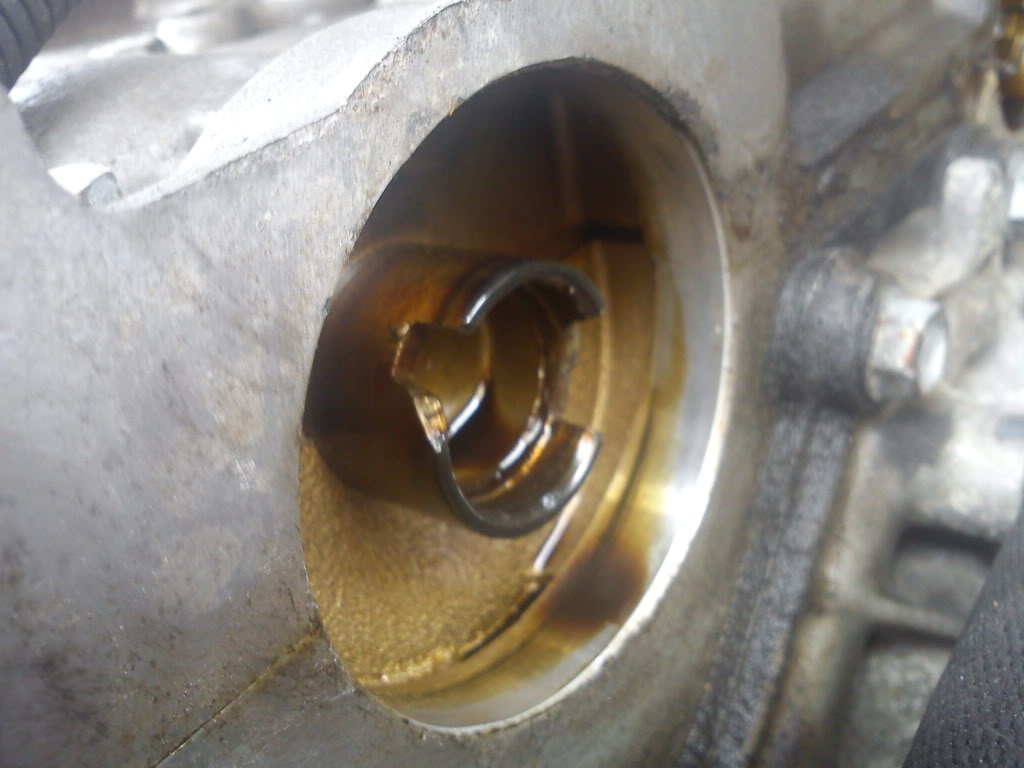

ive got them out and this is what i found. take a look at the slot on the inlet cam
  Lotus Elise
How has that happened?!
Someone has messed with it who doesnt know what they are doing. ( Not aimed at OP btw)
That is going to be tricky to work around, I have never come across one like this but I'm sure Fred or Mike will be able to give you some advice.
  Yozz'd up 182
So it has rotated 180 degrees? surely it couldnt of been that far out or have i misunderstood?
  Monaco Clio 172
i didnt have the crankpin in when i took the end caps off. when i turned the engine over to time it up the most damaged side of the cam was towards me
  Monaco Clio 172
how do i tell if the crank pin is in the setting groove or the balancing hole???
i got it in one then pulled it out a bit to find the other but i cant.
