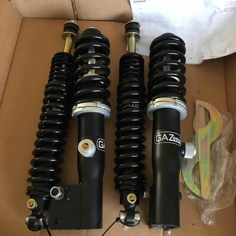

Mine turned up today, rears are on I'm just waiting for my new top mounts to come so I can get the fronts on.
  Clio 172 (CUP)
On the subject of top mounts Nick @pure-motorsport motorsport managed to get me a set of his in less then 24hrs, would recommend him aswell as @Mash for sorting the coilovers to anyone.
Good to know they are compatible with the PMS ones, less hassle for me then. Looking forward to hear your impression of them, hope you have an easy job of putting them on today

Fitting was really easy buddy, just having some grub then I'm off out to try it.

I did another track evening last week, they seem very good. I was a bit worried about the rears being to stiff but the back was amazing, felt very planted. I did have a bit of understeer mid and exit of corners but I'm hoping to overcome this by stifining the rear up a bit more, may even raise the rear end a little, either way it's down to me getting the car set up and not a fault of the suspension.

Hey buddy, still had a little bit of understeer however I think it's down to me not chucking the car hard enough into the corners, with a bit more confidence I'll go harder into the corners loading the suspension up creating more grip.
If i bought them again I'd prob go slightly softer on the front so it was a little more forgiving, the back I'm very happy about, feels very very planted and only oversteered when provoked.
Overall I'm very happy with them, with a bit more track time I'm sure I'll get used to them, at the moment I'm still used to a lot more roll from the previous cooksport/cup shock setup, might try and get a whole day booked in rather then just a short evening session.

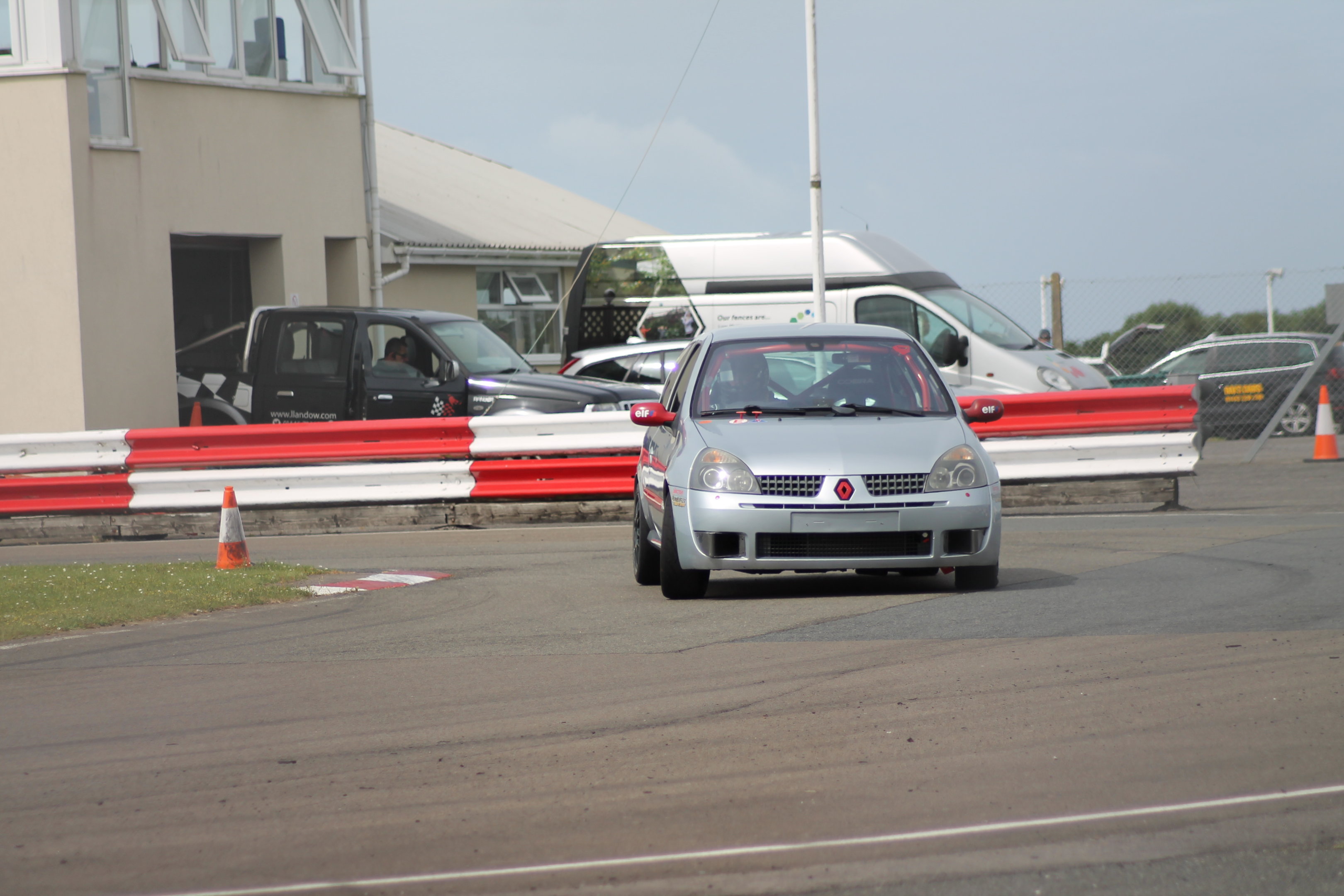

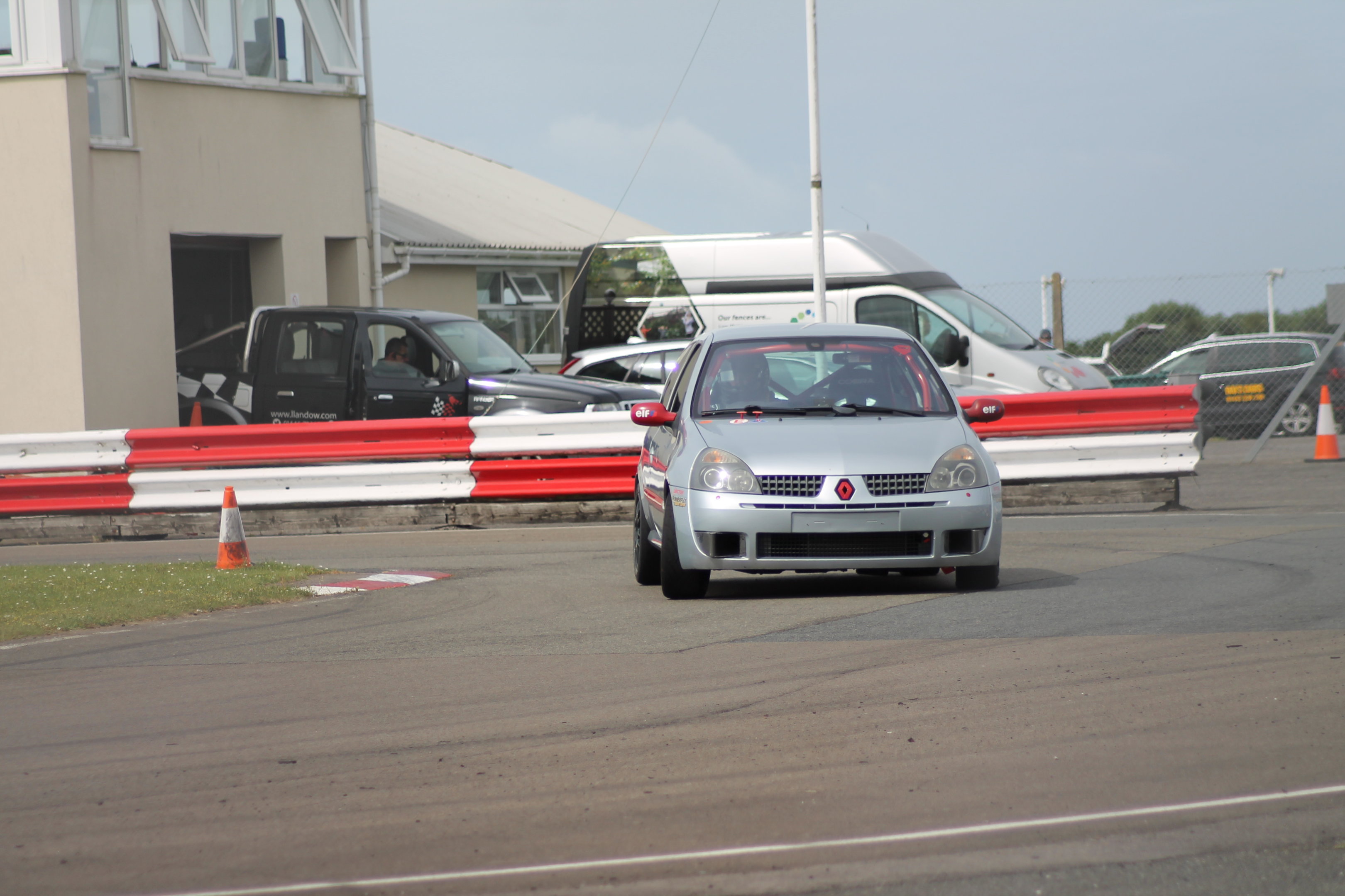

Firstly the before, this was on new cup shocks and cheapy Amax springs from euro car parts.
This is the 'bus stop' at LLandow, approx 35-40 mph 90 left, 90 right combination

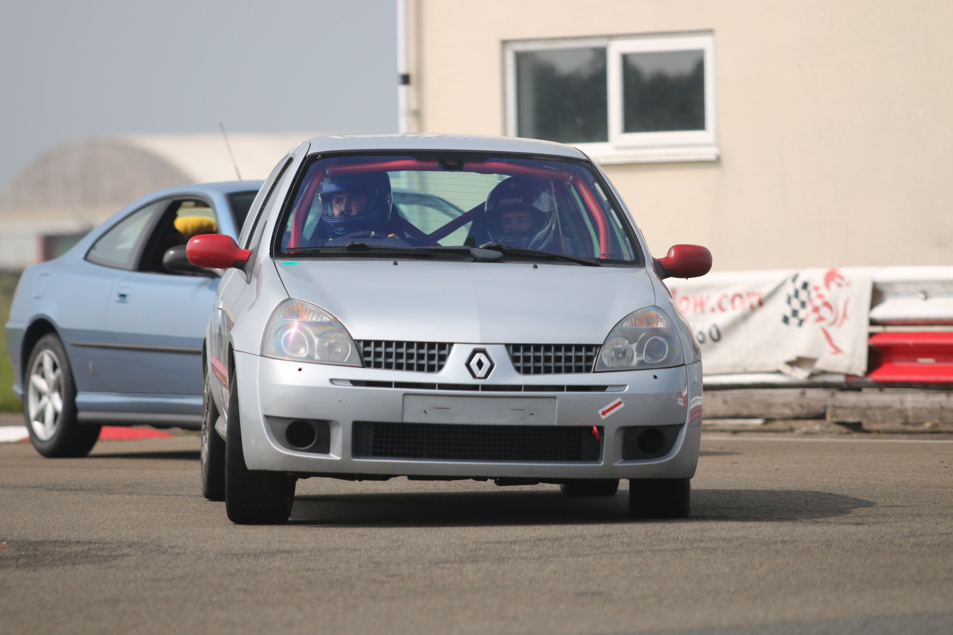

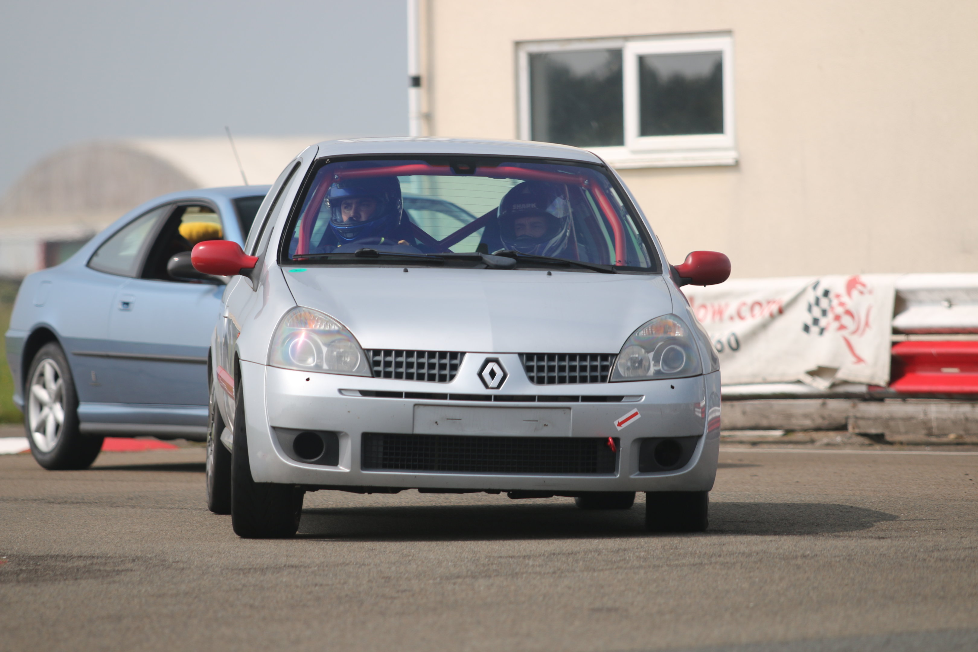

Secondly is with the new setup, Gaz Golds 800 front and 450 rear, combined with whiteline RARB
There are a couple of variations in that i had no passenger and swapped from 16's to 15's but for me the difference is clear, only slight downside being i felt a little too much understeer at times, but i was playing around with damper settings most of the day

@eon172 sorry its been so long with ref to video of my setup, still can't find my sd card with them on but i have gone through sme photos which hopefully show the difference between before and after
Too banana, thanks for sharing that, it certainly looks more planted [emoji106]
