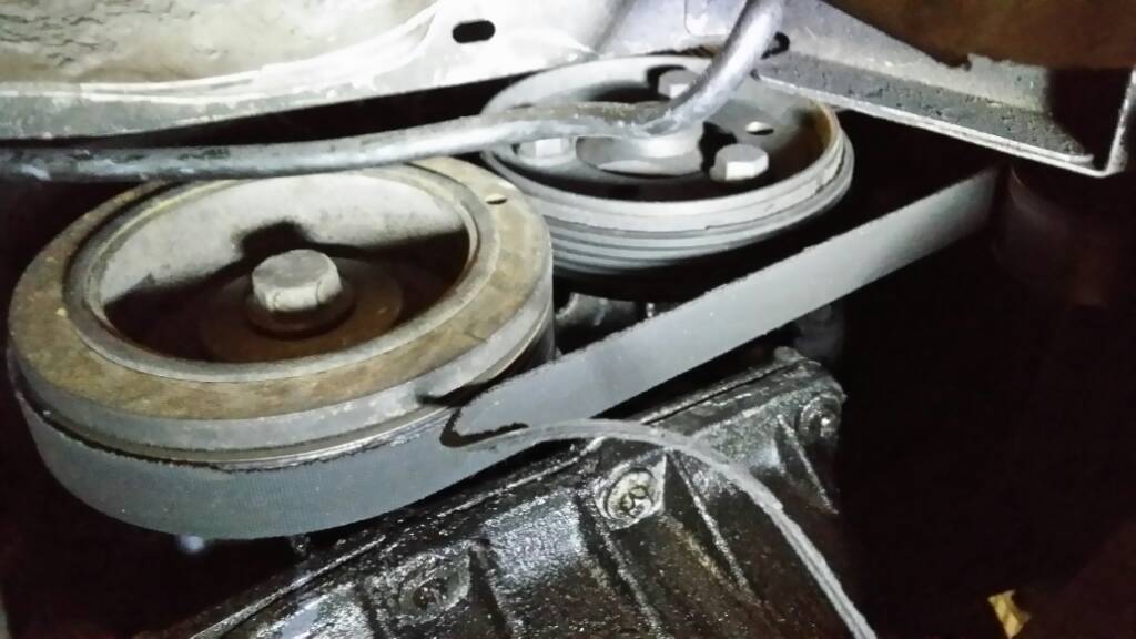

I can give you an example of something on that side with the aux belt that could cause it to lose compression...
Belt shreads and enters the timing case. This slips the timing and bends the valves... no compression!

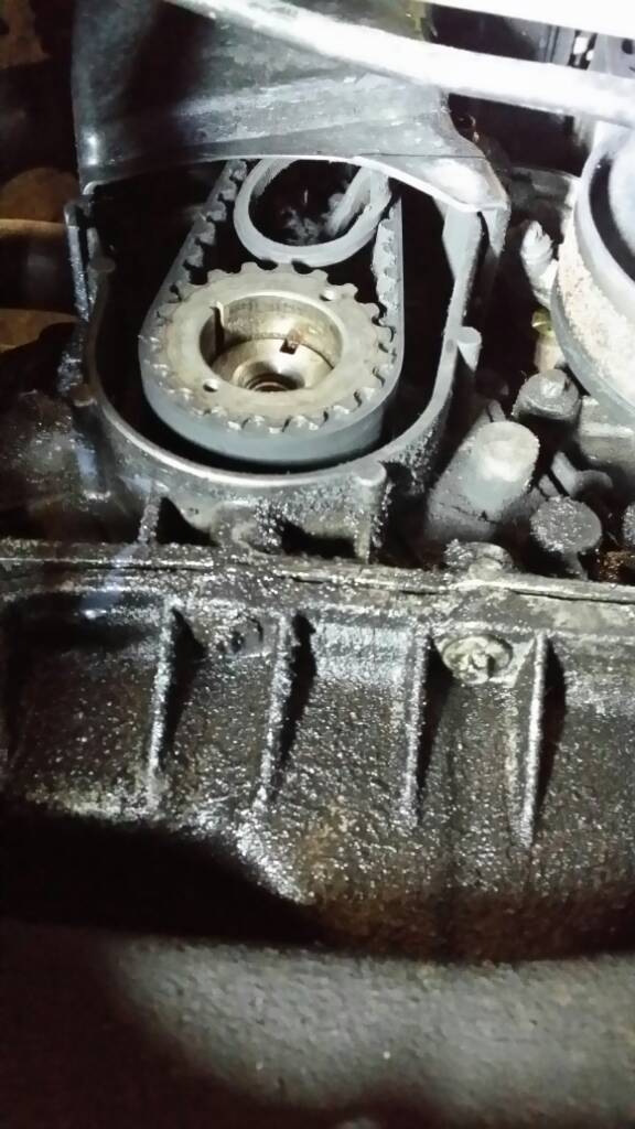

I would imagine the bit that shredded previously is somewhere around the back of the crank pulley and it is just unfortunate that it has reared its head as you changed the belt.
Did the car run when the belt was split? run fine? or not run at all. If not then the belt change was in vane.

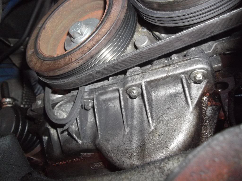

It may look like this? Same thing happened to mine.

To be honest there wasnt much that came off the belt, literally half as thick as a piece of string. When I have taken the head off, I found the timing belt tensioner did not take the tension off the belt, so I am assuming that this has caused problems, or that the bearings in the water pump seized - I base this on a high pitched whirring when the engine was initially started, which I believe can have an impact on the bottom pulley.
The cams were at completely different angles when I popped the caps off - the inlet was at 90 degrees and exhaust 180 degrees, so the dephaser side has obviously slipped or skipped.
I took the head off today and ALL of the inlet valves were bent upwards. The seats were fine. Most of the exhaust valves were also unseated so the head is going to get skimmed, crack tested and 16 new valves lapped in tomorrow/tuesday.
The top end is being fully rebuilt, timing, gaskets etc to future proof it.
The bottom pulley turns easily by hand with no scoring to the bores and the pistons are fine it appears.
