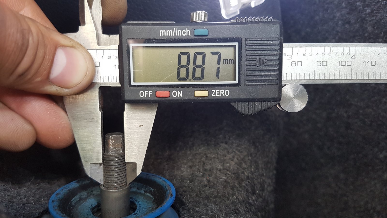

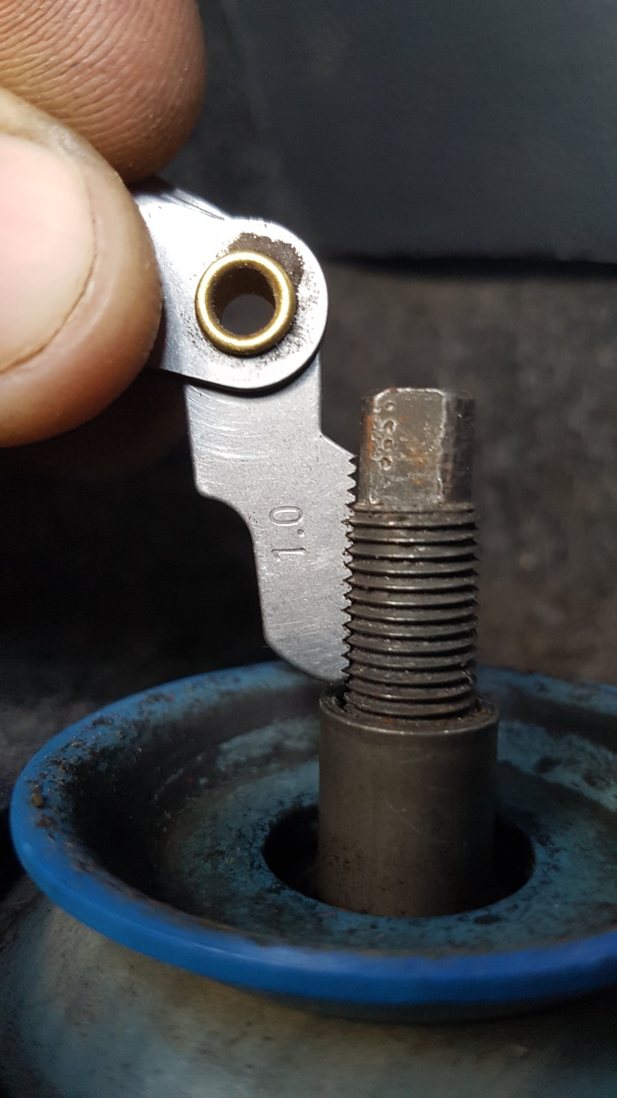

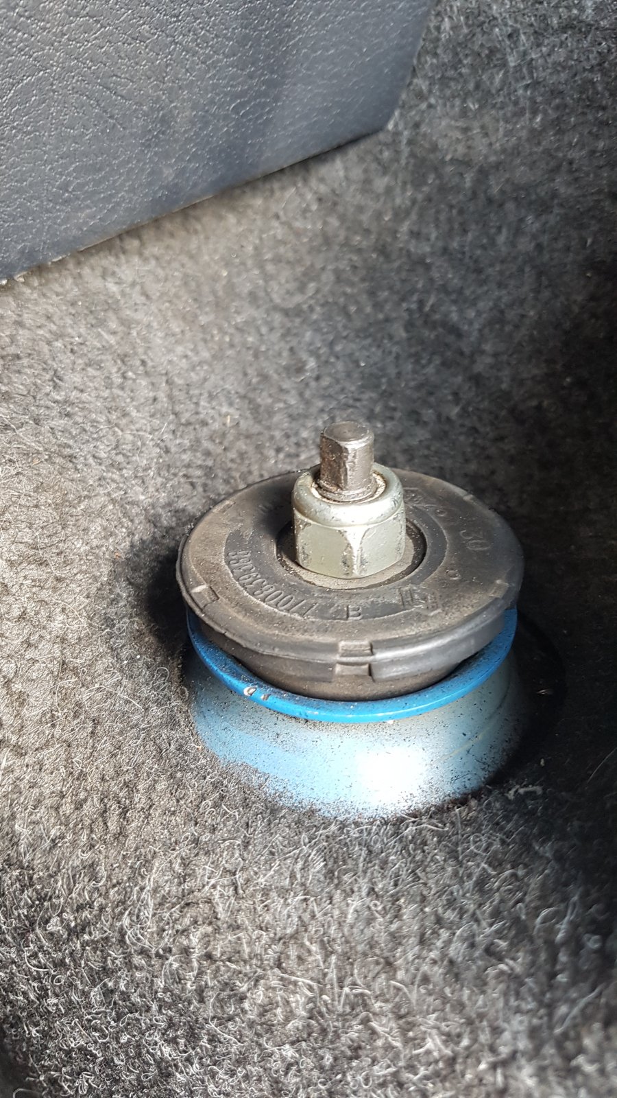

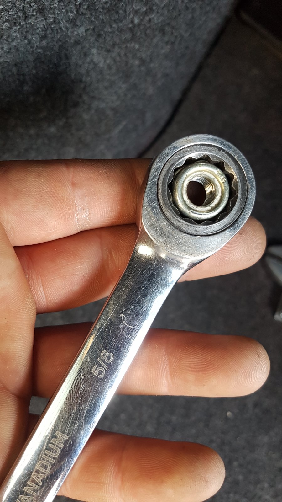

I got a set of bilstein b14 without nuts for rear shock absorbers. The current nuts do not fit, they are on a larger thread. What are the nuts that fit the rear shock absorbers? Did you get the set without the nuts?
Jekyll
Ok, I made a mistake. Well kind of. It's actually M9x1 pitch. But what threw me is the nut has a white nylon, which is normally imperial thread. Metric is usually blue, sometimes green for finer threads. I do use a 5/8th spanner though which I think is the equivalent to 16mm in metric.

Thank you very much for the exhaustive information. I will have to drive up to the turner tomorrow.
