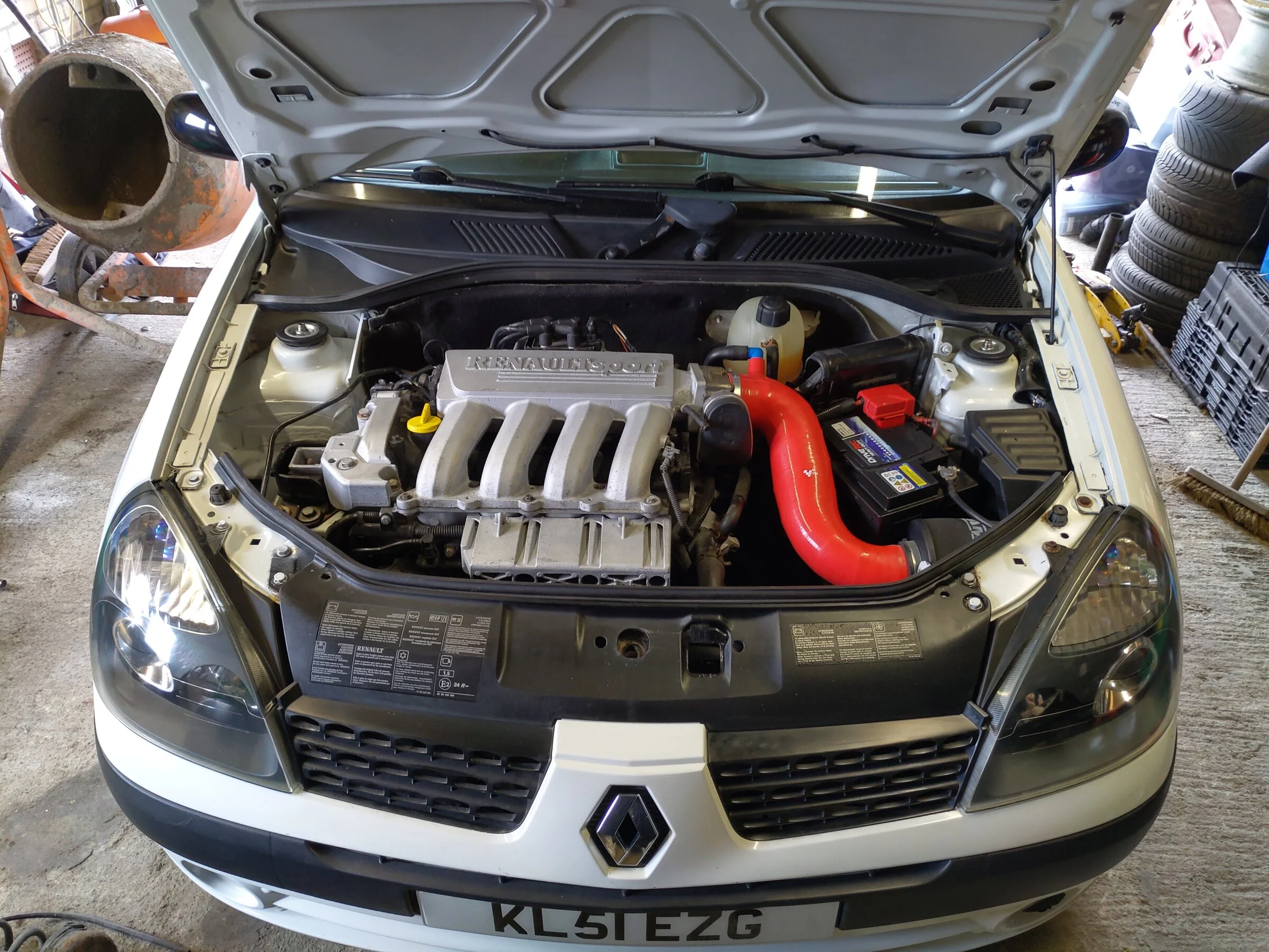

Hi Guys,
Can someone confirm the battery size on a 172 Cup? The original battery is 063, can a larger battery fit in, the previous owner gave me a larger battery however it seems very tight with the ITG induction kit, Euro car parts seem to think the 063 battery size is not correct for the car anyway? The length of the battery I have is 9 and a half inches. It fits, I haven't tried to fit the retaining bolt yet.
  172 Cup,R8, Exige S1
Is it possible to show me either on the halfords website or euros the correct battery to buy?

I've got the little 063 which was smaller than what it originally had, its the cheapest the motor factors listed too, none of the fancy yuasa stuff. Starts fine when its been sitting for a few weeks, powers the xenons fine etc AND everyone told me you need to connect a charger when bleeding the abs system as the battery will go flat but i bled about 4 litres thru it with no issues and started fine afterword's! that's good enough for me lol
  Megane RS 265
I went down to 063 as mine had a larger one and needed replacing anyway, and had no issues. Went for a Lion as well not something super expensive and it’s been fine so 063 size should be okay.
Cads
  Elise, Merc C180 Est
Cheers all, it had a 63 on and so I went for the same again. Hope this one last longer than 18 months mind you!!
