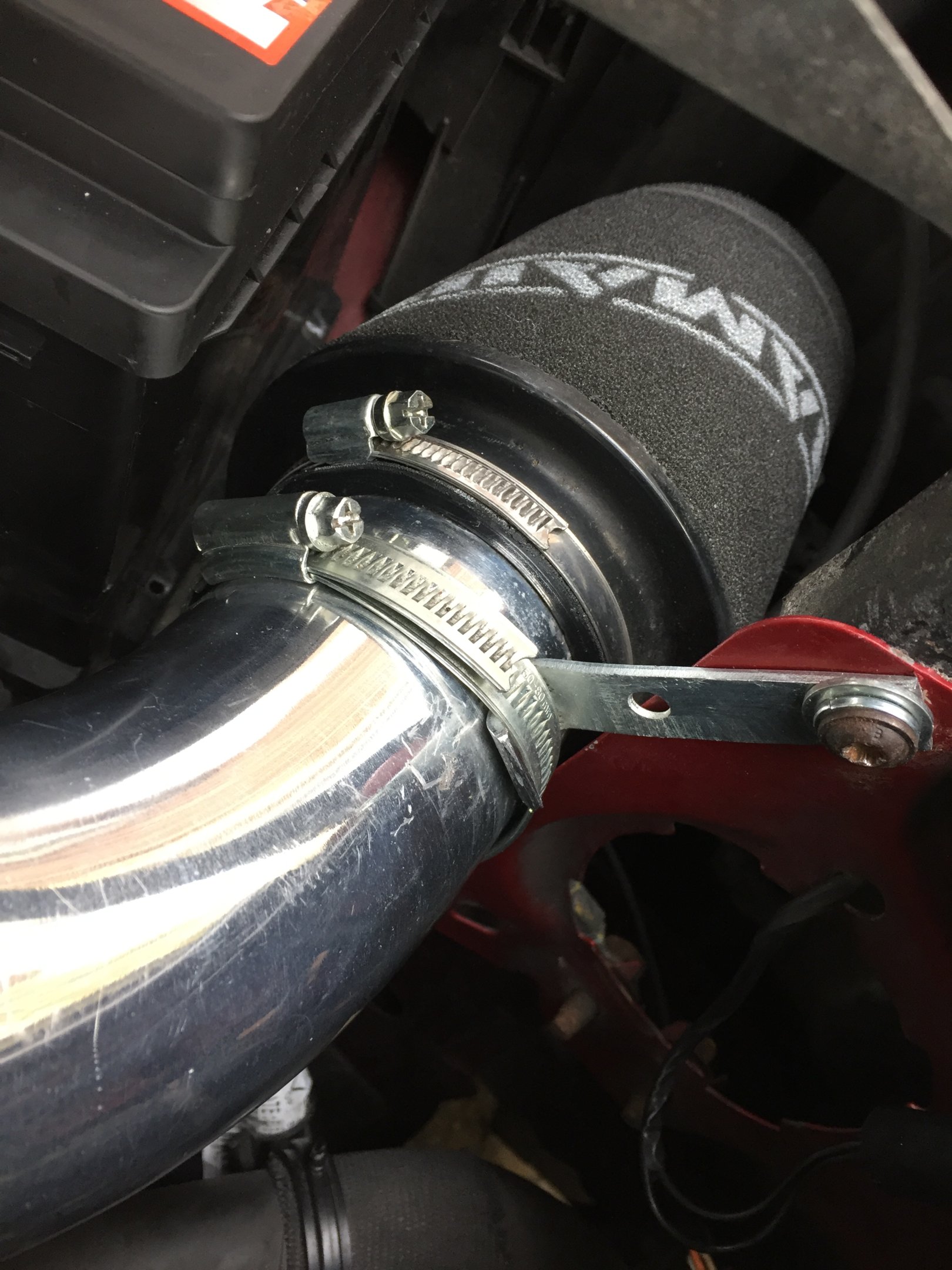

I used a “bent & cut to shape” metal bracket and another jubilee clip. I bolted it to the body as in pic....

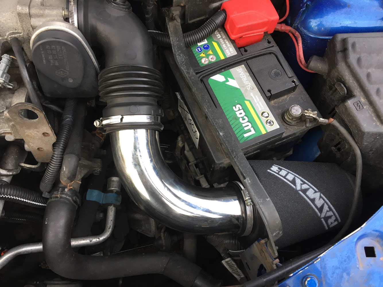

That’s strange mine was a doddle to fit, although I didn’t get a swaged end pipe so that probably helped (as well as the 063 battery in mine). All I did was slide the battery back as far as it goes, reclamp it then fit the 90 degree alloy pipe and ram air filter. I didn’t use a bracket to secure it as the Ramair sits snugly behind the passenger side headlight anyway

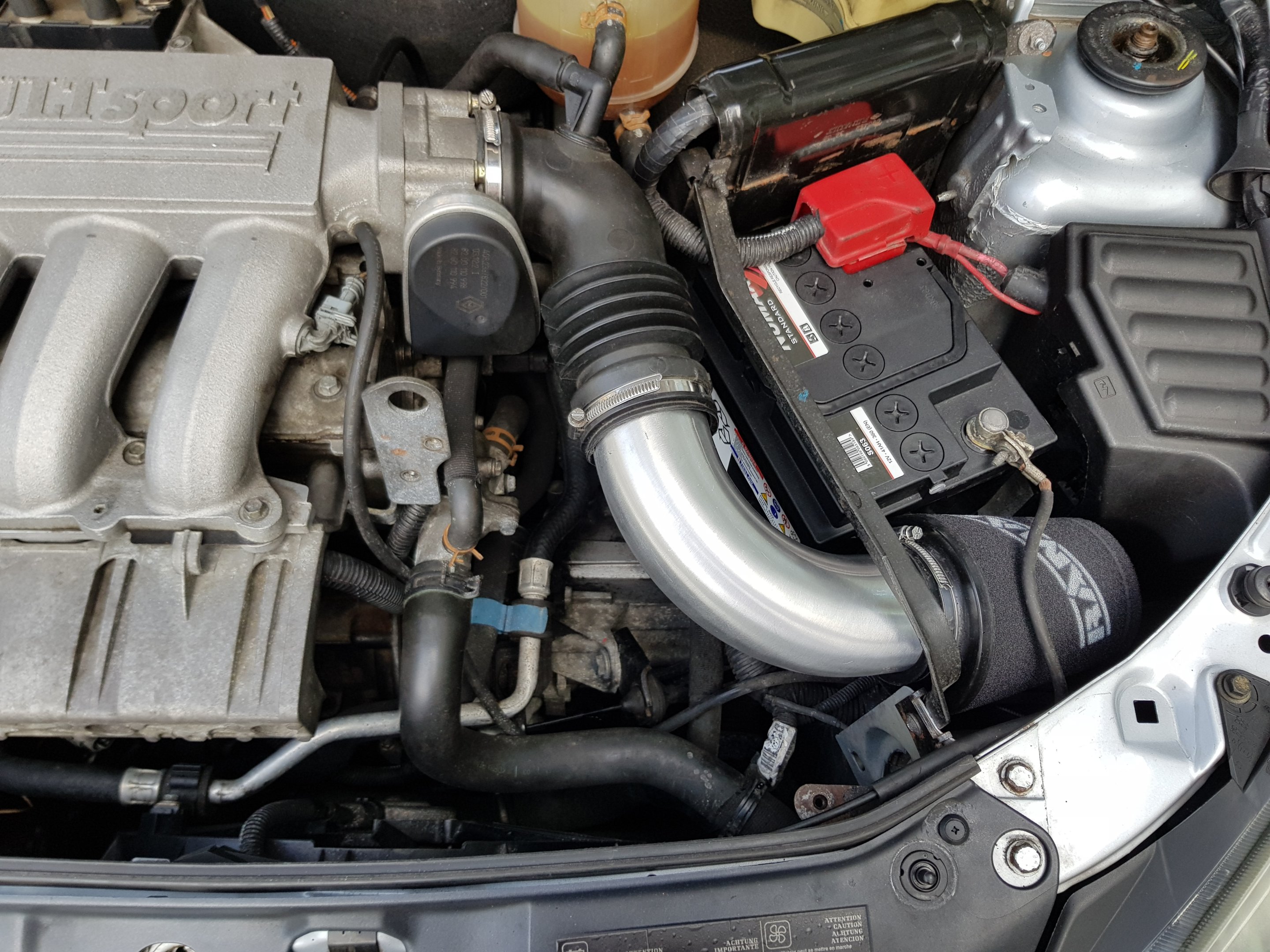

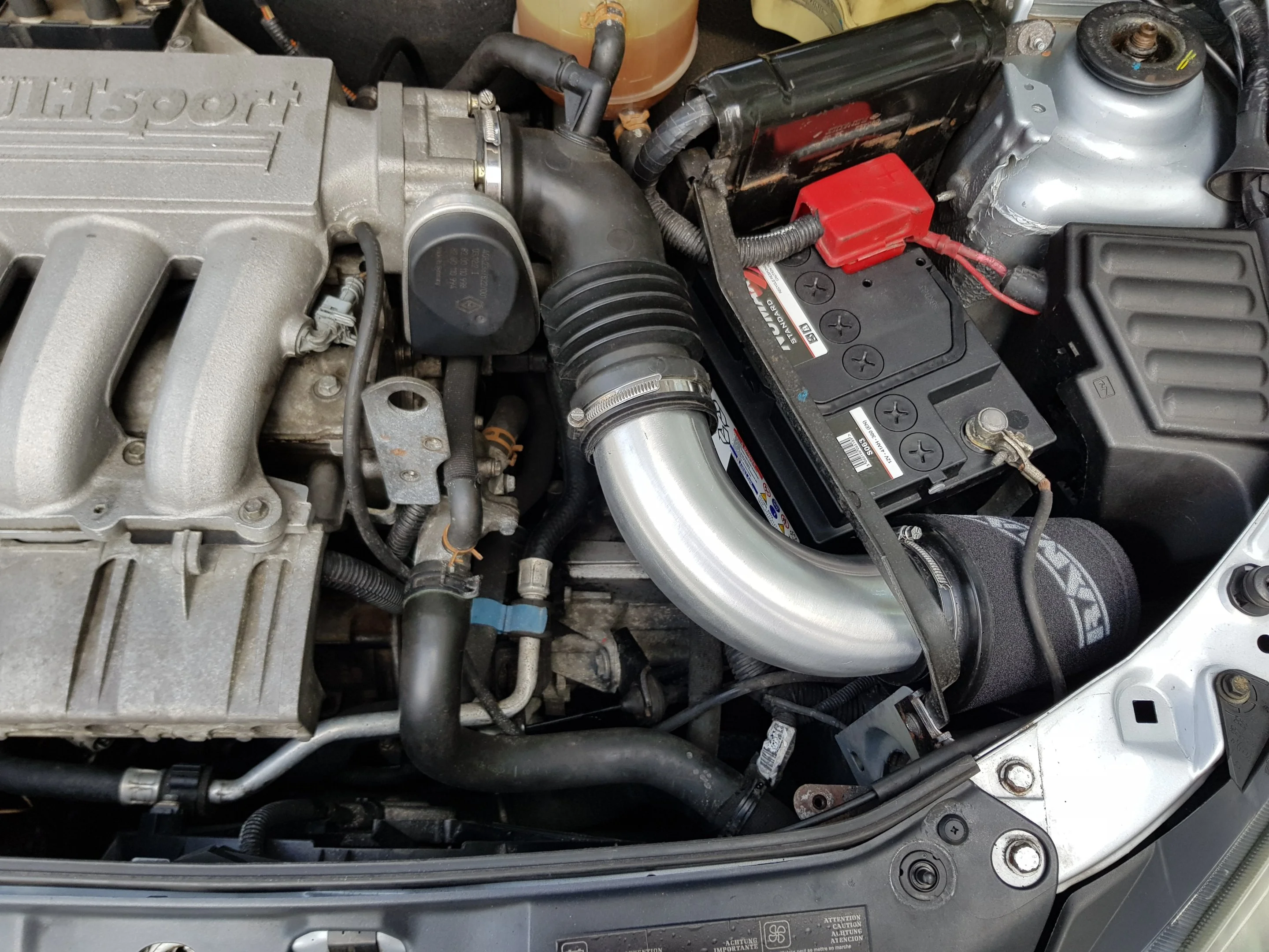

Finally got it fitted. The non swaged pipe that turned up was stainless steel so was too heavy. Ended up buying a Ramair alloy pipe, although I had to hacksaw the damn sages off the ends so pipe ended up slightly shorter than I would have liked. Looks OK though and sounds fruity ? Will probably replace with a ktec when funds allow, but overall I'm happy.
I found the same thing in the end - no bracket or cable ties required as fits nice and snug in front of battery.
