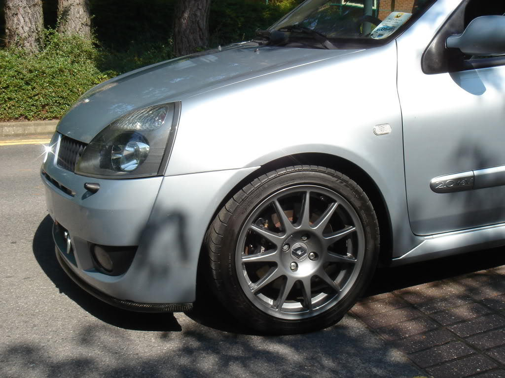

^That's the WhaleDick™
I'm talking about this one:
[imgo]http://i189.photobucket.com/albums/z284/greggjarvis/08022008_edited.jpg[/imgo]

Try Specialist Renault Breakers, www.renault-spare-parts.com, tel: 01254 386661, that's where i got mine from.
It's from a mk1 ph2 megane (1999-2002), part number 77 00 426 531, £25+vat(ish) .
