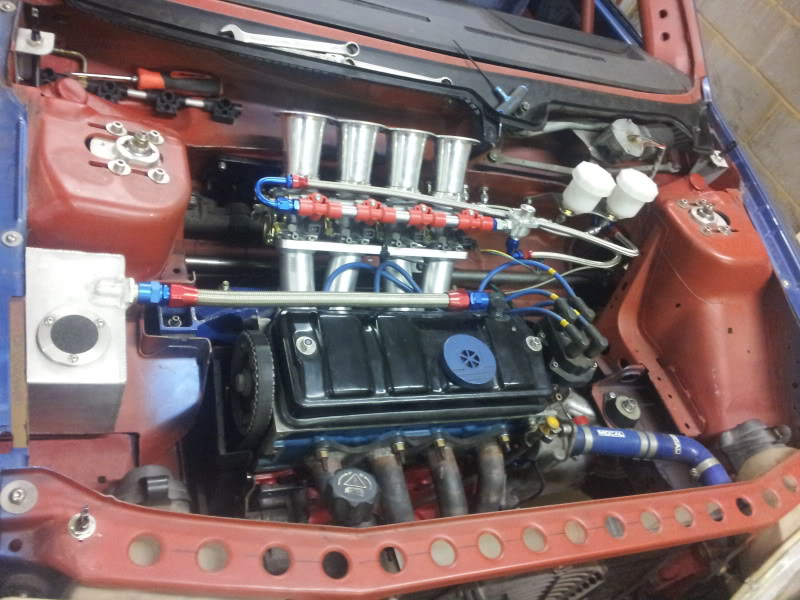

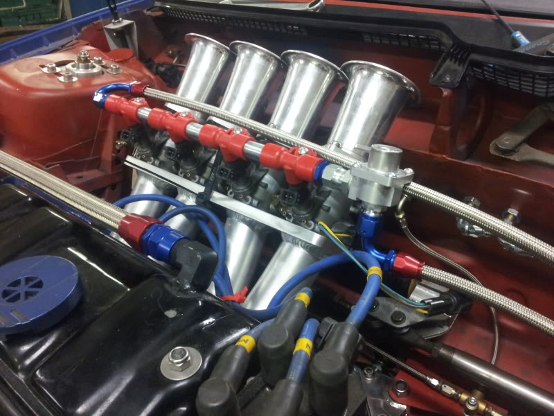

Heres my setup
if your prepared to do a bit of development there a great alternative
At least it would breathe cold air out the front!..

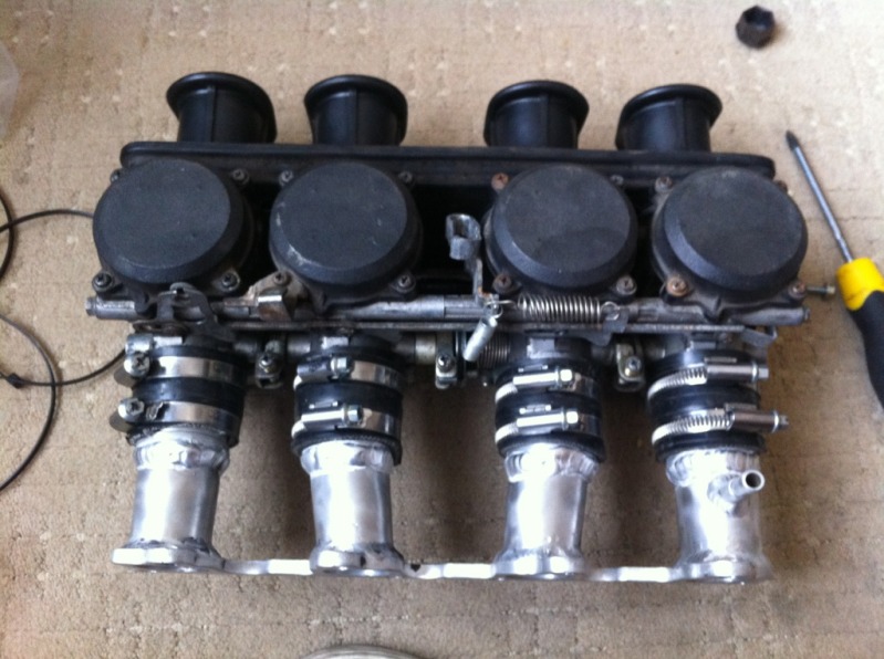

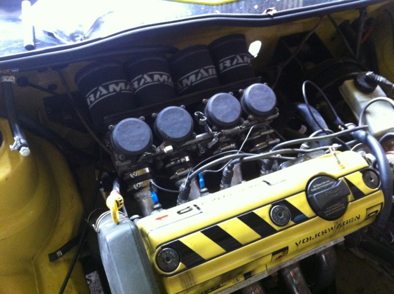

have them on my golf
Those are carbs not bodies though?
Manifold doesnt look idea if after power either TBH, that much angle change abruptly right next to the port isnt really ideal.
Looks nice in the bay though and I bet it sounds great too, which probably matter more to you on that particular application :)

the manifold is w**k, but its not as w**k as it was oriinally.
there is a video link in the 1st bit but i dont know why its not come up. Sounds amazing, shame i want to rip it all out again
