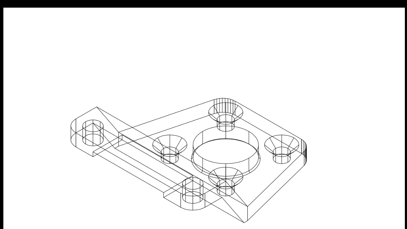

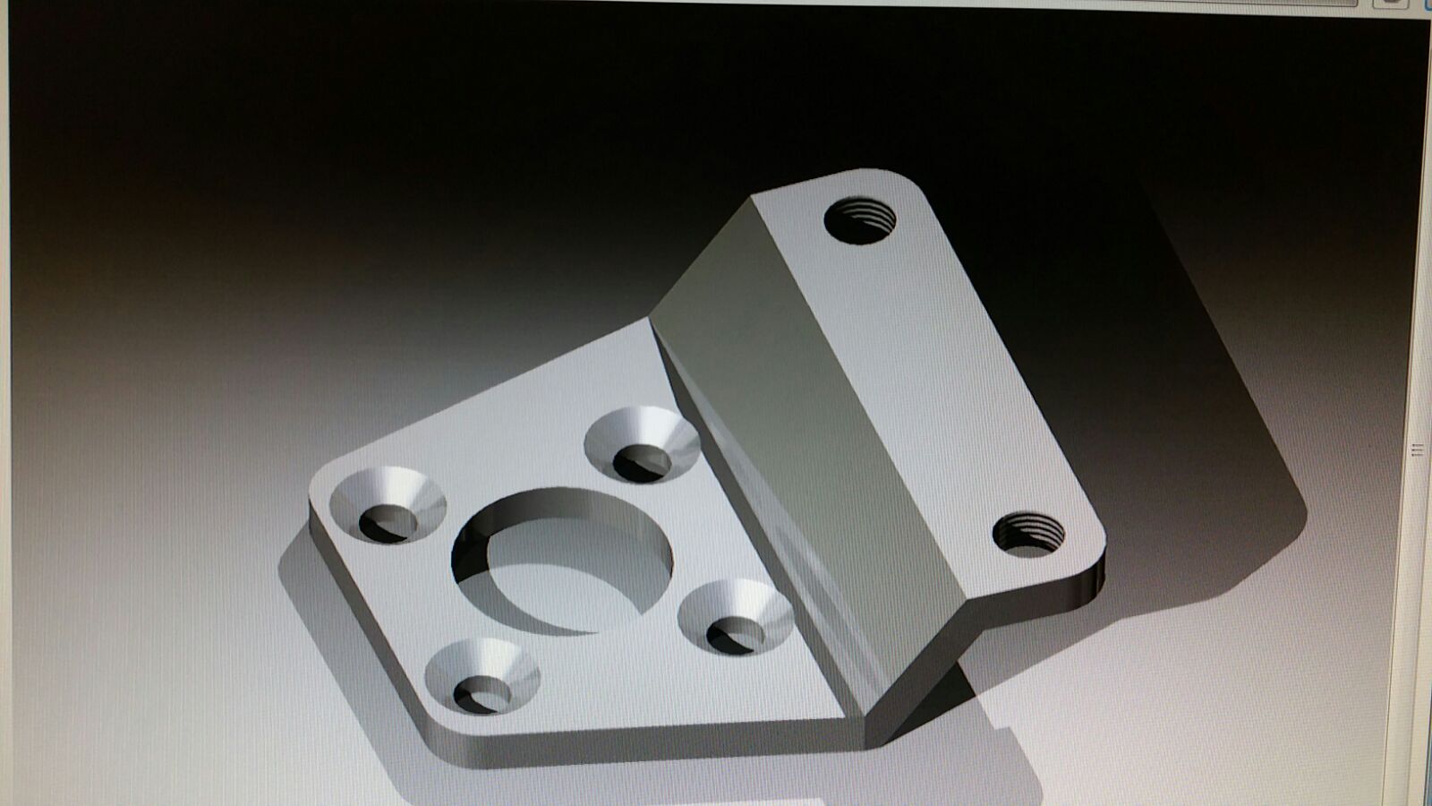

I have however got a few exciting things in the pipeline!! Want some brembo brackets? Well I've finalised a setup that will allow me to run either a 280mm disc or 300mm disc (I'll be running 295's as I've machined my calipers) without the need to faff with having 2 different brackets! :cool:
Also I have this in the pipeline!!

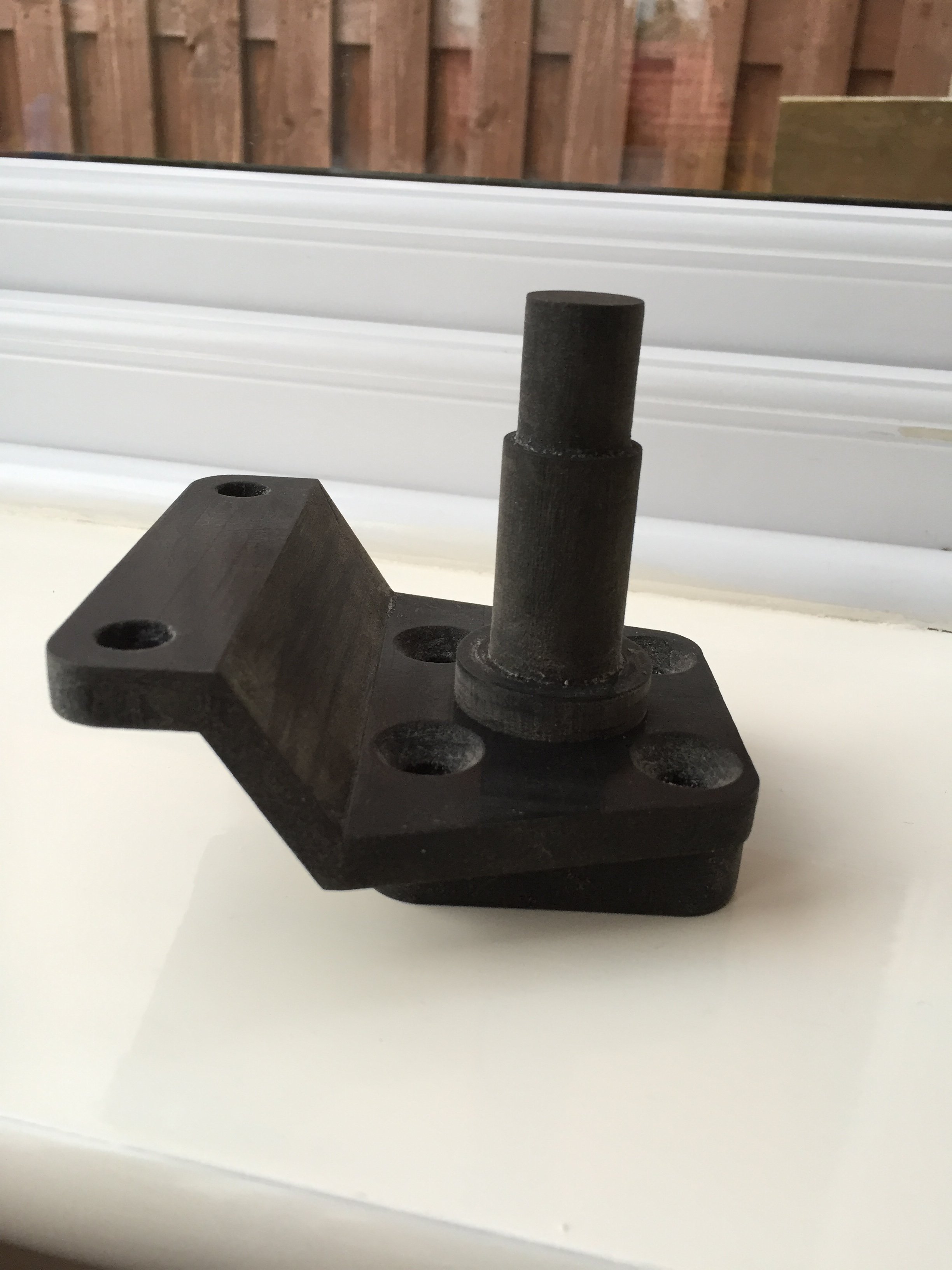

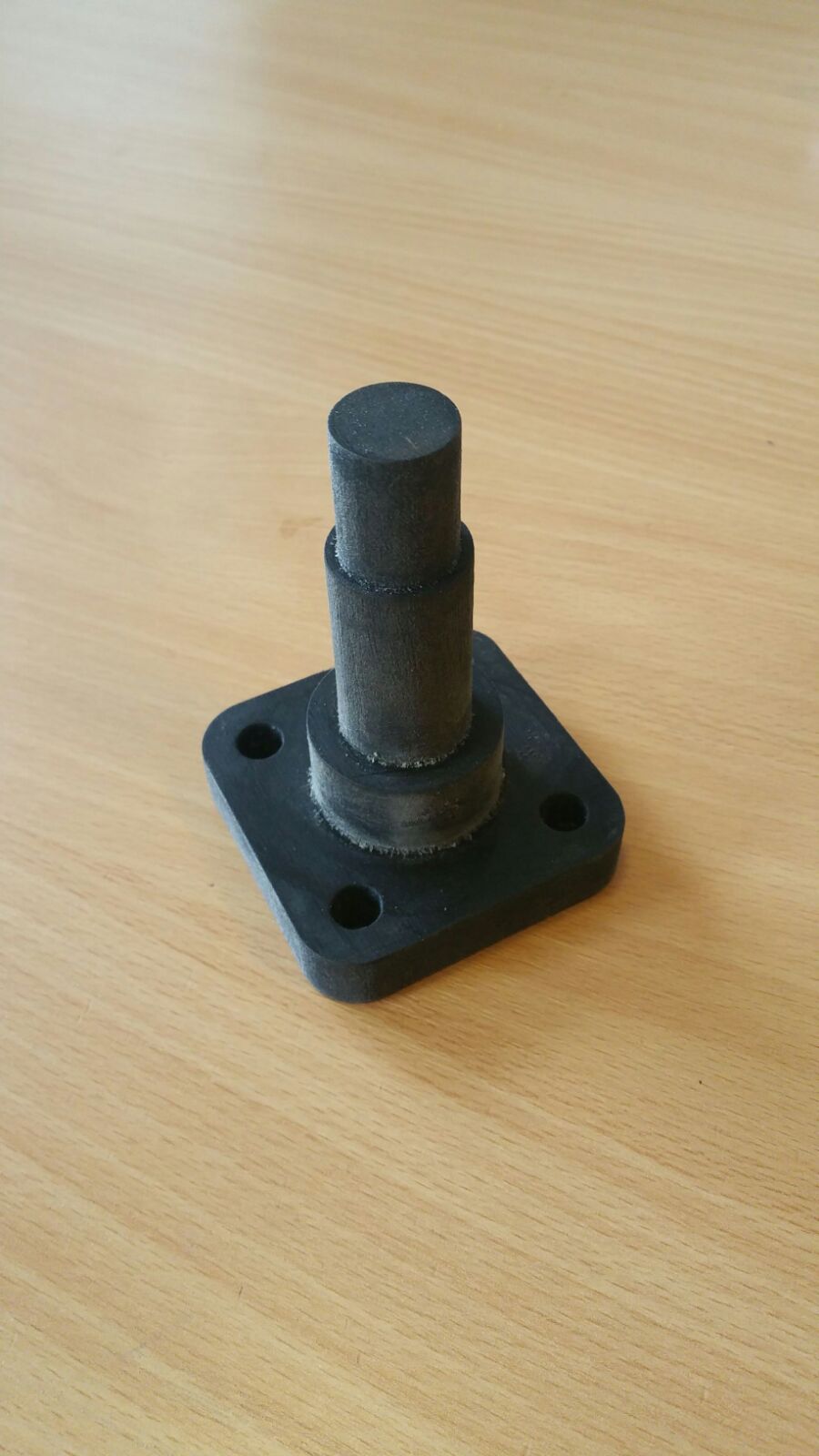

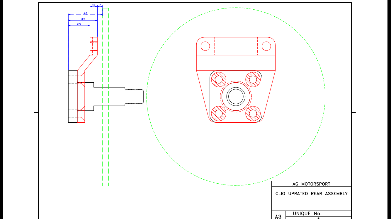

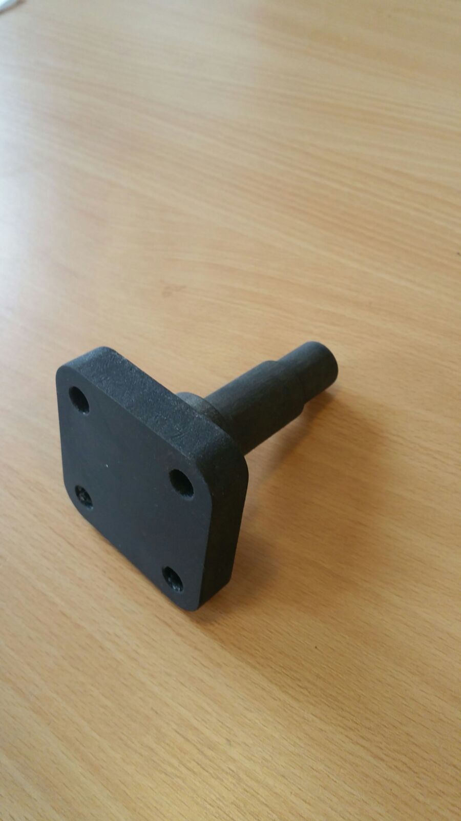

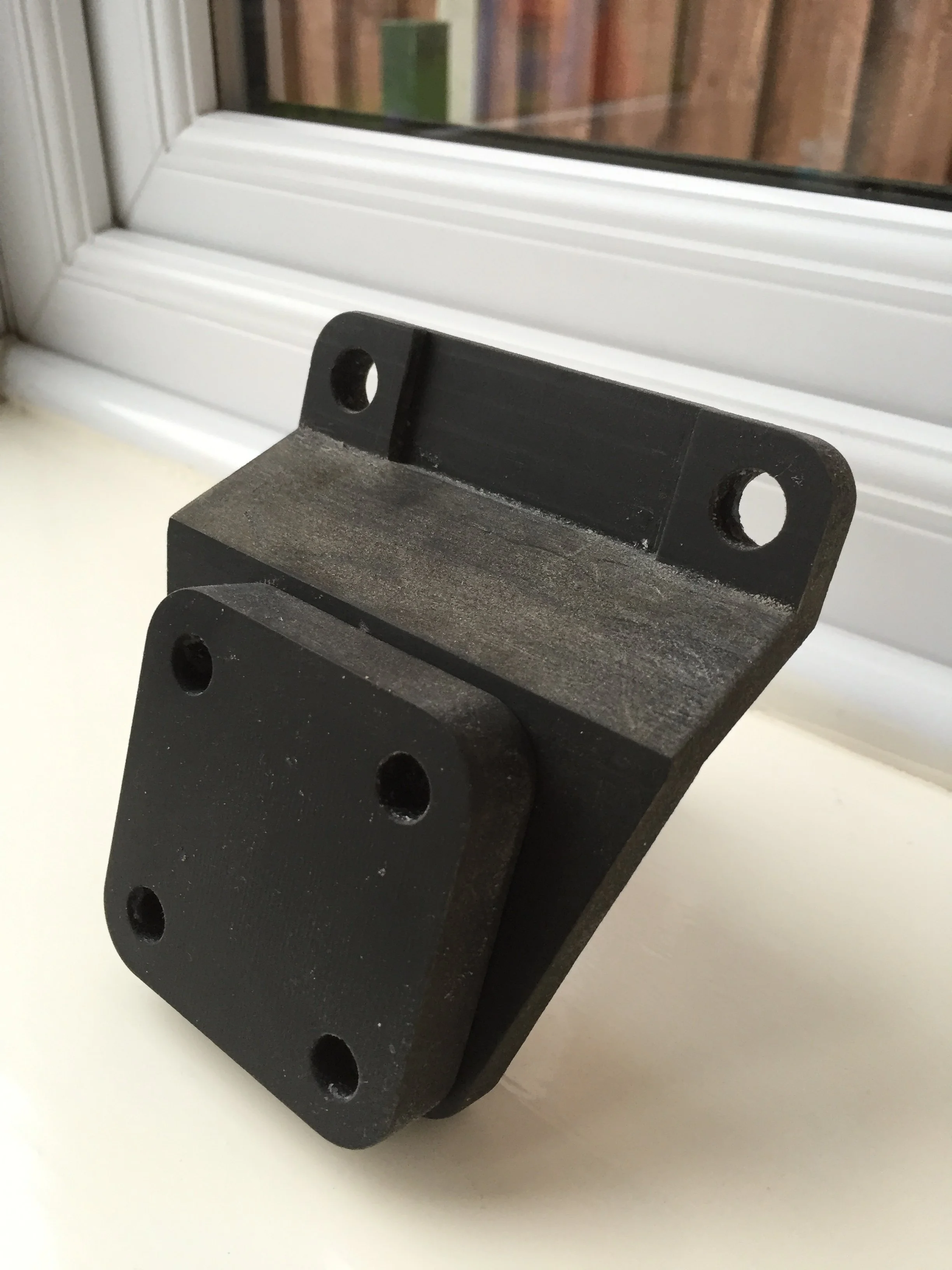

This is a 3D printed stub axle that myself and @nath&alex have been working on. The idea behind it is that they will allow you to run a larger rear wheel bearing but still allow you to retain the original rear caliper assembly. More reliability is the major benefit of this little enhancement! Currently only suitable for non abs cars, but I'm pretty confident that we can adapt it to suit the abs equipped cars. :wink:
All that's left to do is try the 3D printed stub axle on the car to see if there's any issues to iron out, then providing there's no issues, they will go into the machine shop to be manufactured.

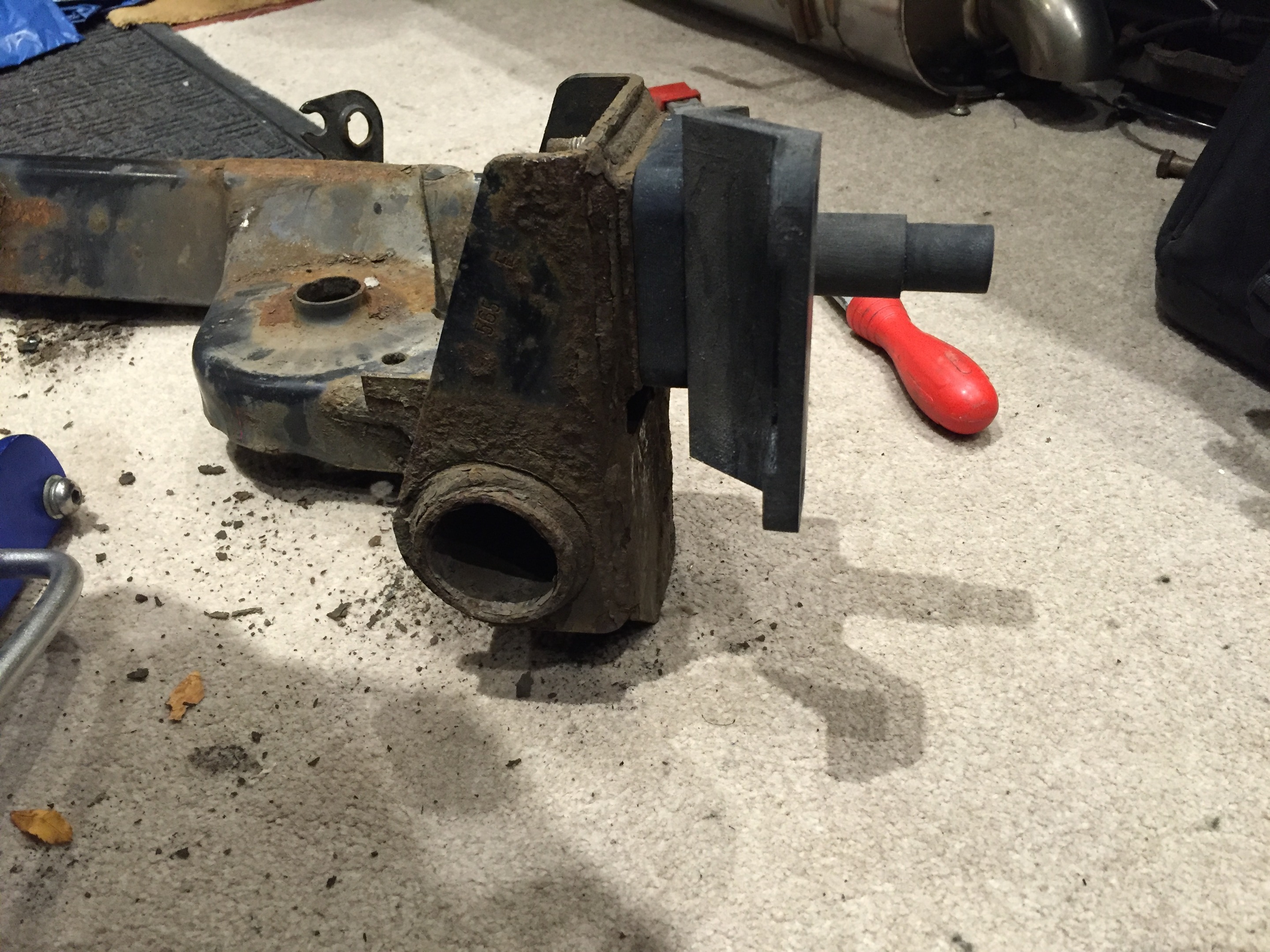

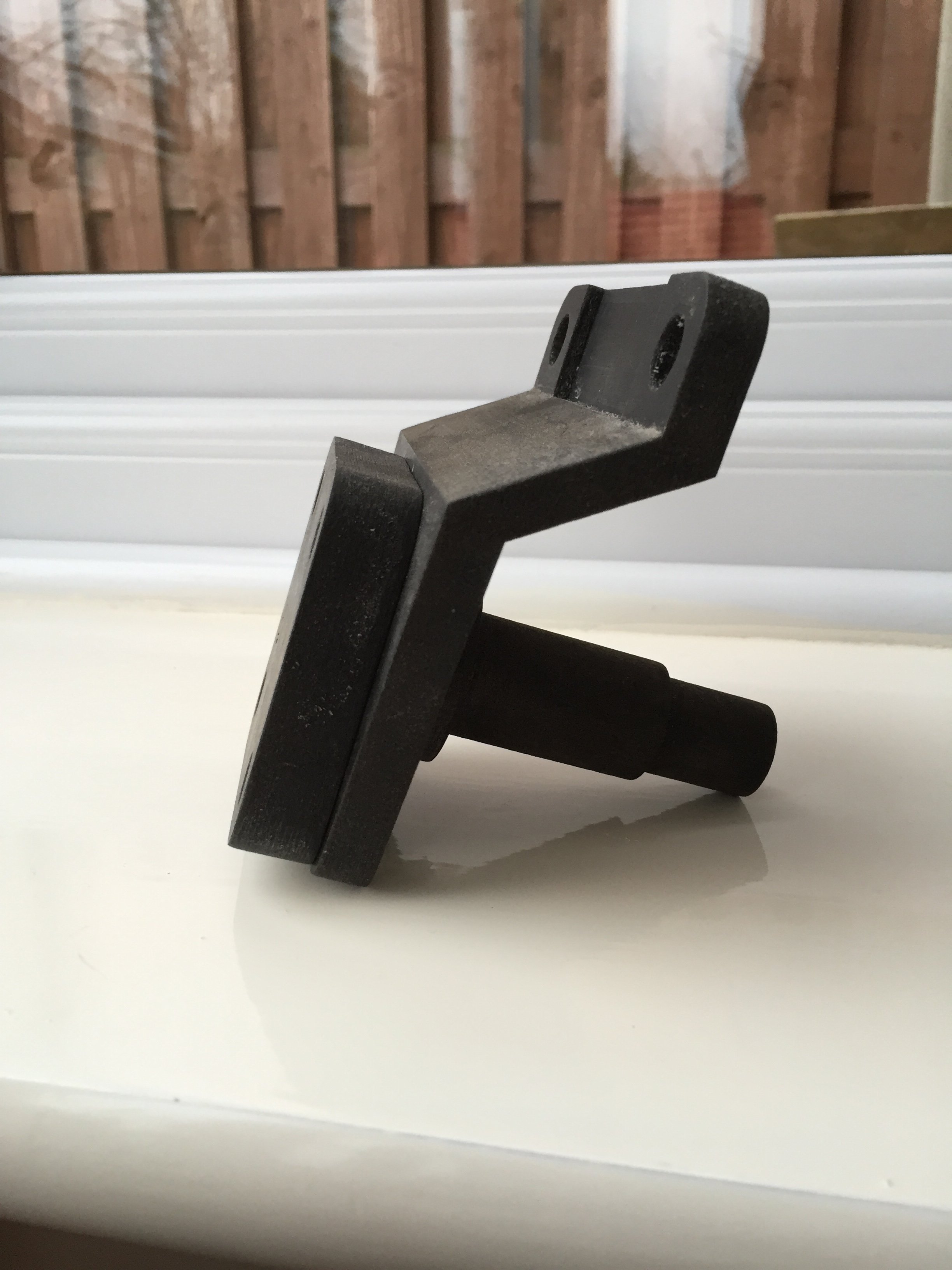

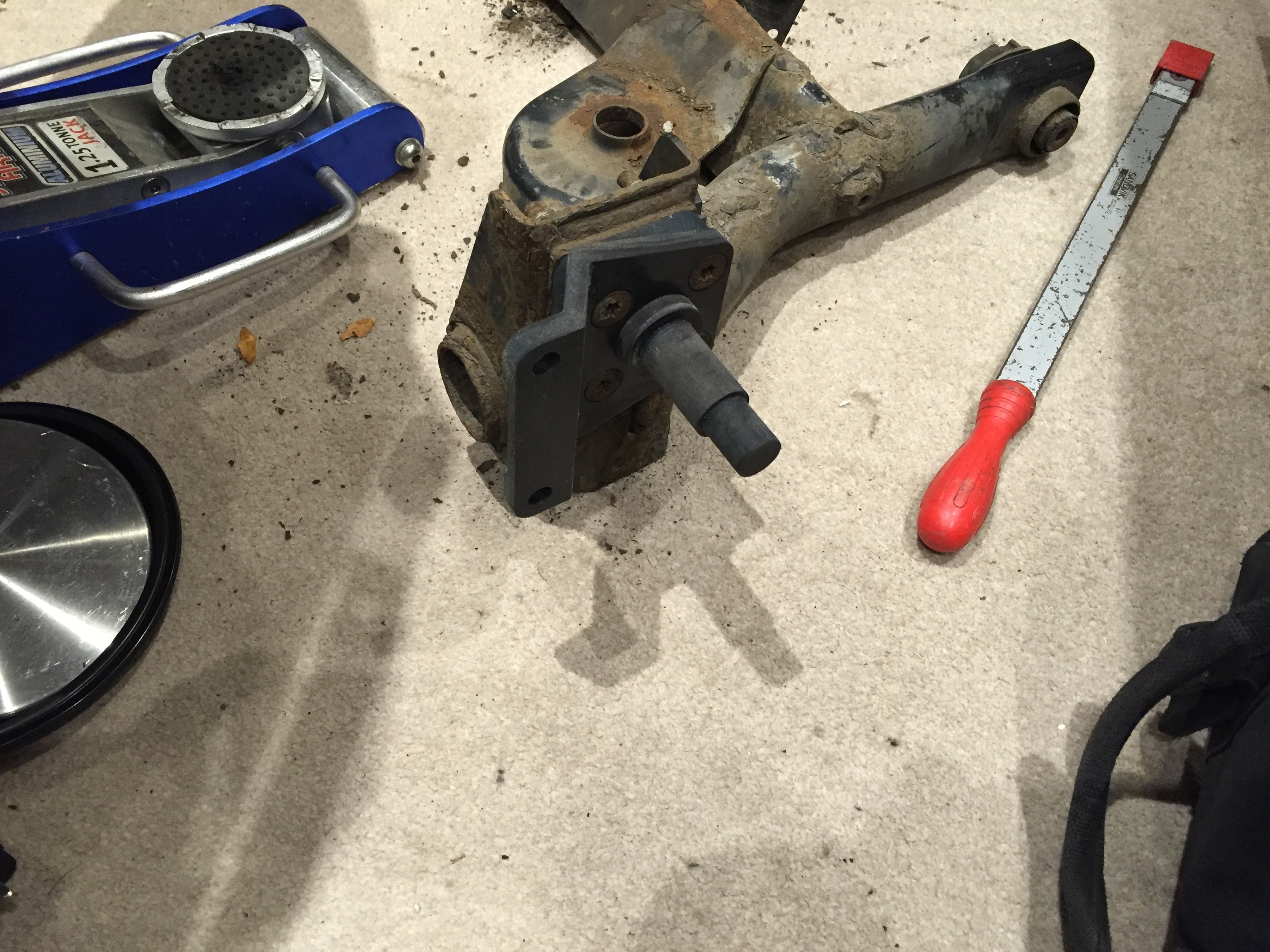

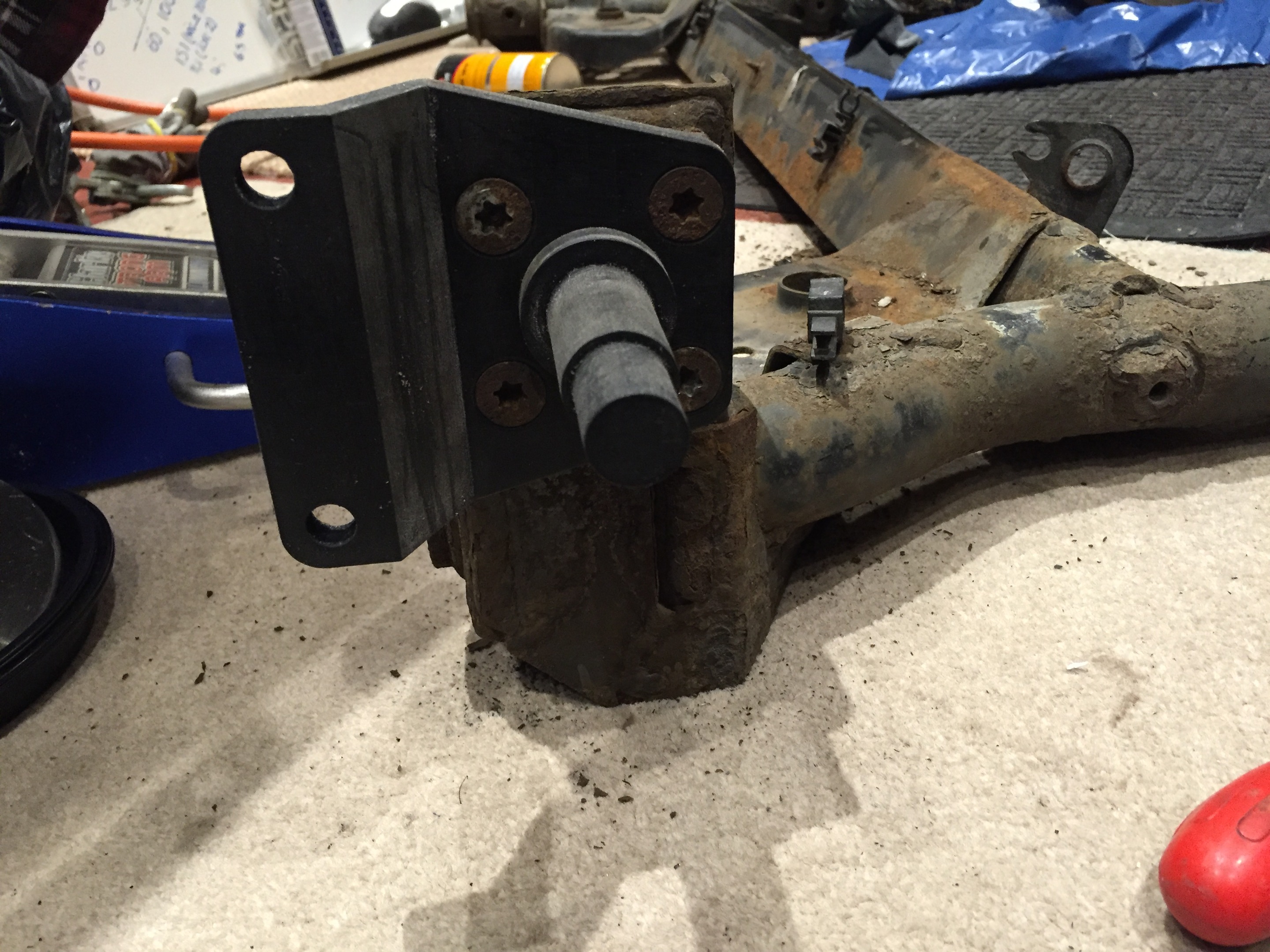

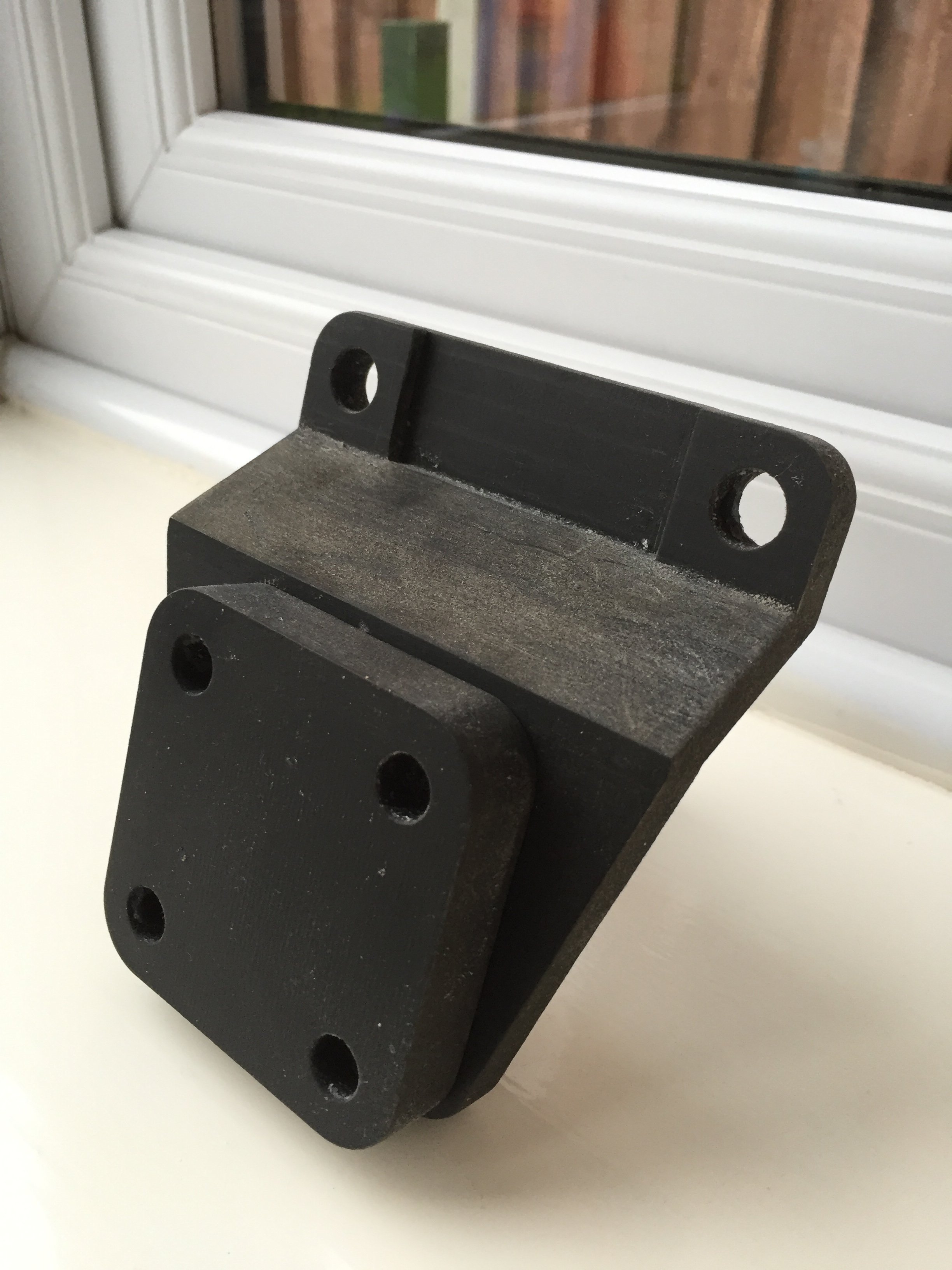

For those who are interested a few more pictures of the 3D printed mock up of the rear setup @NorthloopCup and I have been working on
Fits nicely on the spare rear beam I have. Just need to spend some time with Mark now to double/triple check everything now we have the extremely accurate 3D printed mock up. Then we can get a couple of sets manufactured and try them. As Mark said, the aim of this little adventure is reliability :up:

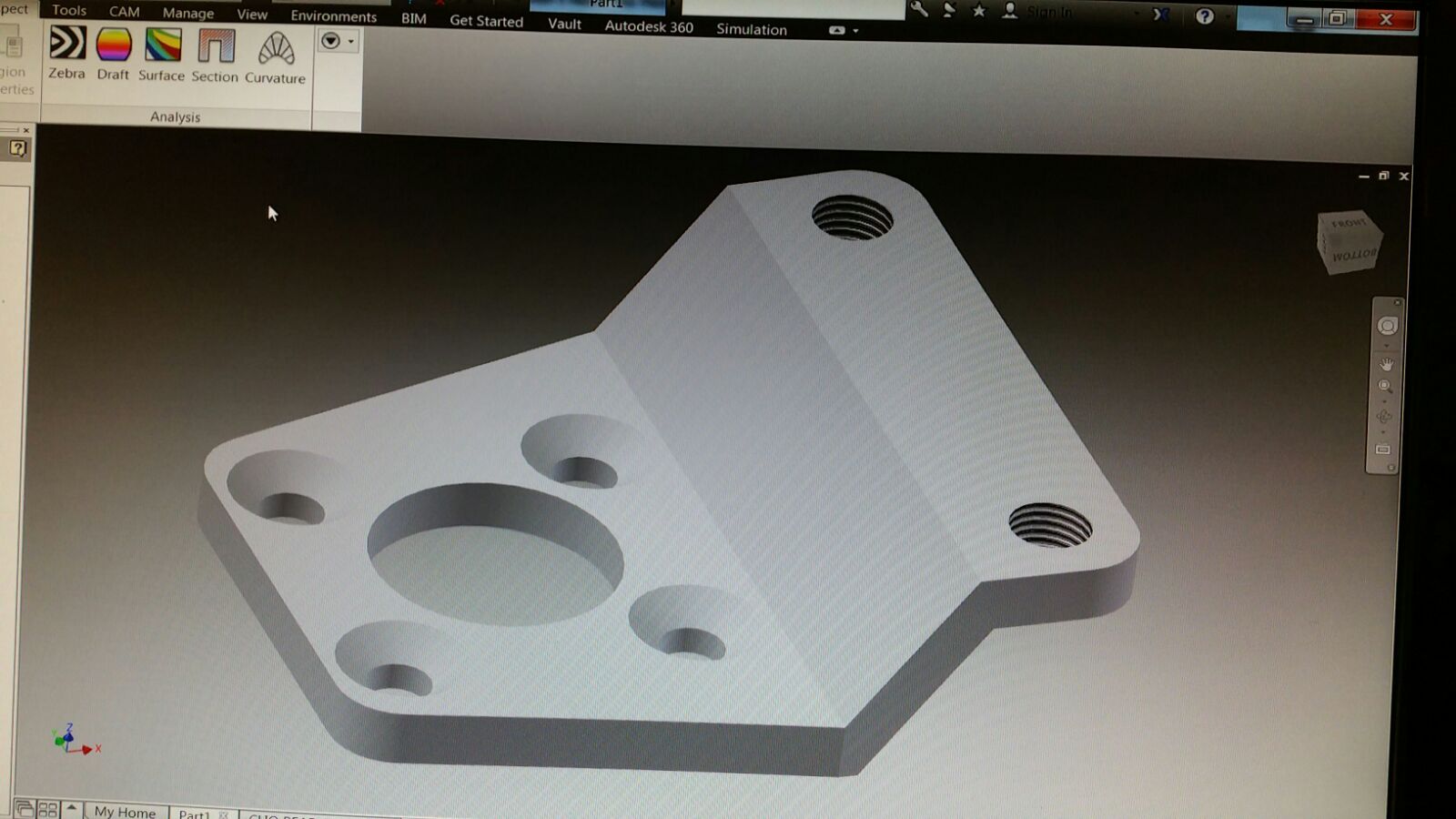

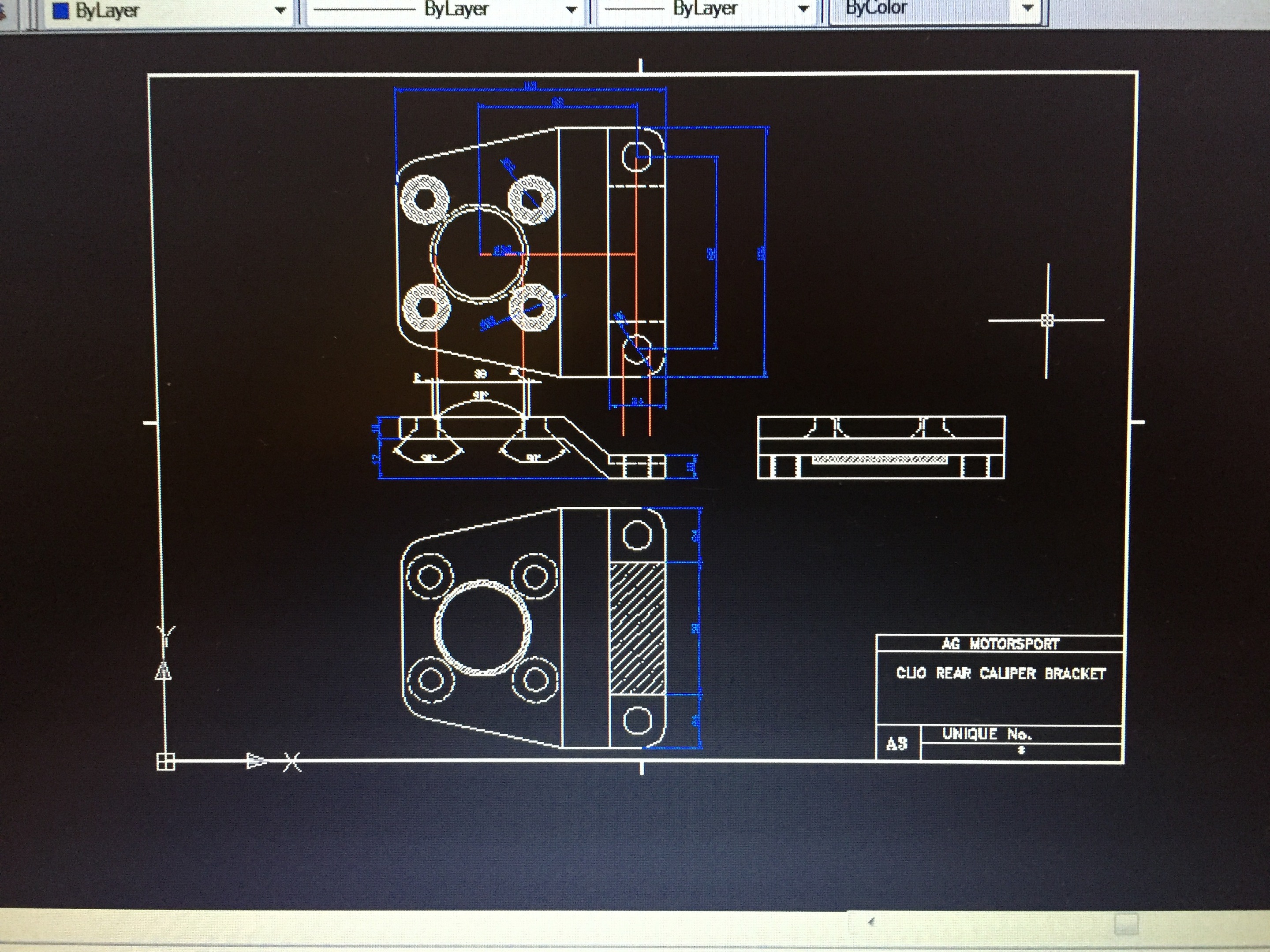

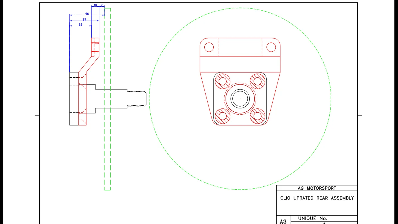

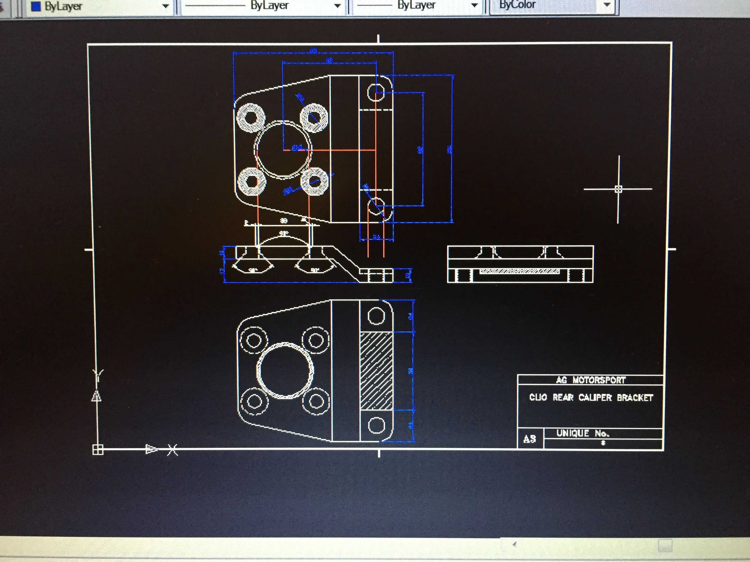

@NorthloopCup and I have spent a lot of time measuring and working out a solution. This was using the 182 rear setup, a Twingo rear setup and some engineering drawings of both rear discs. I spent a lot of time drawing things up on CAD, looking at ensuring the rear wheel stayed in the same position, making sure there was the correct clearance between the caliper mounting bracket and the disc. Ensuring it was the best possible solution we could engineer for what we needed. With hope that we could manufacturer it for less than the price quoted above. The final step we have undertaken to ensure the solution is accurate and will work before we start manufacture is a full size 3D printed mock up. As Mark says this solution could be made to work with ABS, but for people who don't have it or don't want to run it this is the perfect solution.
When I get chance I will post up my CAD drawings showing our design and hopefully it will show how much effort we have put in.
