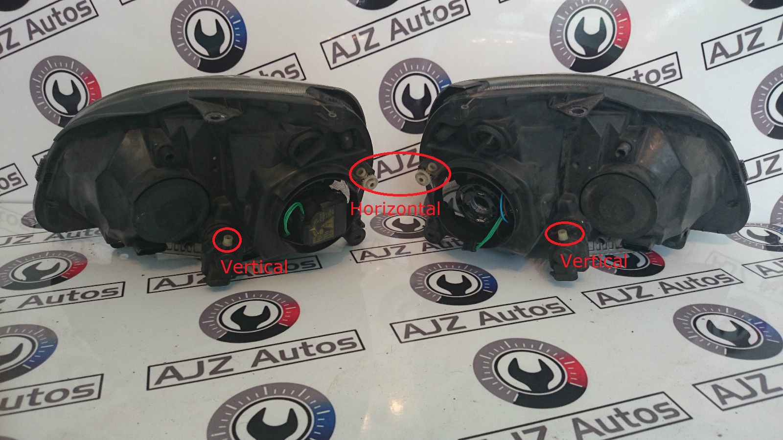

Have you made sure the lamp isn't projecting upwards rather than just have the dial halfway? If you look at the back of the unit there should be a socket you can stick a 6mm allen key in, turning that adjusts the beam.
Get to a wall, turn lights on, adjust them so they're level. You may find they're pointing up at the sky.

The headlights have motors in them. Both the Xenon and standard units have these motors. In the photo above you can see the motor unit with the vertical adjustment on it. Looking at it now it looks very similar to the standard servo so it wouldn't surprise me if the standard and xenon units both use the same servos. Even if they don't, the servos are interchangable apparently.
For cars that have xenons as standard, the motors are fed a signal from a self levelling system.
For cars that have the standard units, the motors are fed a signal from a rotary switch inside the car.
If you put the xenon headlights in a standard car, they will be controlled by the same rotary switch that normally controls the standard lights. Vice versa will apply too, if you wanted to take your xenons out of your 1*2 and replace them with the standard units then they will still self level.
