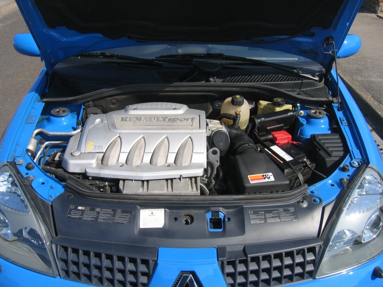

Car won't lock ?
All doors shut, I have been under thre bonnet. Could I have knocked something ?
Even when I lock the doors manually, the long beep comes on after about 2 mins ?
DaveDreads
Yep, it's the nipple thing sticking up on the right of the grill plate, just next to the sticker,
you might want to check it's wires and make sure it's still plugged in.
You could also hold it down and lock your car to see if it still works.
My nipple thing isn't sticking out the top of the grill, it's hanging down. When I eventually found it.
But hey presto, pressed it and car locked.
Thanks everyone, just got to figure how to get it threaded round. But got some new headlights coming this week so might do a duck tape jobby then wait until lights arrive.
