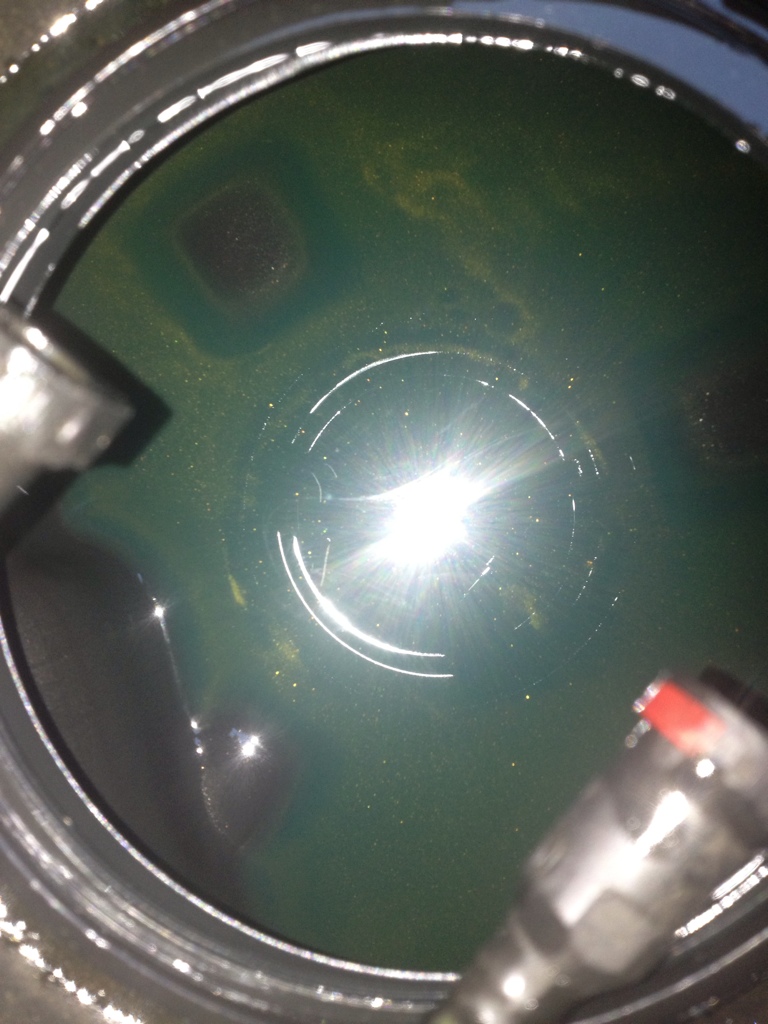

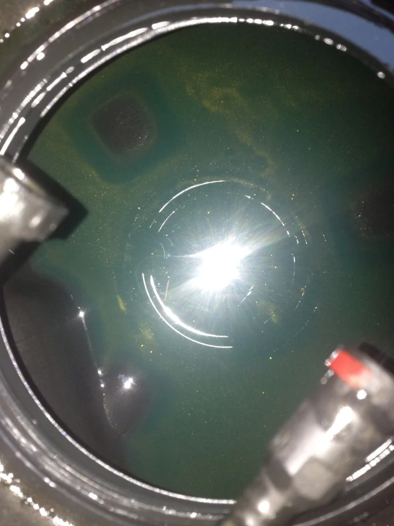

When you took the fuel pickup/sender out, did you notice any shiney bits in the bottom of the tank? Most likely something like this...

I filled up with diesel just before it got really bad, so the tank was near enough full when I took out the sender unit (yes it did get quite messy!) so I couldn't see anywhere near the bottom. There were 2 specs of silver in the mesh filter on the bottom of that. Thanks very much for the offer of a plug in but unfortunately I'm a bit far from you - in Warwickshire.
