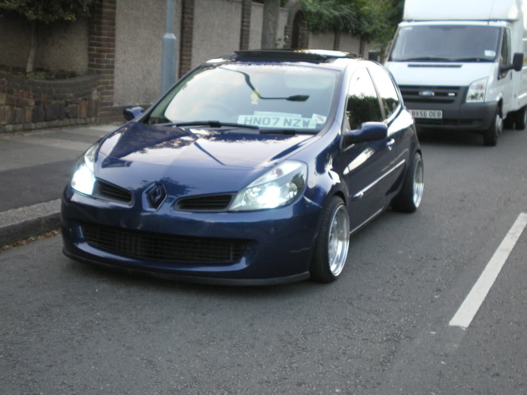

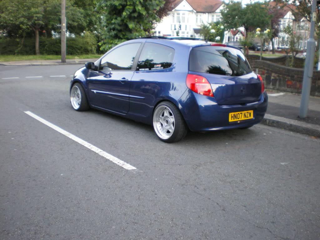

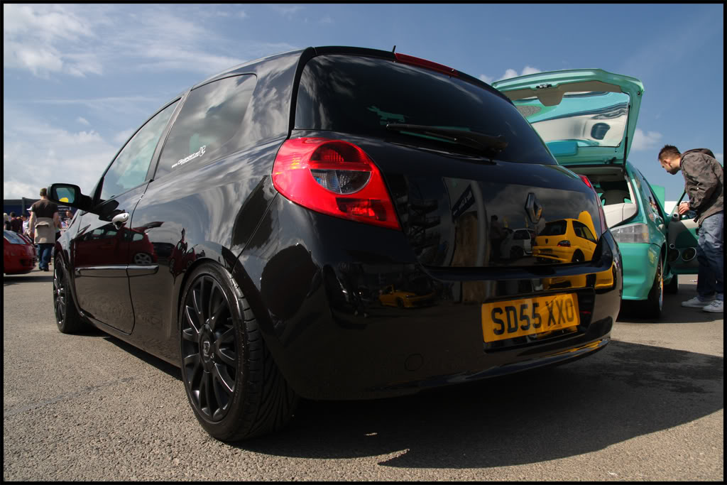

Sapcers aint gonna do nething to your paint ! your arches are wide enough to take it trust me i ran min in all weather with them and no issues !
this is what you want ! My old Bus 25mm Spacers all round 70mm front 150mm Rear on Weitec coilovers with custom rear springs

Custom springs that go lower than the standard weitec coilover springs iirc!
  White Sti Hatch
Fully Adjustable Coilovers mate wound ALL the way down front and rear with Custom 150mm sprigns on the rear
And as for why so low, cause it looked the f**king dogs lol.....apologies for taking over the thread with my old car

there the standard 16" canastas off the Mk3 just poweder coated black

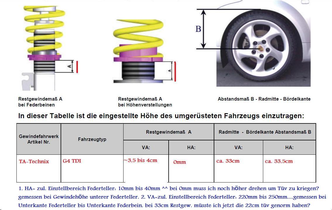

well, what i interessted in. Measurement from fender/wing ( Kotflügel ) lower edge to the middle of wheel ( Radmitte ) in mm.
Found by. Golfv.de
Measurepoint B !!!
I have front 315mm and rear 320mm.
I interessted in measurement with weitech coilover

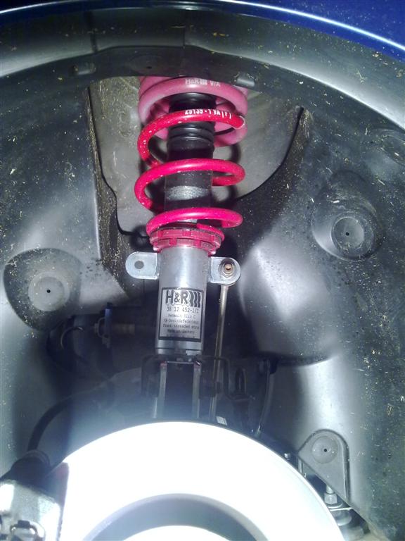

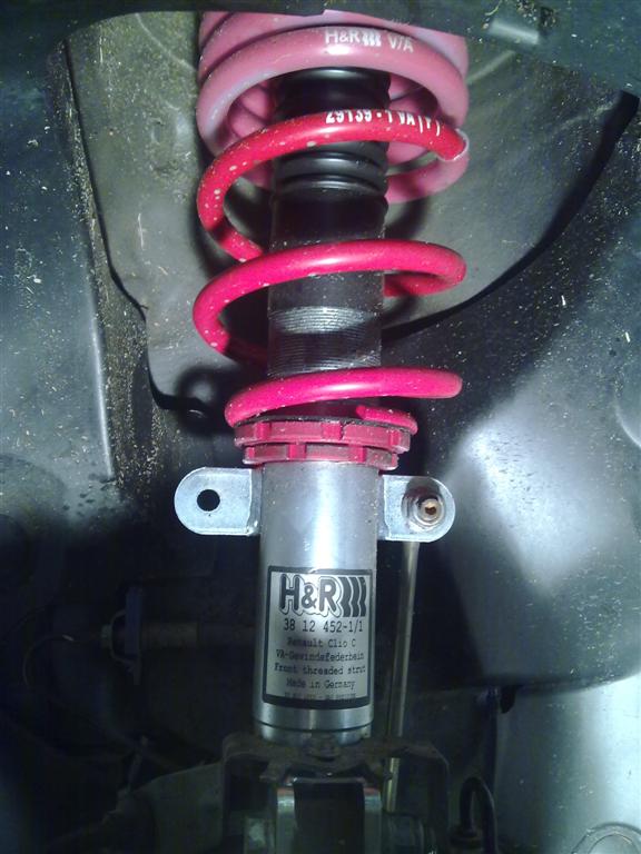

Hello Community, now some Pics, only handy pics from new Wheels. 8,5x18 ET30 @ front and ET15 @rear axle

your car looks superb mate, ive got -45mm h&r springs and four 25mm spacers waiting for me when i get back to work in a week!!!
pics to follow :)
  Clio MK3 GT
nice ... i'm very intressted @ these words "I think you can go more low with gaz coilovers"
Facts, Links .... are very good ;)
  Clio 182 BG
HR coilovers are quality, GAZ are good too but its hard to find a dealer who have the right papers for our TÜV (something like MOT but harder)
i think for him the HR´s are the best way, but you can phone HR for custom springs normaly they can produce some for your car.
