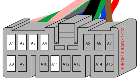

I've just had a bit of a nightmare fitting a Connects2 stalk control to my Clio so I thought i'd pop a little post up for people who might struggle in future....
The Connects2 patch for Kenwood comes with a brown wire... So you would assume this needs to go to the brown wire on the Kenwood harness? ... WRONG! This brown wire needs to go to the blue/yellow wire from the back of the Kenwood harness! My harness didn't have one of these so i've done a little research which will hopefully help someone out!
The blue/yellow wire should be in slot A4. Slots A3-4 are both blank on aftermarket harnesses so you need to pull out the brown wire from A2 and slot this back in to the A4 slot! Turn the stereo on and your stalk control should now work! I hope this helps at least one person as I couldn't find anything helpful when searching.
