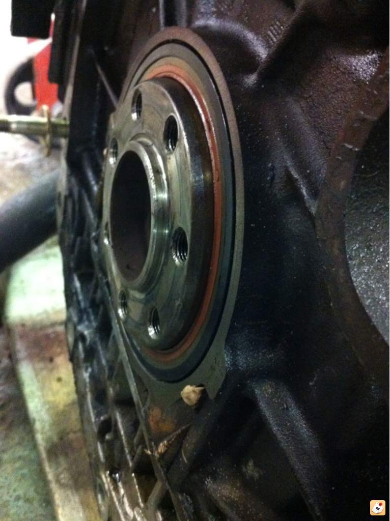

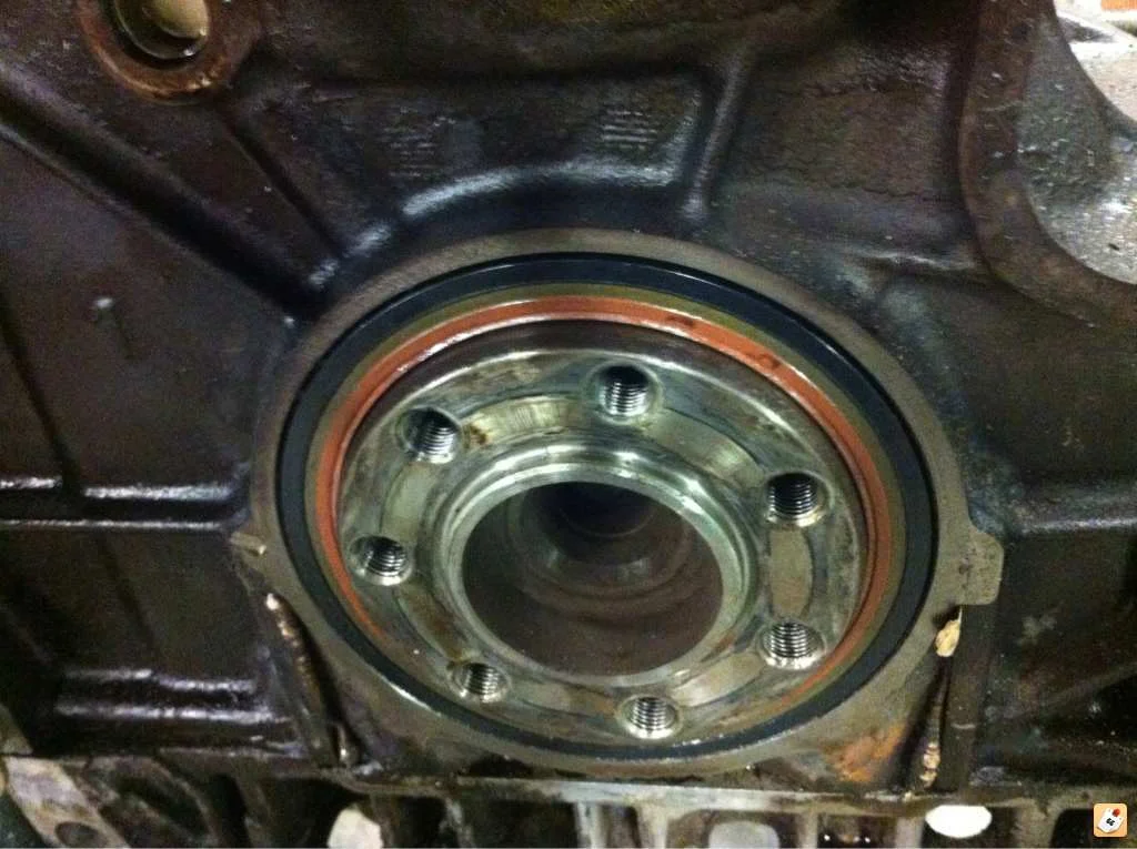

Just fitted a crank seal to a motor last night and think I may have pushed it to far in, will it still seal properly when it's level with the surface of the carrier?

Anyone? motor needs to go back in tomorrow so could do with some advice on whether to change the seal again or not. Cheers.

Look in icemans thread for his 182. He pissed around for ages trying to get his to stop leaking from the rear main crank seal and there's a fair few pictures on there of how it should be fitted. Hope that helps.

Good stuff thanks guys, the one i took out was sitting about 3mm proud so just thought id double check.

It was definitely leaking from the seal it was obvious as the only rear wet area was directly under the crank leading from the seal. Im still not convinced about this seal though, ive done some measuring and the seal is going to be pretty close to the back of the sealing surface from what i can see. Its on a friends car so i dont want him to put it all back together and find it leaks again.
