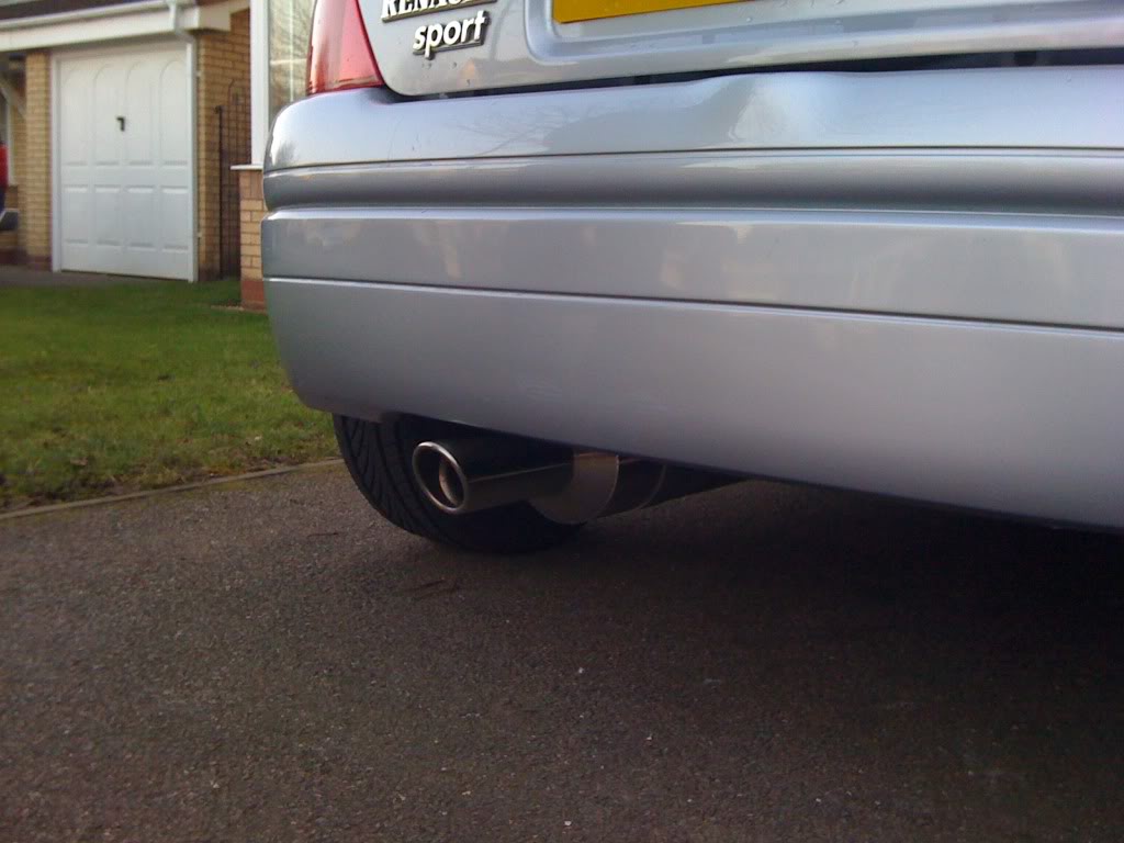

So fitting a Ph2 Yozza to my Ph1 it will probably sit flush with the bumper rather than a bit of poke out?
  Evo 6, E92 320d
I have an exhaust from a cup on my ph1 so the tailpipe sits in a bit, so i'm on the lookout for a ph2 decat to bring the tailpipe out an inch.
  clio mk2 ph1 172
yozza supersport, sits perfect:)
  340i
It will just about sit out of the bumper yeah Danny...
Although mine does poke out a little more, it has a longer tail pipe welded on.. Which was done by JP exhaust's :)
