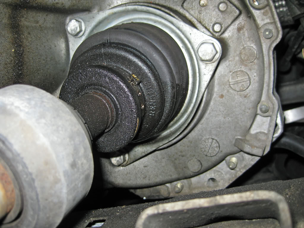

I suspect the vibration may be a byproduct of the J&R not having the rubber balancer on the shaft.
Its a large lump off lead with a rubber inner sleeve to hold it in place.

Is it possible to transfer the old rubber balancer to the new shaft, or does each shaft need a specific weight and/or positioned balancer?
Good question, and well worth a try.
I think it`s purpose may be gyroscopic, not a specific balance.
If you can slice it and refit in the same position on the shaft with a dab of super glue, or even a couple of cable ties at 180 degrees to each other to maintain some semblance of balance.
