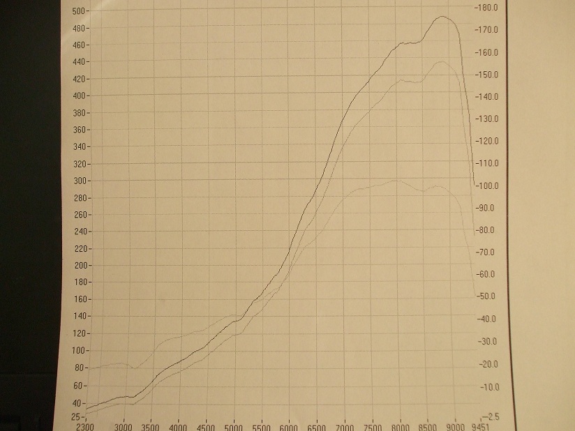

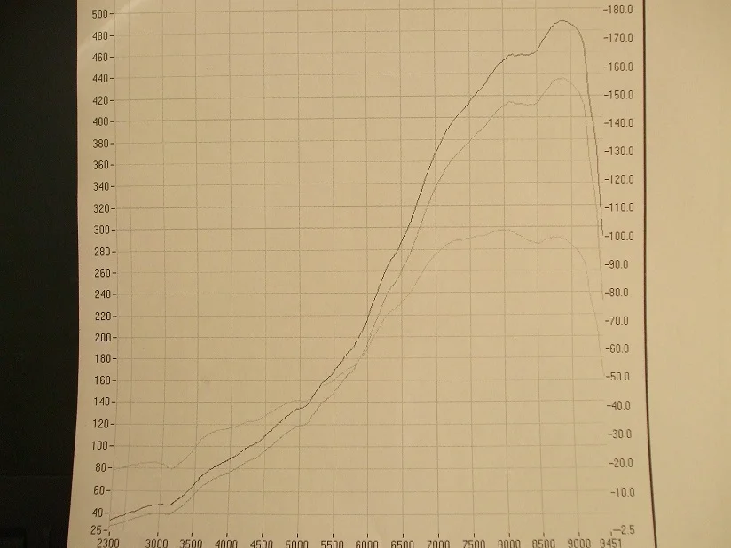

heres 1 of mine from 2 weeks ago, note not much torque really, but quite high revs, makes good hp
