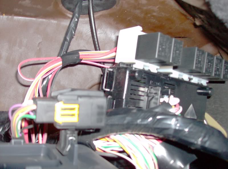

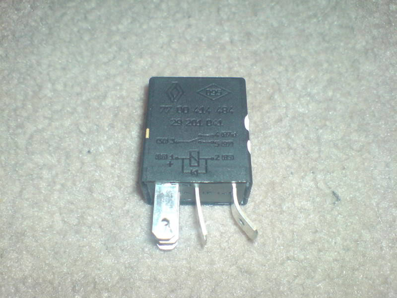

There is one more thing that I have just thought may have caused this problem. I posted another thread the other day: http://www.cliosport.net/forum/showthread.php?t=314652 basically asking what this part is:
as I found it on the floor in the passenger footwell.
So when I went under the glove box to plug it back in, I tried to put it in this little black and yellow connector first before noticing where it was meant to go next to all the other relays.
Could touching the pins in the small black and yellow block with the pins in the relay have caused any problems?

Theres your problem then. That relay needs to go back with the others, or have you already put it back? You should be able to bend the pins straight again with some pliers.

Yeah I have put the relay back in, just bent the pins back straight. I don't have a meter though. Think I've tried everything I can tbh. Looks like a trip to the stealers. Thank you for all your help though mate, appreciate it!

Tried replacing the relay... It isn't that :dapprove:

Try swapping it with one of the other relays, the relay might be shagged after getting bent like that.

Don't hold your breath until it been sorted. I can believe it though as that plug that you tried to put the relay in is the alarm interface plug (ish) so you've probably killed something.
LOL! They have already removed the part, its on the floor in the car and has fixed the problem, so I'm pretty sure it is sorted. Just need the new part putting in for the alarm. I think i will have to be more carefull when clarting about next time, haha!
