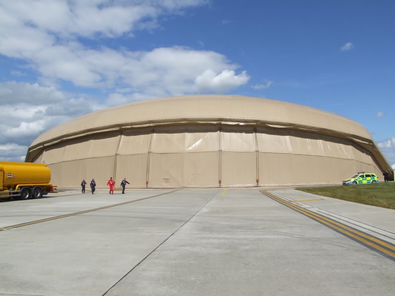

The hangers look like that. They are special B2 servicing hangers.
