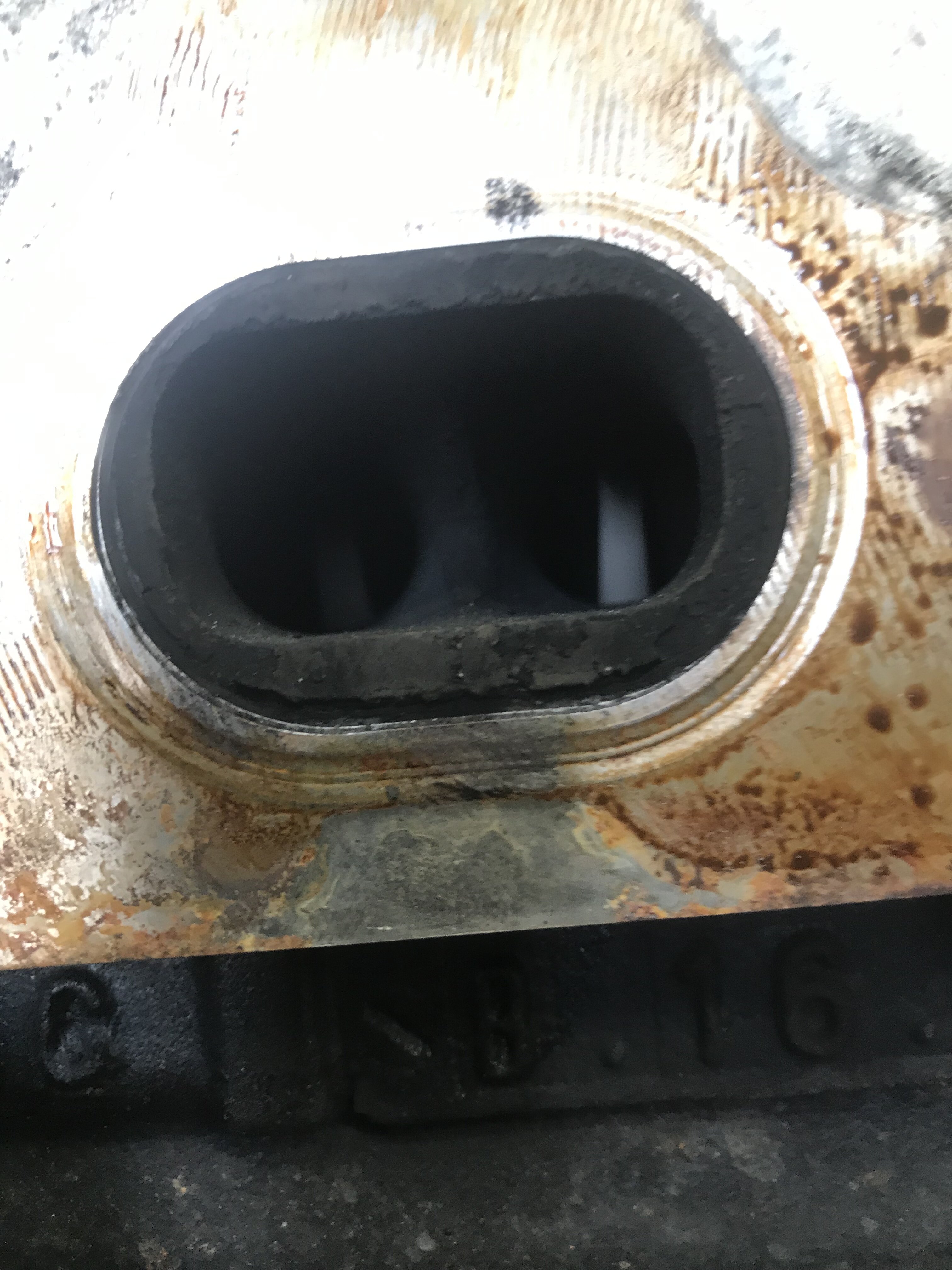

Exhaust valve stems turned white
Is this normal or any idea what caused it.
All exhaust valves are white on all cylinders

I’d say your mixture is running a little to lean .
Black = Too Rich
White = Too Lean
Brown = Just Right
Black = Too Rich
White = Too Lean
Brown = Just Right
The car seems to be running ok I’ve only took the the engine out to change the cambelt and clutch and tidy a few bits up
No misfire or anything so unsure what could be causing it. I’ll get it back together and take it for a dyno to check the fuelling

On a car that’s this age, I’d not worry too much about it. If the compression is good and there aren’t other issues (leak down/oil consumption) I really wouldn’t worry.
