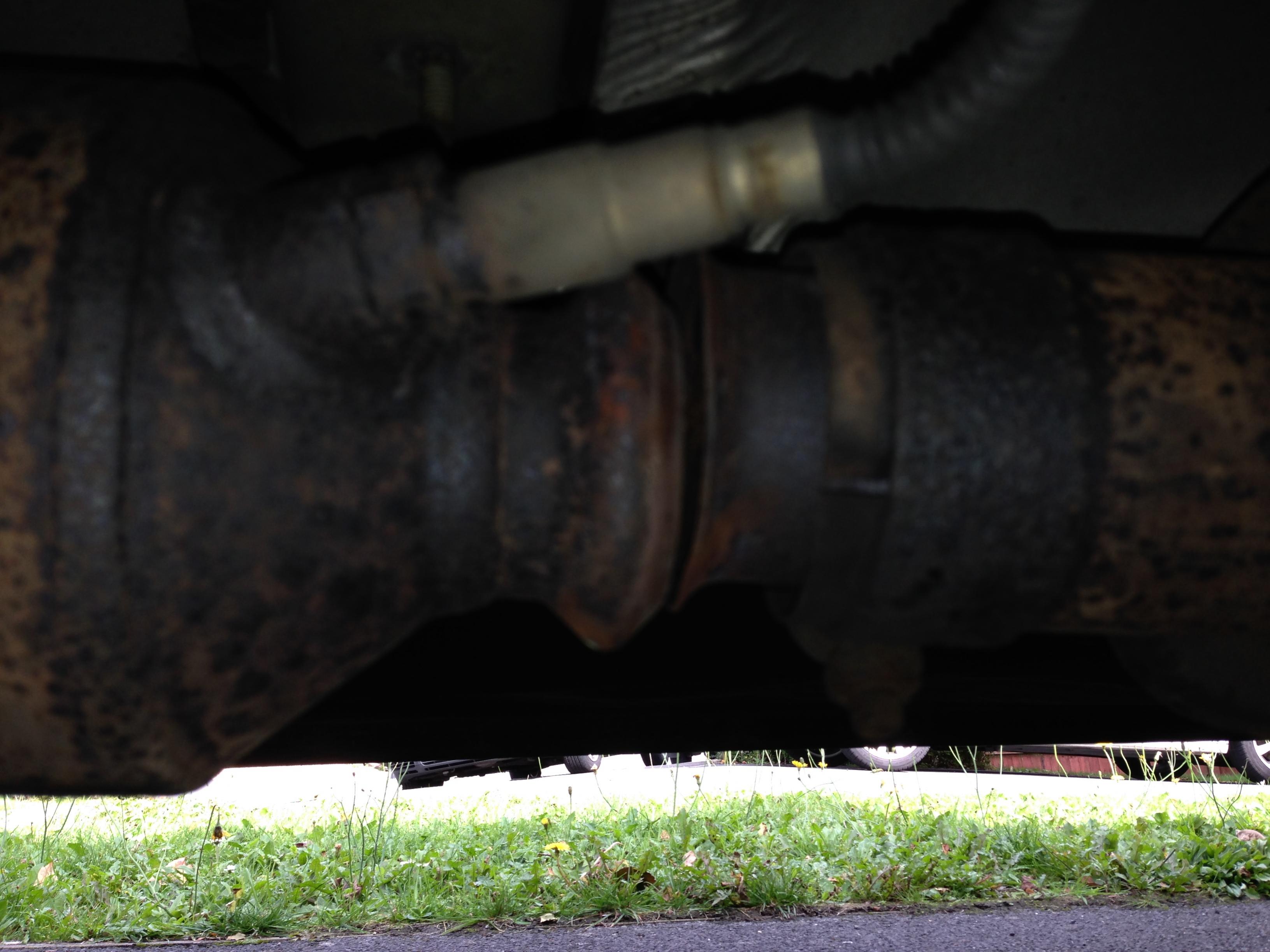

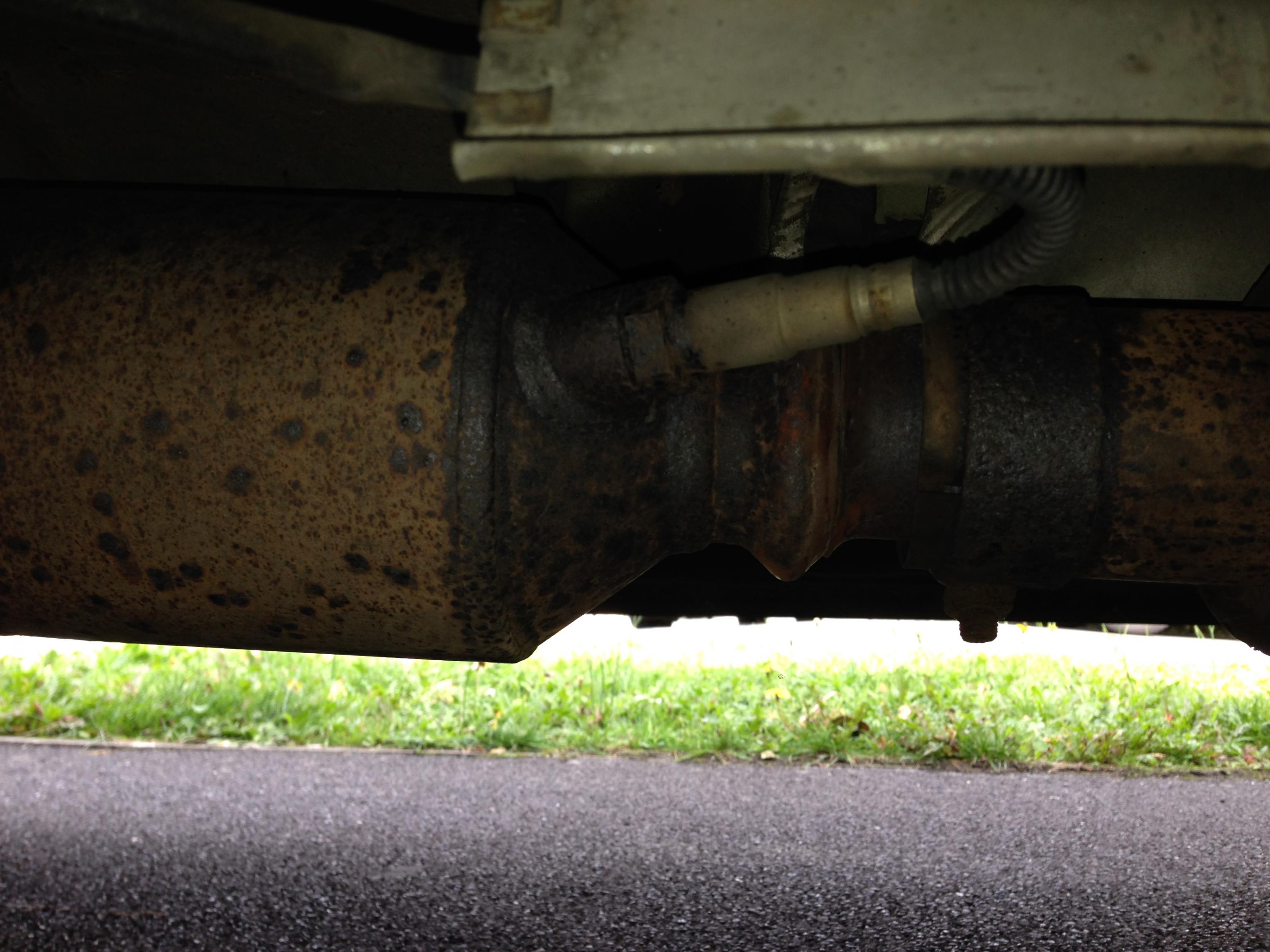

Drove home last night and the car turned into a monster truck! was so loud it hurt! anyway, pulled over and it looks like the cat has broken away from the Mid section of my Miltek system! But it looks like a really clean break so not sure if its ment to be like that :S not sure whats wrong with it!
Pics -

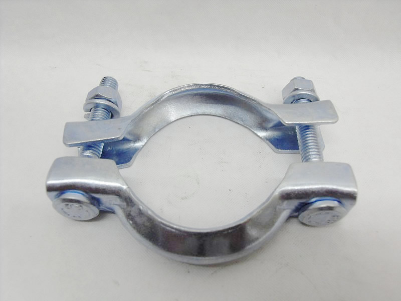

oh right, thought the Cat was snapped lol so a new clamp and some high temp sealant isit? i couldnt work out how the clamp would connect them both up when i was underneath the car!
ill get one off the bay now. Thanks Guys

If you got the money get it sleeved. I had mine sleeved the other day and I'm glad I got it done now.
