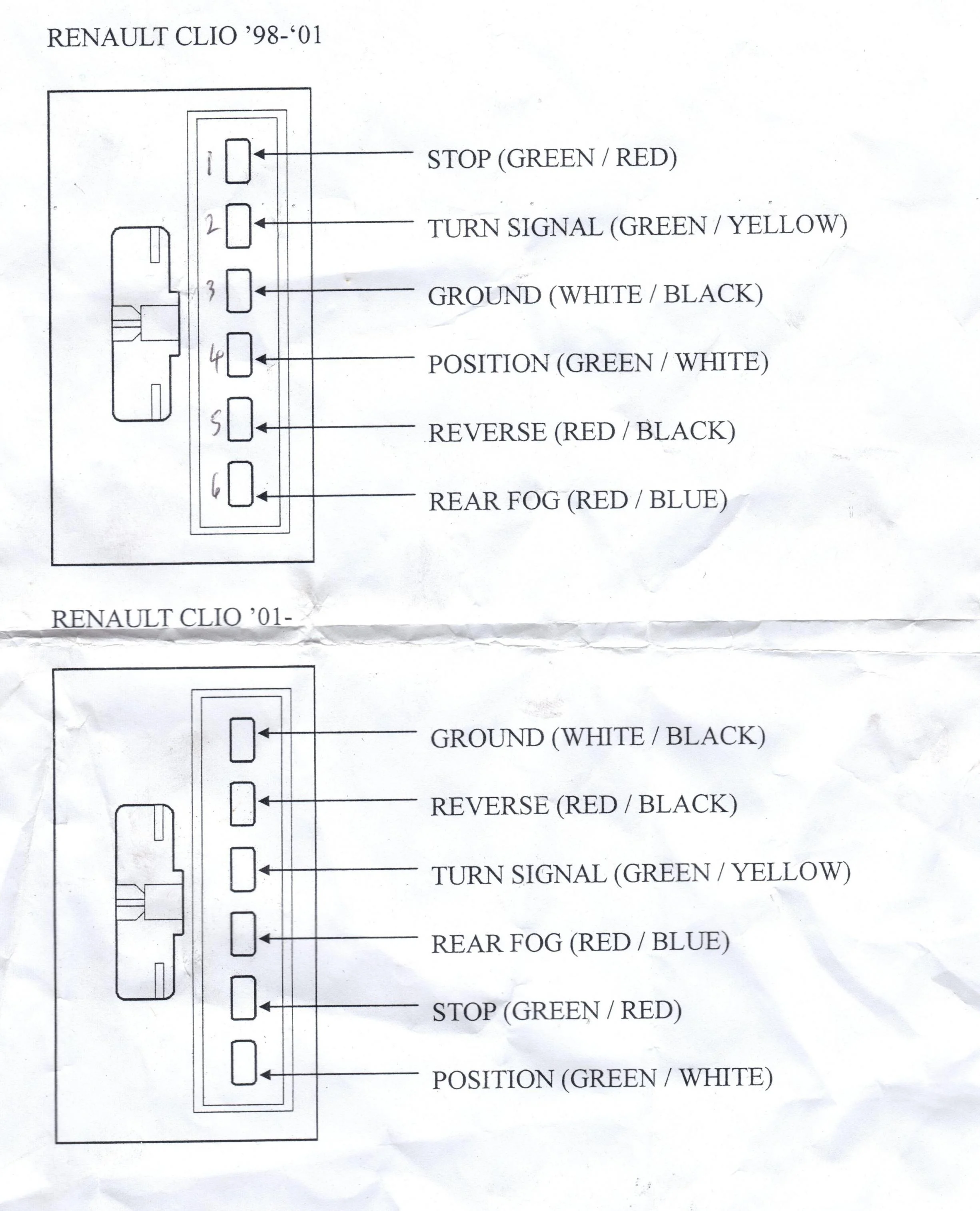

Just found this saved on my computer. You might find it handy.

Well, the blocks will either be configured for a Ph.1 (with the brake light at the top), or Ph.2 (with the brake light at the bottom). You have a Ph.2, but there's nothing stopping you buying blocks for a Ph.1 and swapping the wires over in the connector (see my last post) so that the right lights illuminate.
  Arctic 182FF
Ok that is diagram is very helpful, can the part that plugs into the socket be moved about a bit so it would work as it should or is it like a fixed unit?
BoatNonce
Well, the wires have to be swapped around when going from Ph.1 to Ph.2 OEM lights, so I'd say you can swap them about. I don't have the car at the moment so I can't go out and check how easy it is :eek:
