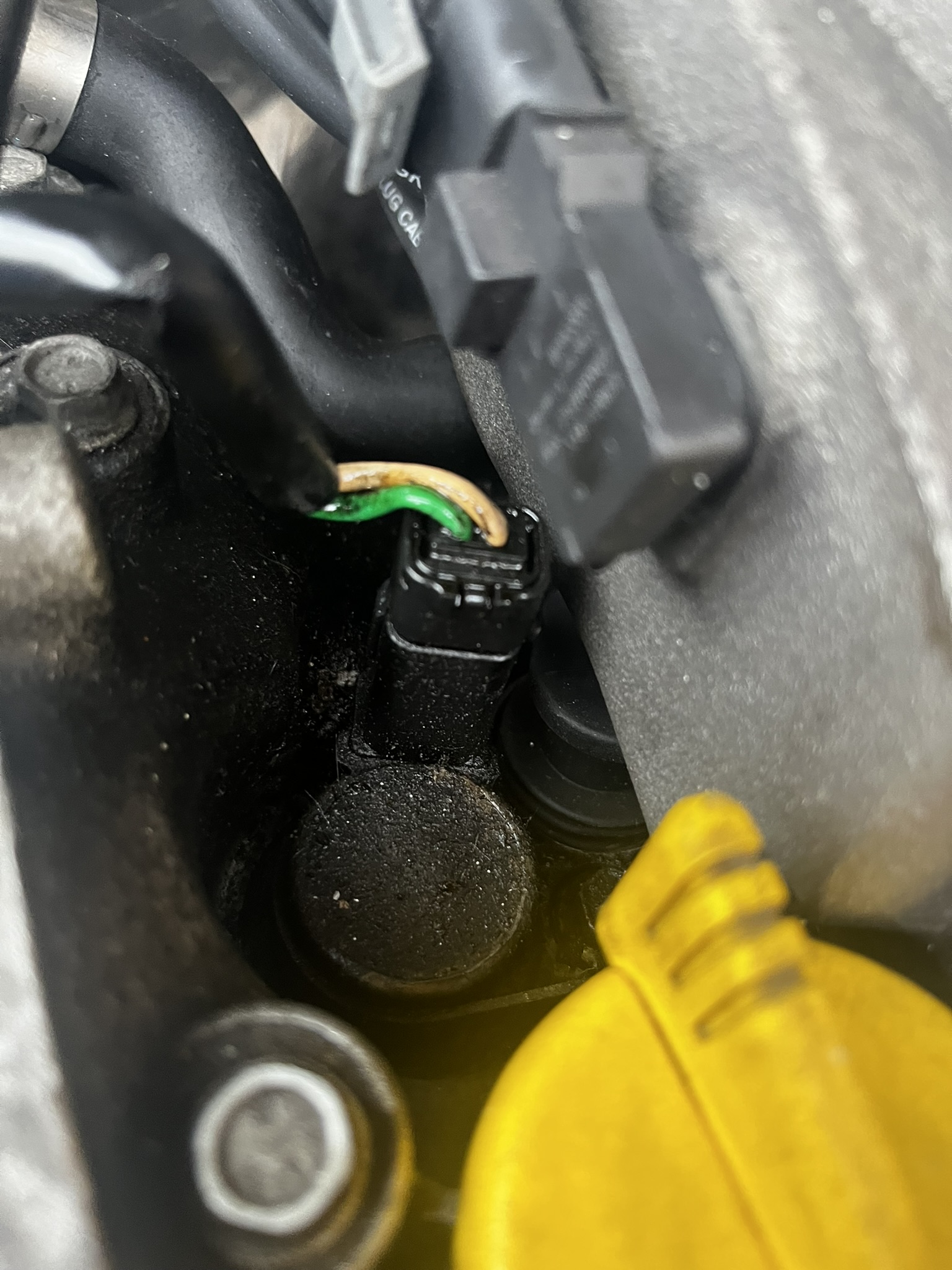

JimF
  Clio 172
Actually, this probably shouldn't be wet with oil should it? :unsure::LOL:
Daz...
  Inferno 182 Cup
Unless you’ve been throwing oil everywhere when you filled it then that’ll be the solenoid seal.
JimF
  Clio 172
I can be clumsy, but I didn't pour any that high up :LOL:
Usual suspects to get one from?
Daz...
  Inferno 182 Cup
It might be cheaper elsewhere, but this is cheap enough. They have a metal ring inside them so can be a bit stubborn when removing.
JimF
  Clio 172
Replaced this weekend, The old seal was a bugger to get out but it looked like it had been leaking. Plenty of oily gunge around the solenoid. And the car wasn't much better either :LOL:
