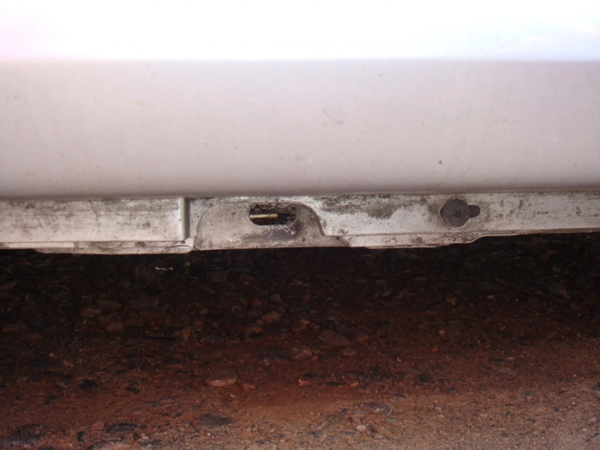

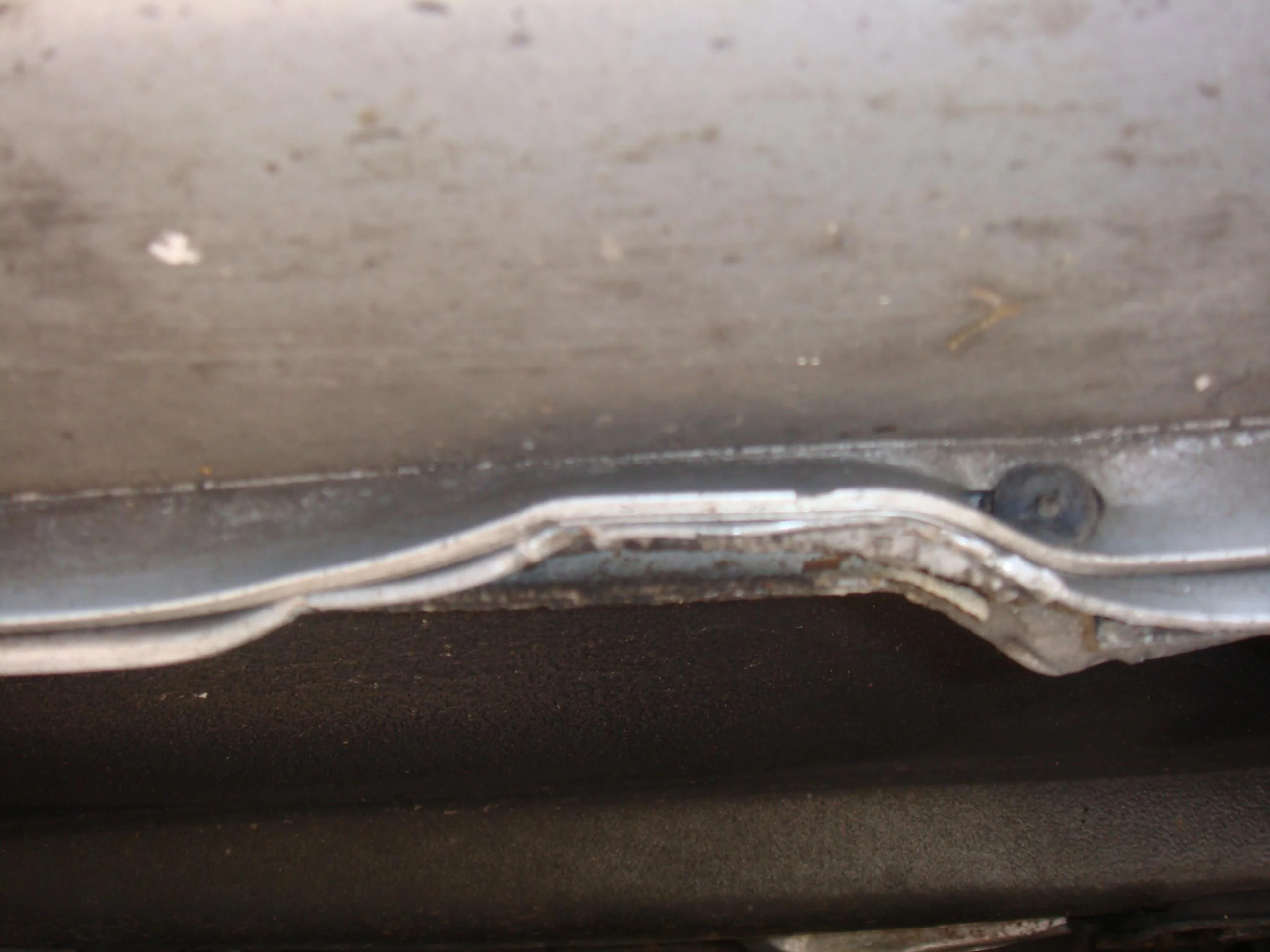

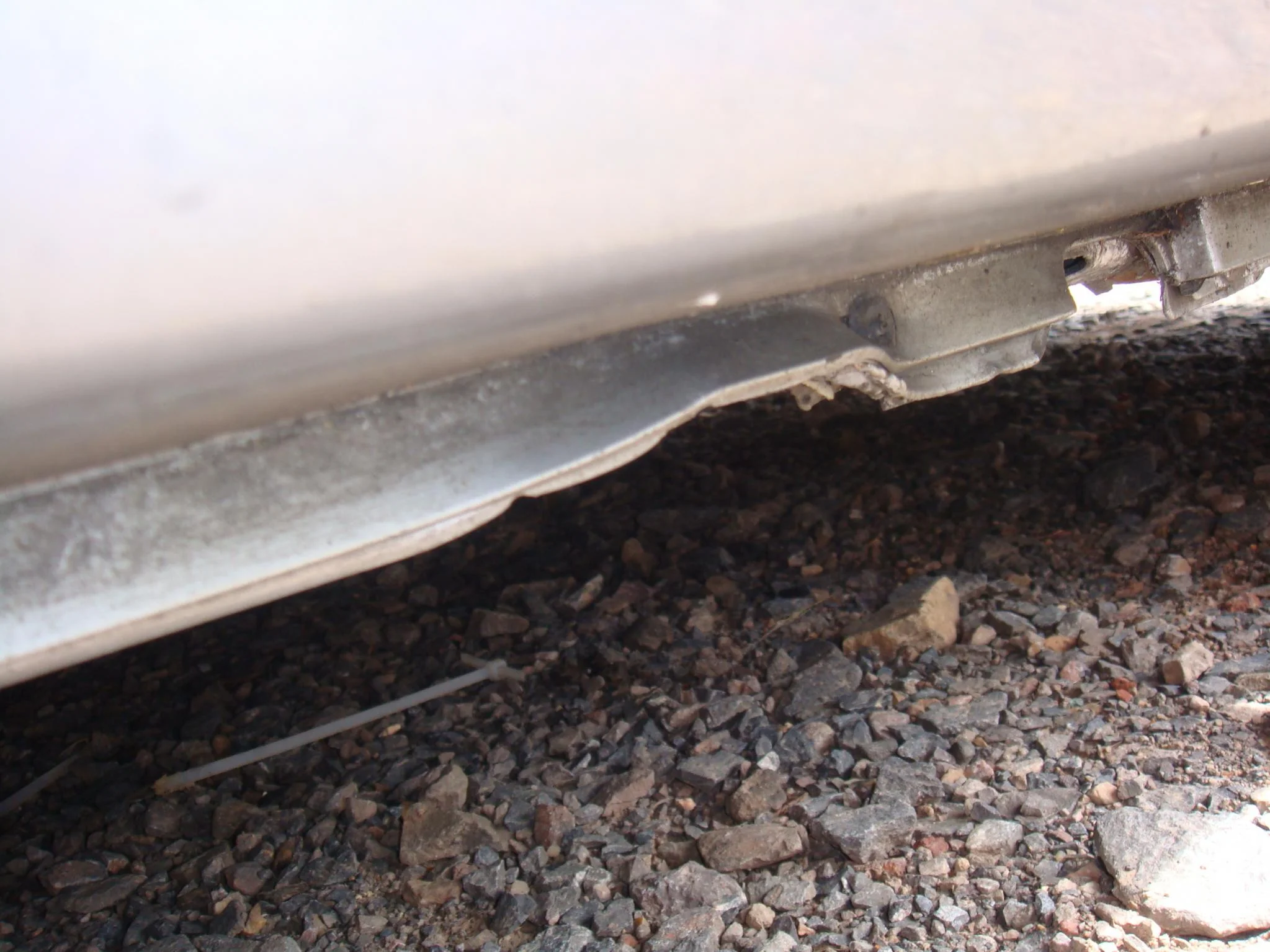

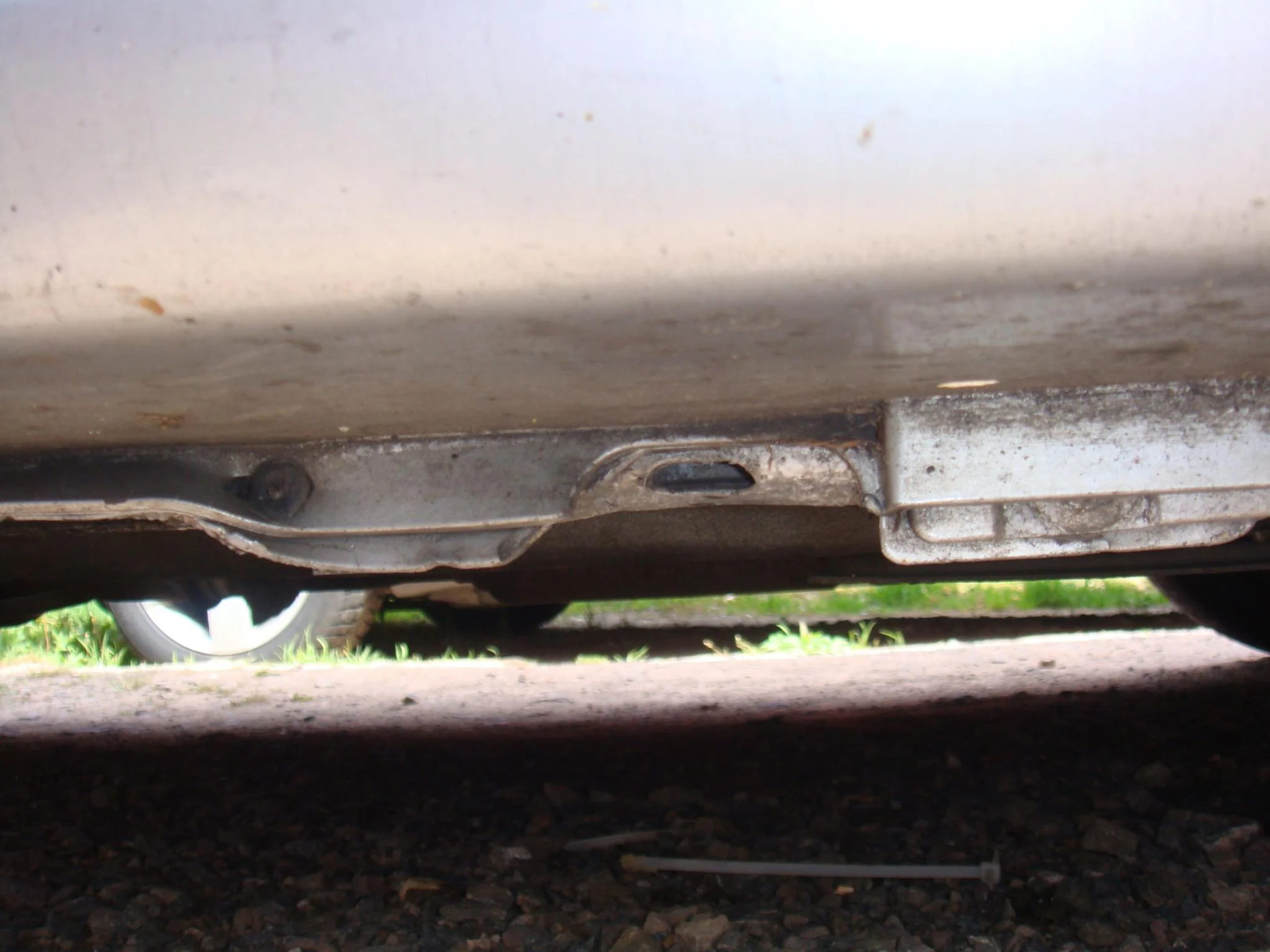

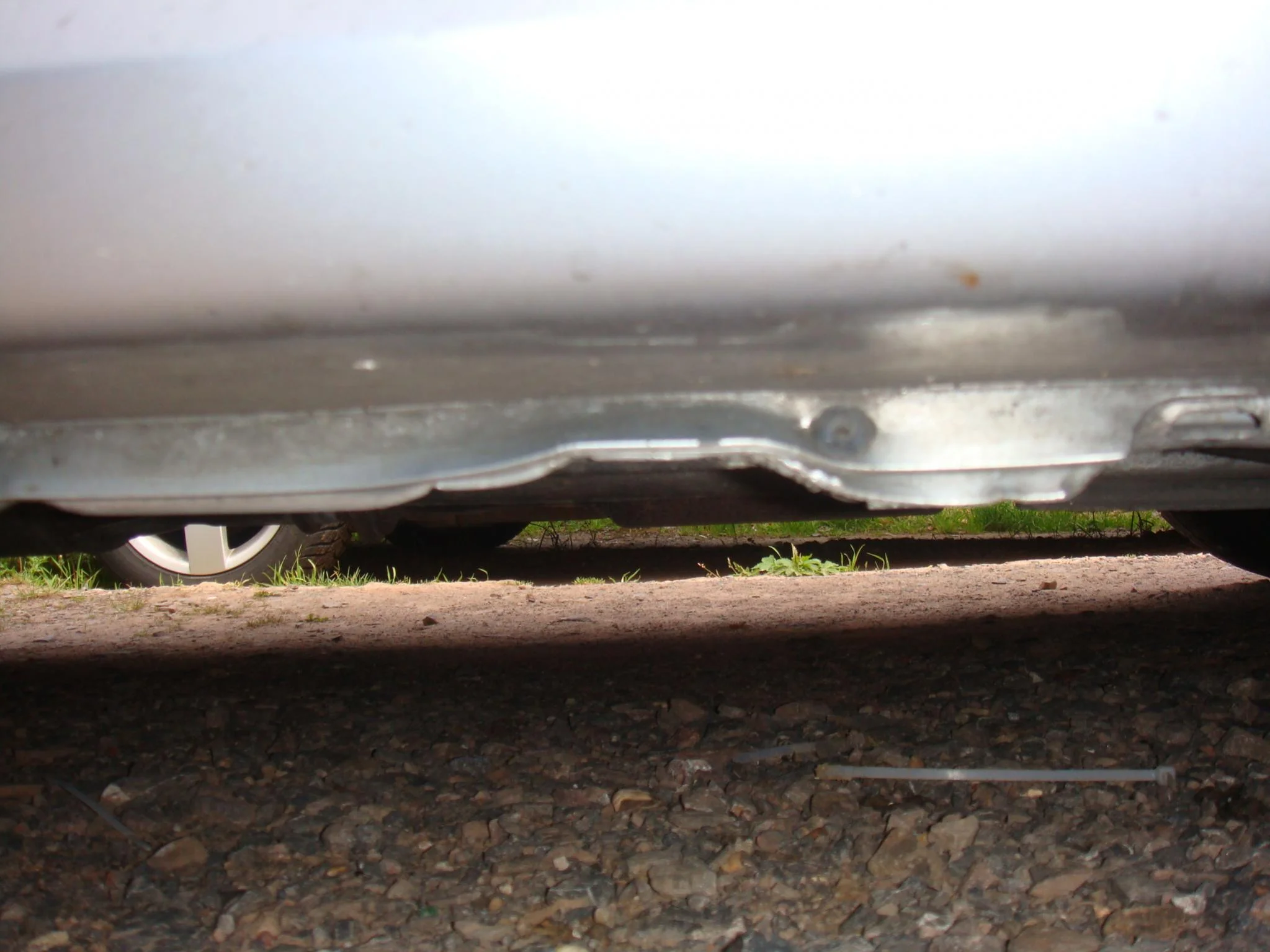

Just notice my drivers side front jacking point is bent!:mad: Never notice it before, not sure how it happen tbh. never jacked my car up always been to a garage for that. I do know its wast like that when i got the car last april so i thinking must of done it on a speed bump or getting on/off my drive. Dont think it would be the sort of thing a garage would do?
Anyway just wanted to know how it would affect my car, selling it jacking it up? And can it be fixed????
Last pic is how it should look.

One of mine is the same, but bent inwards rather than outwards, it bent very easy TBH.
  Astra 1.9Cdti SRi
Thats not the jacking point fella, thats the sill, and if you do find a proper answer on how to bend them back then let me kno, as mine look horrible.
* jacking point is under the car i use the chassy youl notice it goin towards the back and dissapears.
  Astra 1.9Cdti SRi
^ you sure? if they were the jackin points then why would then bend? & when you take the car to a garage they place the jack more under the car's body .
  Punto/Clio GTT
that is not a jacking point, thats the sil lol
bend it back with a hammer if youre feeling brave, just lay under the car and hammer it til its straight
Matt_90
  Sprint/climb 106 gti
Mine make some funny noises and have a very small bend. If they are meant to be the jacking point then they are made of cheese.
I now do what Jay does and Jack the car up from a point on the chassis.

They are the jacking points what are bent and as said them holes in the bit that is bent is for the hook on the scissor jack to go through. Yes they are like cheese and not up to the job and all this bollox about they wouldn't bend if they were ment to be jacking points, buy a German car and they wont!
  145db Euro'd clio
yeah thats the jacking points for the standard jacks. just shove a hench screwdriver through the hole and very carefully bend it back. did it to mine and their fine. their just very easily bent
  Golf GTD Mk7
true fred. Prob due to less weight i guess. Front ones are gash. Just in the process of bending mine back. Use mole grips or similar. Put some cloth between the jaws to stop damage to the paint and touch up if required. Always use the chassis to jack up now.
