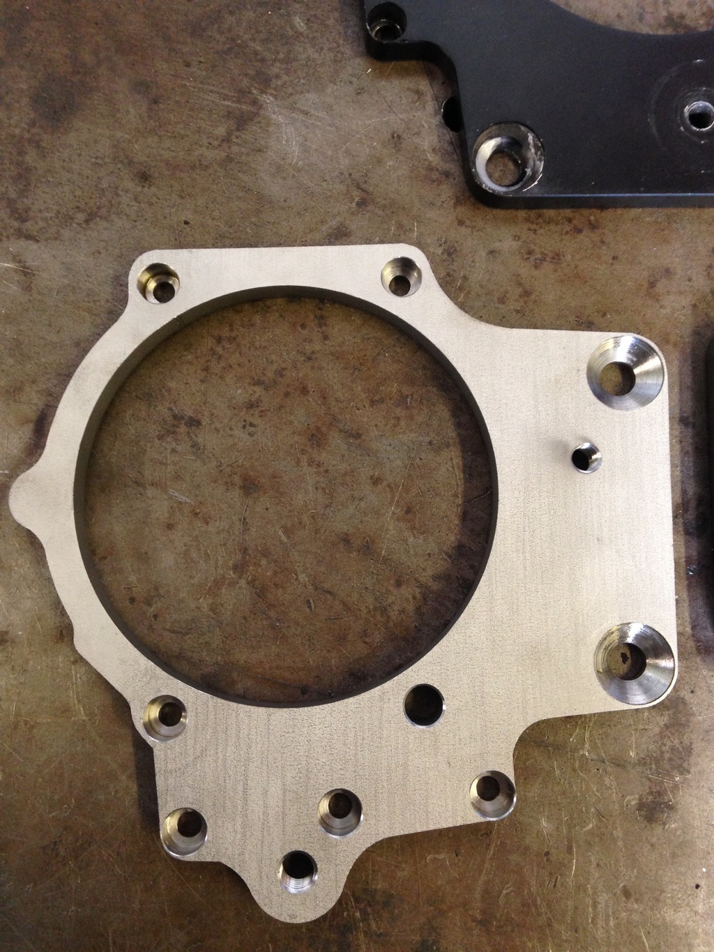

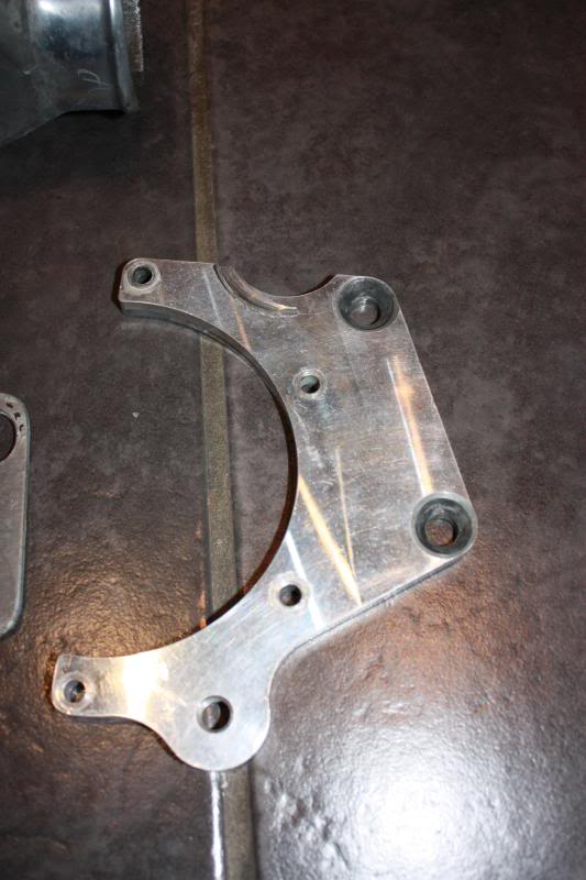

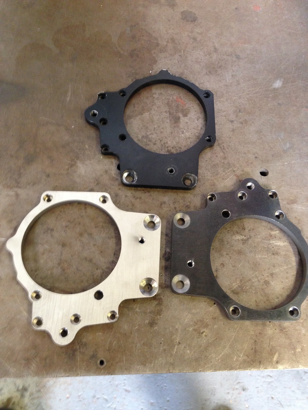

I was always going to make steel ones if I ever went forged. The omex ones were the absolute firsts to be made so are almost prototypes!

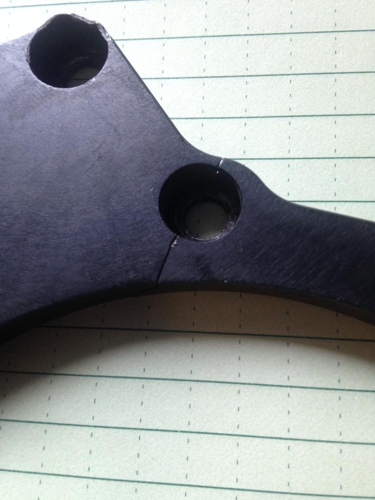

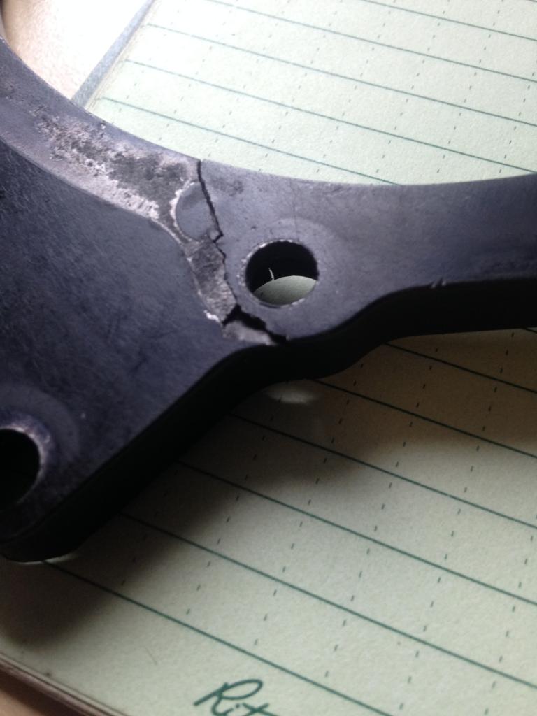

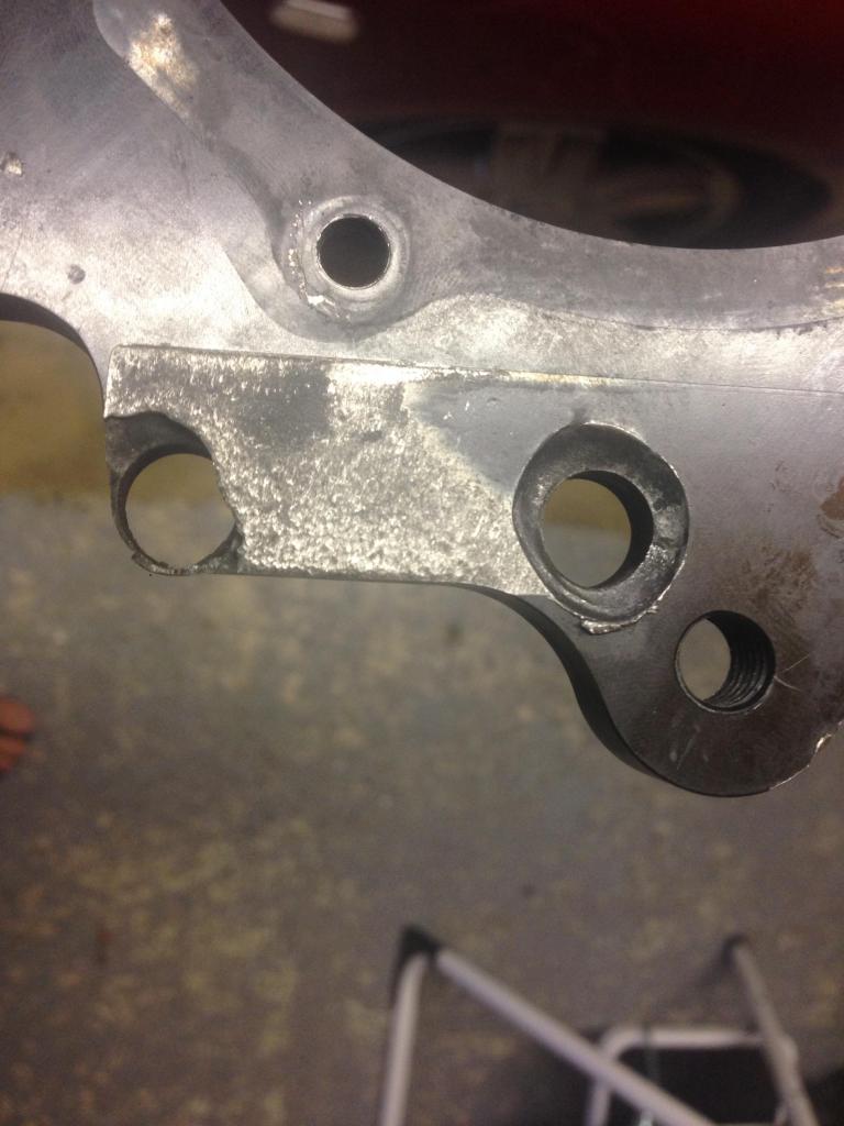

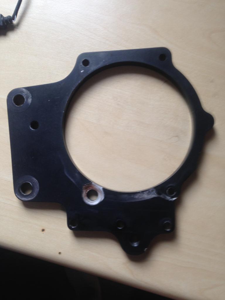

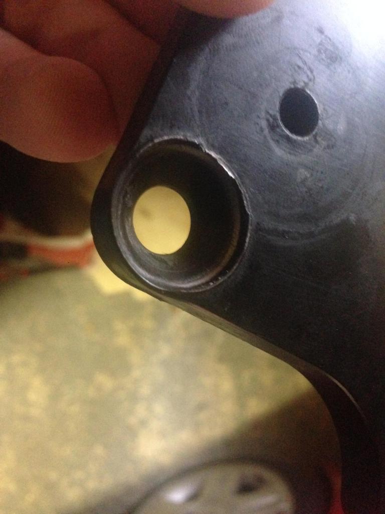

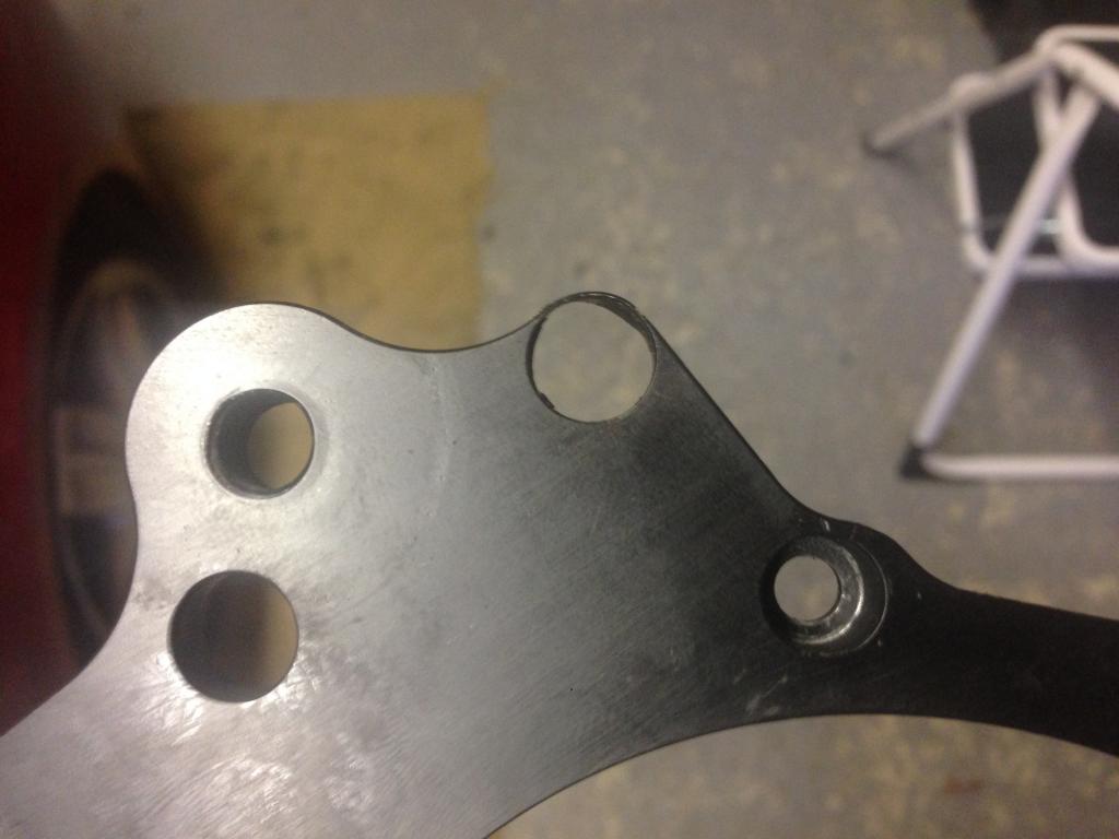

Hay bud, as discussed....photos...hope these help.
You can see clearly where they have worn away / warped the bolt holes under load. The worst is the very 'thin' bolt hole in photo 2 and 3. Close to snapping when it came off the car. I have new k-tec brackets (didn't buy them) but i'm going to speak to @Dan@SJM about the potential for a repeat performance tomorrow when he is fitting the kit.
yeah i agree Chris, fairly flimsy design, looking at the bolt hole that cracked, there is only 1 mm of aluminium on the outer edge of the hole and only 2.5 - 3 mm in depth from where the have drilled for the bolts
making it out of steel should sort these issues though
wonder how many have had these fitted and have had issues with them breaking @tom172cup
  big boost cup

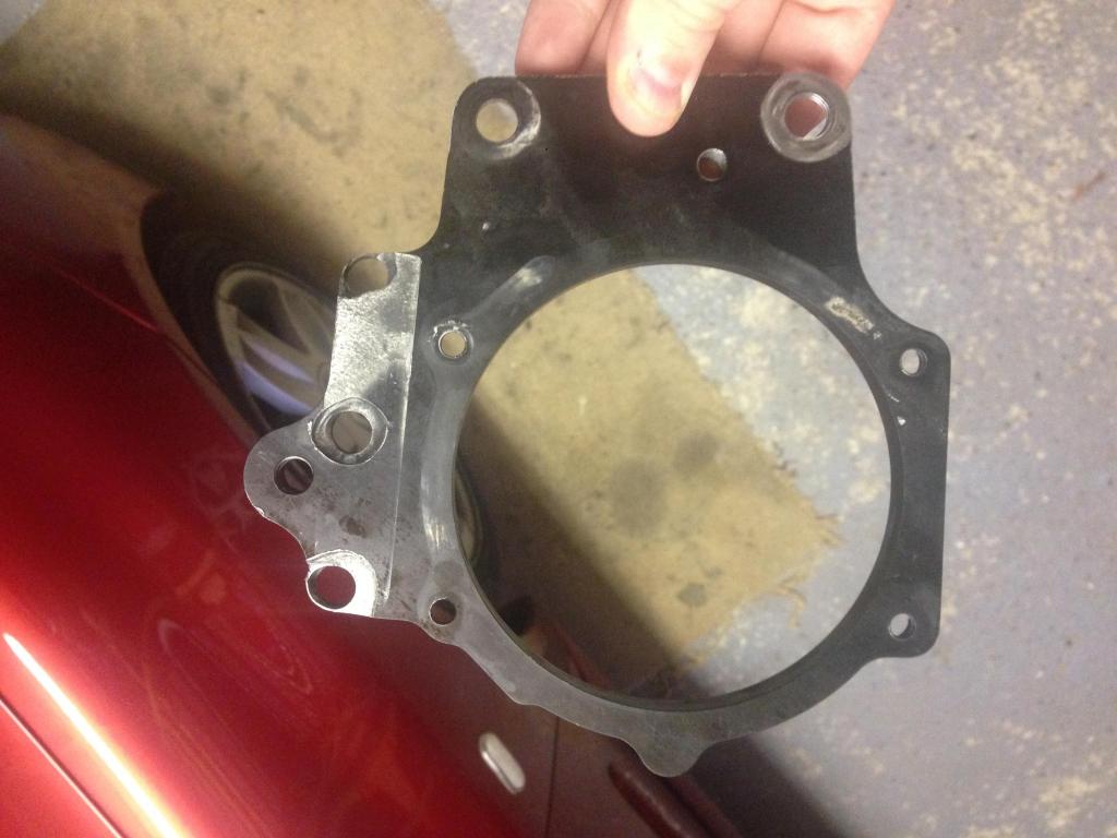

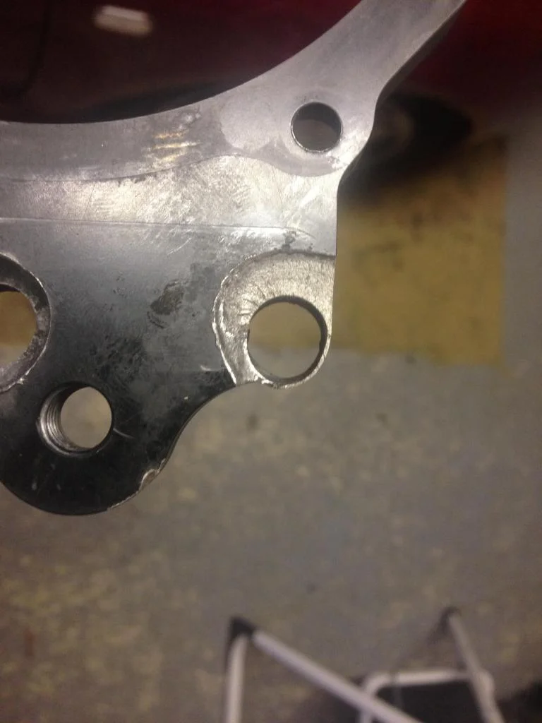

That's another reason I don't go to gaytec anymore. There workmanship is shite. That bracket of mine has done 8k max
  SQ5
I had the first revision of that which had a similar bracket the inlet side too. It cracked but in a non important area.

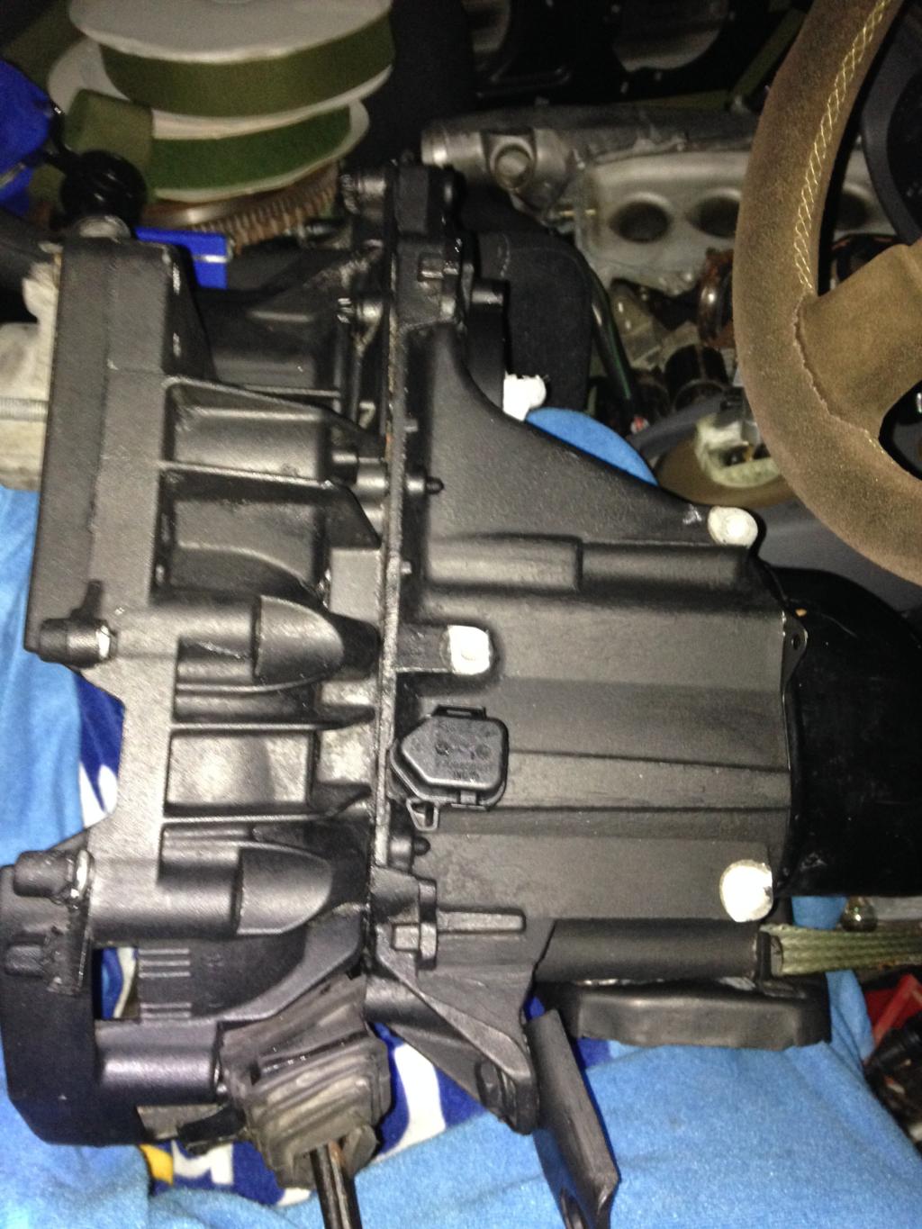

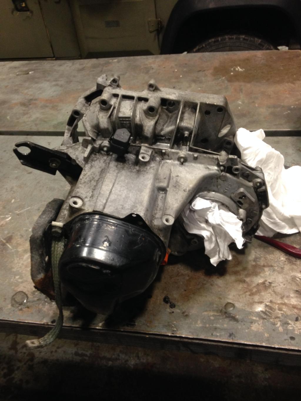

got my gearbox back, so gave it a quick clean and decided to paint it in vht black, looks much better
Before
After

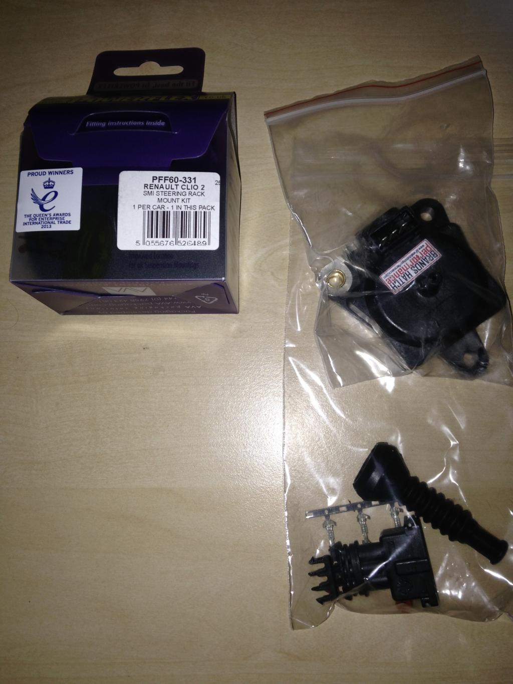

some steering rack bushes, and a 3 bar map sensor from brands hatch performance, seems like they have the best after market copies of the original Weber Marelli sensors,
now to wire it in to an omex
