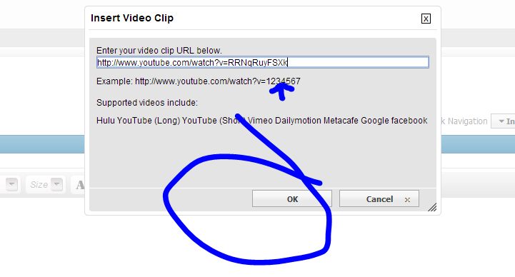

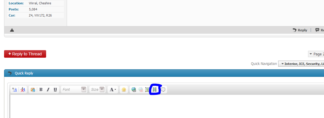

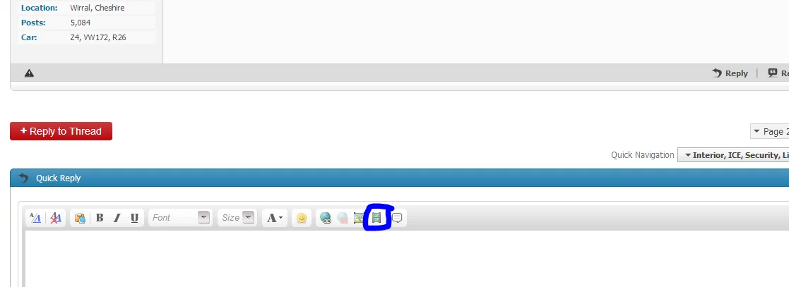

Like this! Sorry for the crappy circling!
End result:
