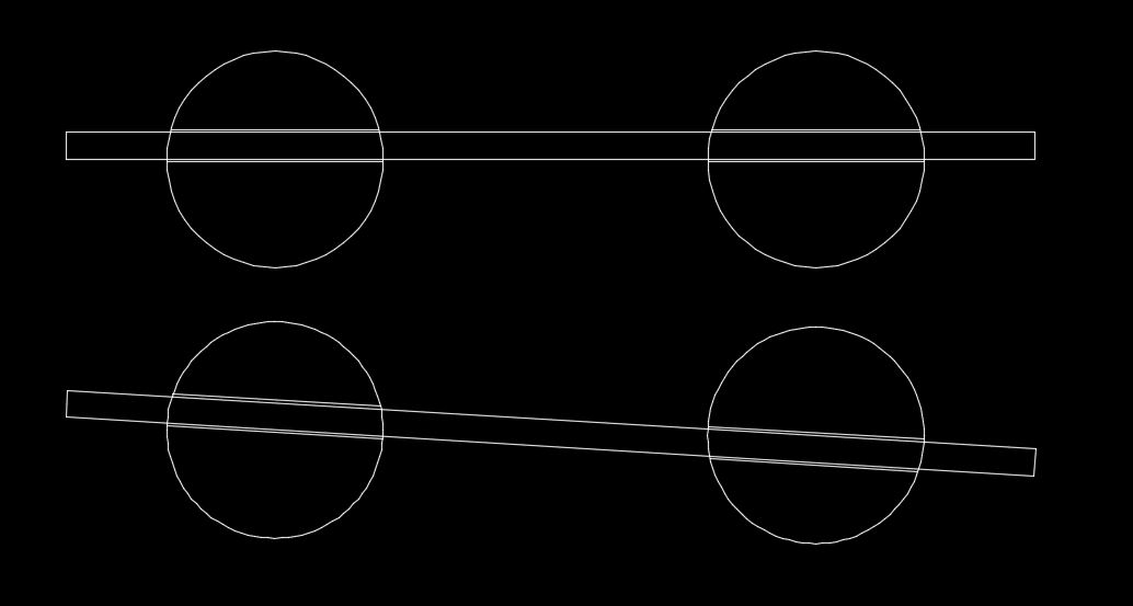

If it's idling like crap then the timing is out. I'd suggest they haven't a clue what they are doing. If you can get them to send you a picture of the horse shoe shaped tool in the end of the cams. If you're timing is spot on you should be able to do this with it in place:

Of course it will, it means both cams will be a little bit out:
