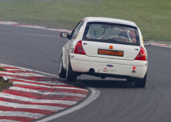

You can learn to drive them quickly, but you just can't plant your foot down and hope for the best.
The ones we had in Hungary were set very aggressive, and would understeer at a drop of a hat, again you have to learn the knack.

if you ain't on 2 wheels you ain't trying - simples ;)
  182/RS2/ Turbo/Mk1
Tony, did you left foot brake slightly when you were on two wheels to allow you to put the power down, or was it a case of you were back on 4 by the time you needed to power on anyway?

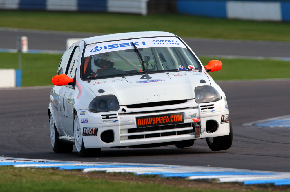

Is that Donnington Tony? The 2nd tier of that kerb looks sore.
You would be going some left foot braking at the type of corner (tight mid speed) you typically lift a wheel, a sequential box you might manage but it's just not a feasible option afaic. I would think the diff will not function right from when it hits the kerbs until after its on the ground and its settled again so quite a time to not be pushing forward.
Nah doesn't need to be "settled", the moment there is any suspension compression at all it will start to drive both wheels even if one spins a bit still, not as well as a gripper but still way better than an open diff which only ever drives the wheel with least grip and would need to be settled.
