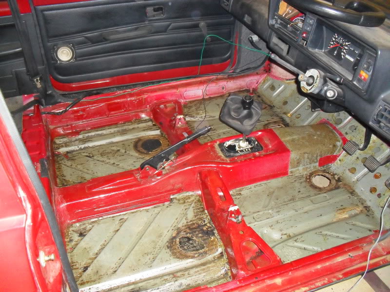

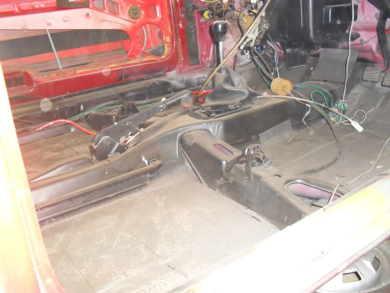

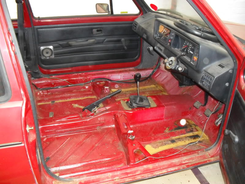

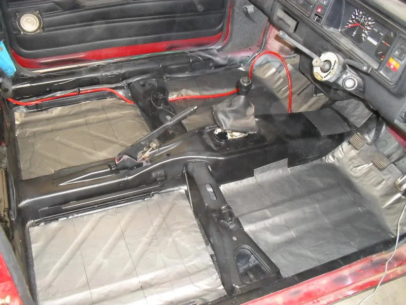

how the inside looked when i started

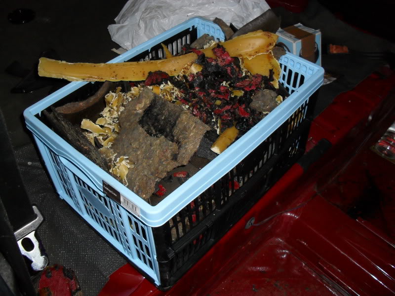

after removing the inner 28 year old sound deadening... yuck
said sound deadening

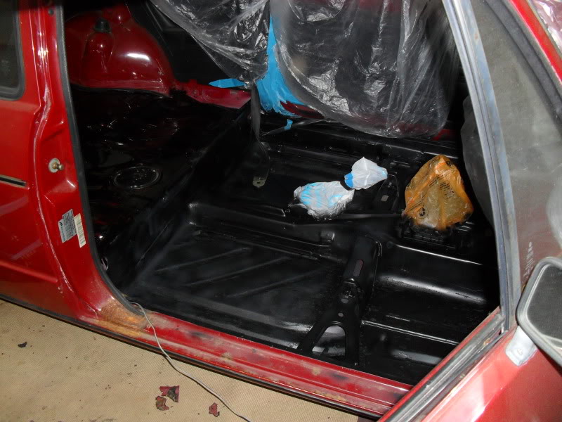

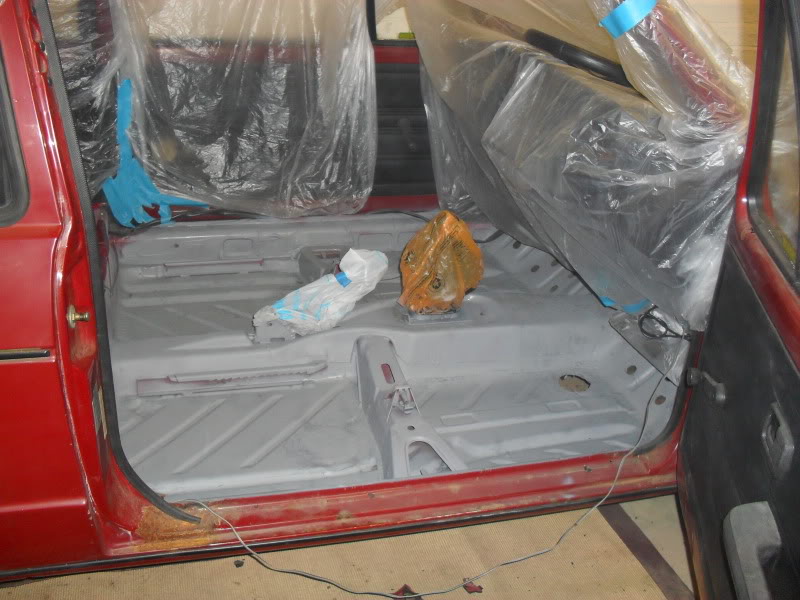

primered
painted

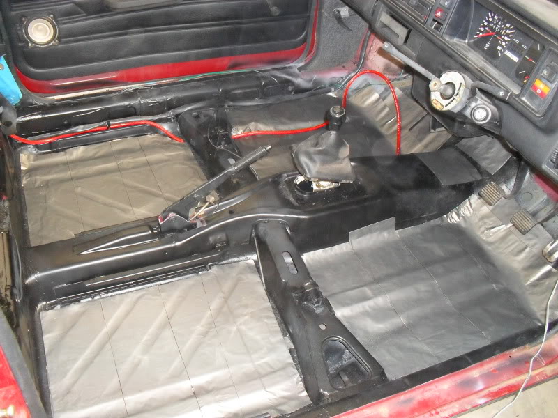

and new sound deadening installed :)

put new sound deadening in because it would be silly noisy in there without it. and the carpet would be baggy without it. New stuff weighs about 10% of the old stuff.
but im not overly bothered about weight saving, very light car anyway... i can pick it up by myself atm...
good work! how come you put new sound deadenin in? i wouldnt have bothered
agree I wouldnt have bothered with new sound deadening but each to their own.
Is it just me though or does the black paint look really patchy in the last interior shot?
whagt I'm seeing is not dust on the lens... I can see the dust as well though.
I mean the grey patches all over where you have painted black. Under hand brake, behind gear stick, to the left of the clutch etc.
  AMV8, Mk1 Golf
nope all one soild caolur, i got laughed at as i was taking so much effort to get it 100% perfect even tho youll never see it.
if you look at the black door card that also looks patchy ... but its a solid black door card.
as said even if it were what does it matter, it will be sprayed with the shell and then have carpet over the top.
the aim of this car is not a show car nor a track car, its going to be a daily so all sound deadening and trim will be updated and replaced.
it should look almost standard when its done to the untrained eye with lots of special bits here n there :D

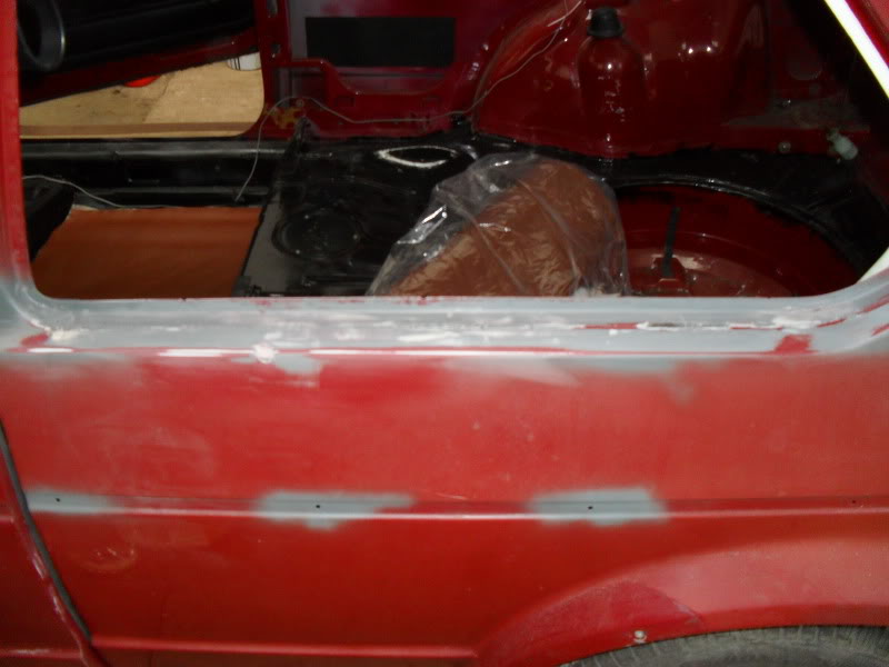

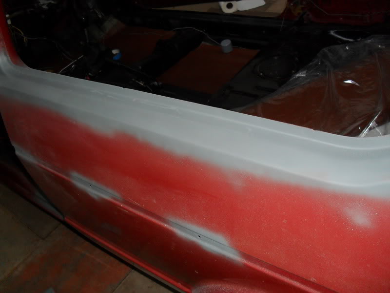

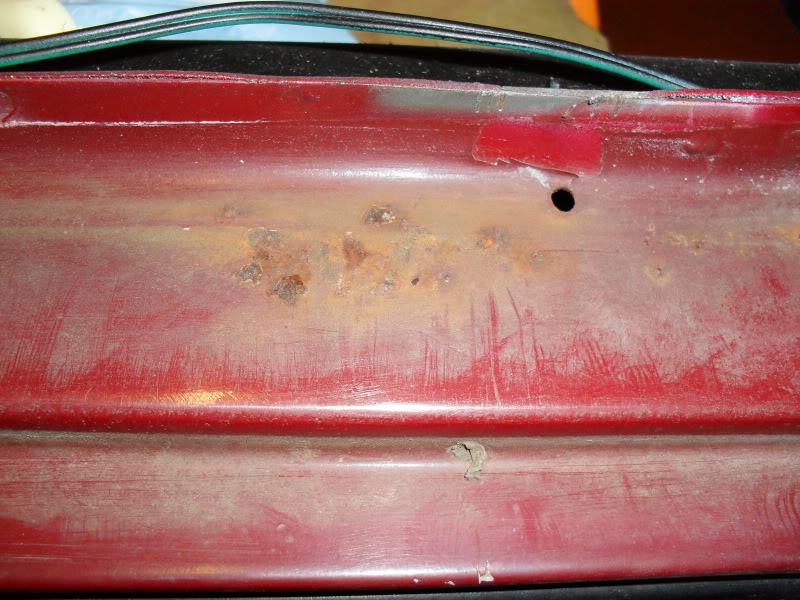

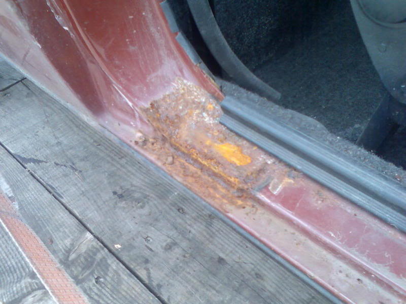

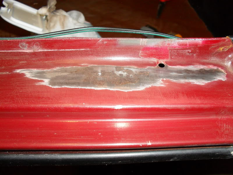

both rear window frames has rist on them
the other side is worse and still needs to be welded :)
this side after some work

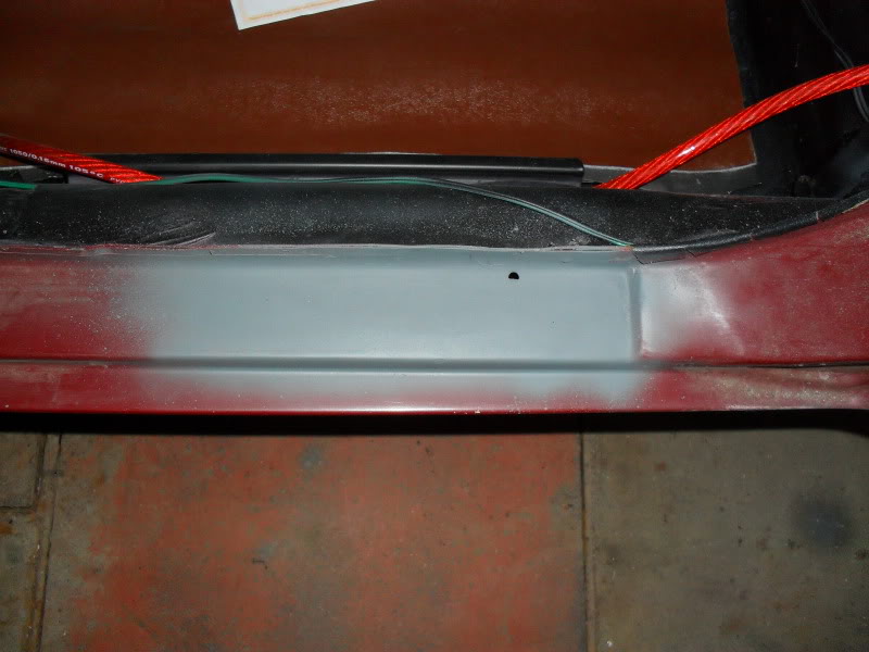

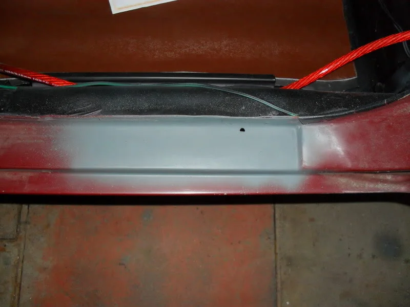

similar kinda deal with the sills

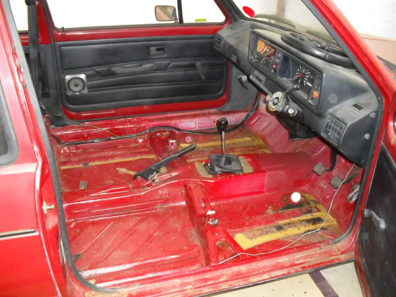

for those worried about the patchy floor... this is how it looks atm

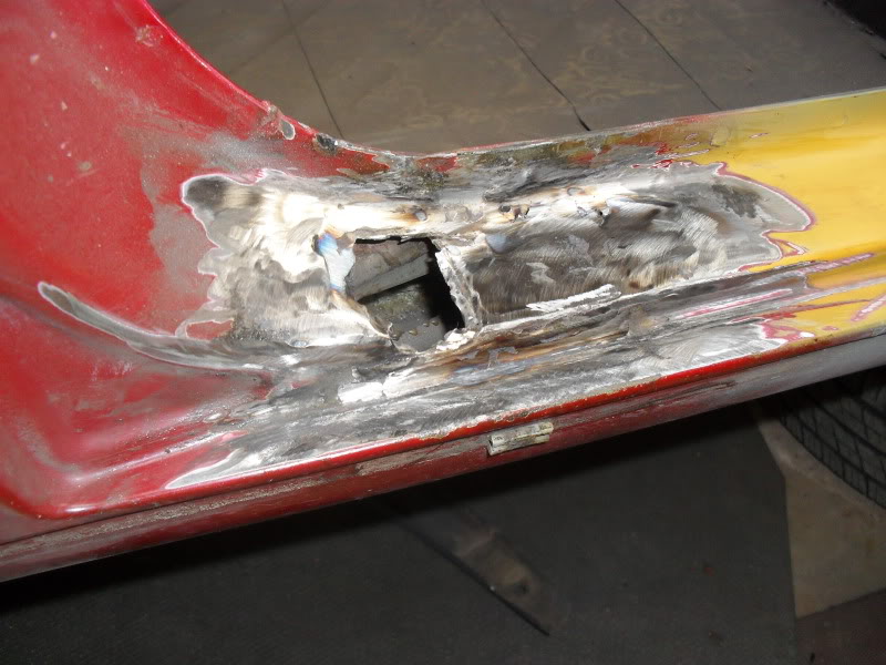

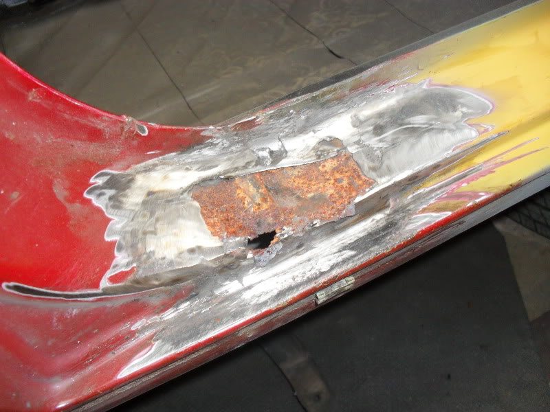

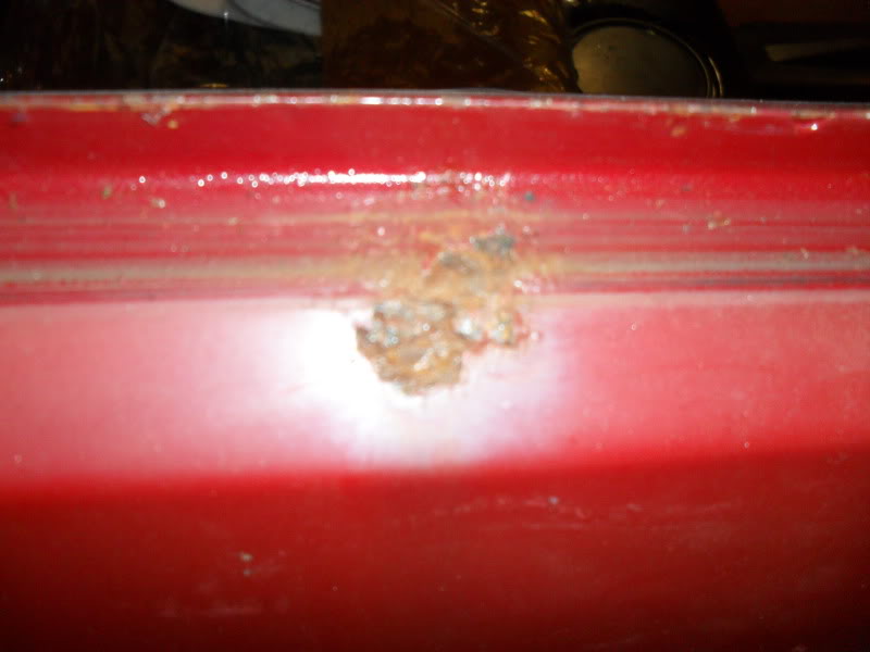

Worked on my hole last night...
some back ground on "the hole"
looked like this when i got it

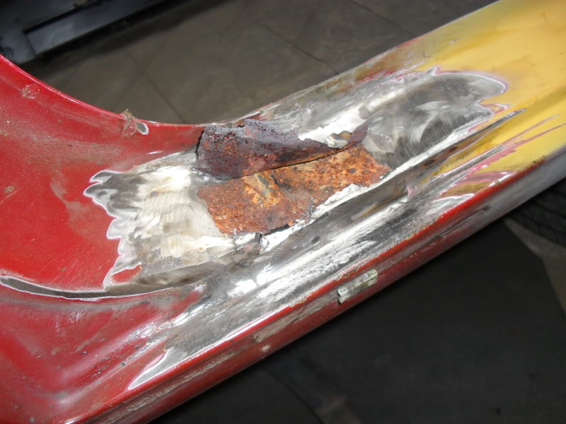

on grinding it back i discovered it looked like this
which made this
Welded a small plate in but the surrounding metal was like tin foil
started grinding it back last night and jusy started going through so thought sod it all do it properly
crappy iphone pics coming up
after grinding back
taken back to decent metal
ouch thats a big hole
then 3 hours of messing with sheet metal, body work hammers and lots of swearing an d throwing tool about, id managed to fabricate a decent enough peice...
still required some tweeking but it was getting late
:D
im proud of that :)

You shouldn't filler over pitted rust, you'll regret it if you're planning on keeping it hun.
  AMV8, Mk1 Golf
I Havnt, its all been taken back down to bare metal.
trust moi ive not been allowed to take any shortcuts on this. the 2 guys i share the unit with make sure of that!! lol

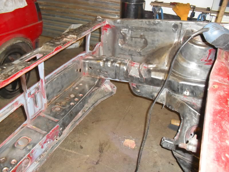

Why have they chopped the front end off?
Are they proffesional restorers?
  AMV8, Mk1 Golf
CHOPPY CHOP!
making a space frame, like the green golf at UD this year (will mean nothing to you lot so ill try n find pics)
thats the fun car! 2 vr6 engines here we come.
not professional no, both mechanics and have been building/making/restoring cars sinse they were like 5 years old lol

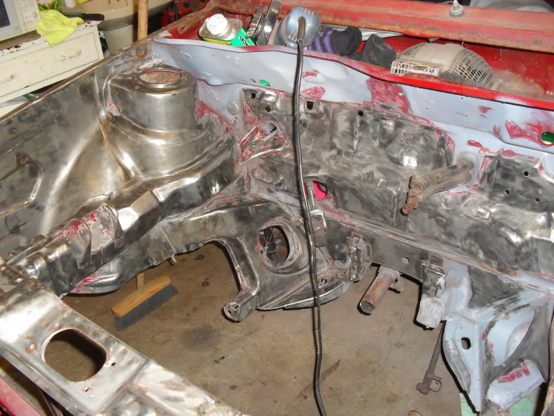

ENGINE BAY... ALMOST THERE
me looking like i should be skiing not working lol
Christophers new higher turrets!
