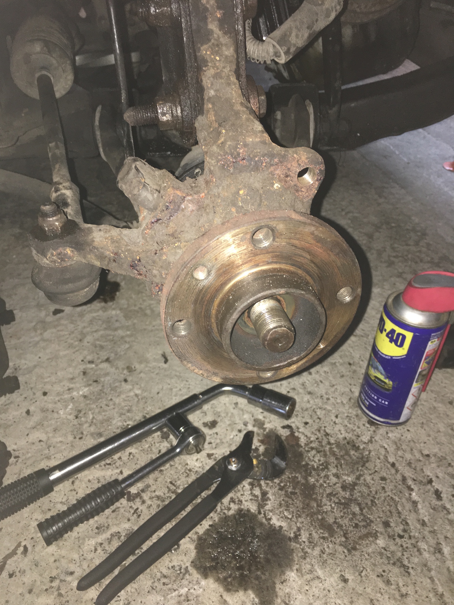

Not much to say on tonight's work. I did manage to get the torx screw off but was then met by a brick wall when neither of the 2 bolts holding the hub would come off [emoji35] I'm going to have to invest in some proper tooling me thinks! [emoji23]

You've still done more than I have aha! I'd recommend a Halfords 18 inch breaker bar, or even a 24 inch one. Lifetime guaranteed, and I've jumped on mine to get things undone before. That said, I'm no rugby player... Also, I only use 6 point sockets on bolts that are stuck.

Haha! Yeah I think I'm going to go & do a bit of toy shopping tomorrow! Pick up some new spanners & a breaker bar. This driveshaft WILL come out! Lol

Nice! If there's one thing I like more than vehicle shopping it's tool shopping aha! I like to put my suspension back together with some copper grease on the threads to save the battle every time it comes apart. I also religiously torque everything, because I'm one of those people that over tightens things otherwise.
