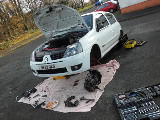

Get yourself a pink sheet, a pizza and some tools and get cracking
(Many moons ago and my neighbours probably hated me)
