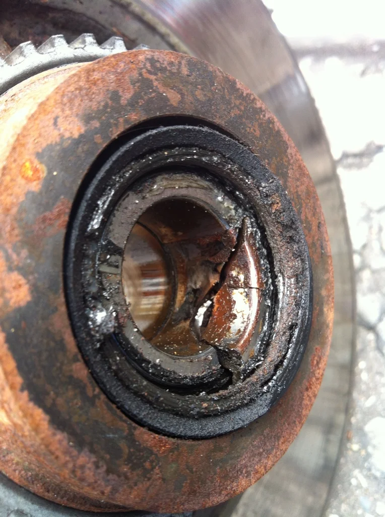

New rear discs fitted. Broken wheel bearing content
  Clio 197 RB
After a few weeks of a horrible noise coming from the back of the car, it was diagnosed that it was a faulty wheel bearing. So I got them fitted on today and here is the faulty wheel bearing. Not looking very good at all.
Now the car sounds normal again. So nice. But I had my drivers side handbrake cable snap this week, so another thing to do. Lol.

Non genuine discs? As above spacer not fitted or under/over torqued up??
Guranteed scoring of the stub axle would be shocked if it isn't.

Im guessing with the above comments thats its item No8

well then they'll be f**ked in about 2weeks flat!
spacers come with the car, not with the discs, it seems yours have gone AWOL like a lot of other cars, no spacers = f**ked bearings quickly

As Fred has said, they should be with the car, no discs come with them.
You need two of this part number mate:
6000073518 around £7 each.

Yea it's f**king obvious isn't it, even my dad who used to be a mechanic missed it.
If I wasn't a member of this forum and I bought these brakes off of eBay and fitted them, then I wouldn't have even known.
Now people have mentioned it I can rectify the problem.

It is obvious? Discs look completely different with it missing. Always compare what you take off with new.

Just checked the old discs, doesn't look as though the spacers are on them so, either the spacers are still on the car or I have been running those old brakes for 2 years plus without spacers?
Yes mate that was why I asked in the first place as I guess they had been run without hence all the damage in the first pic! Just grab a couple from Renault and pop them on so that it doesn't damage your new set :)
No not all the time, Mine didn't have the spacer's for a while and I didn't know until I took the disc's off the first time! There was no play until it shagged the bearings, it had ground the bottom of the stub axle on mine though where the disc had been rubbing on it
