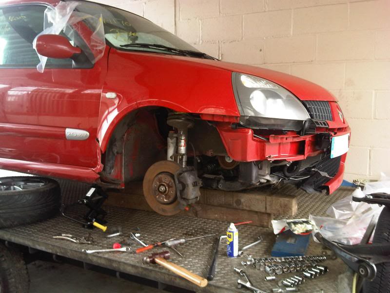

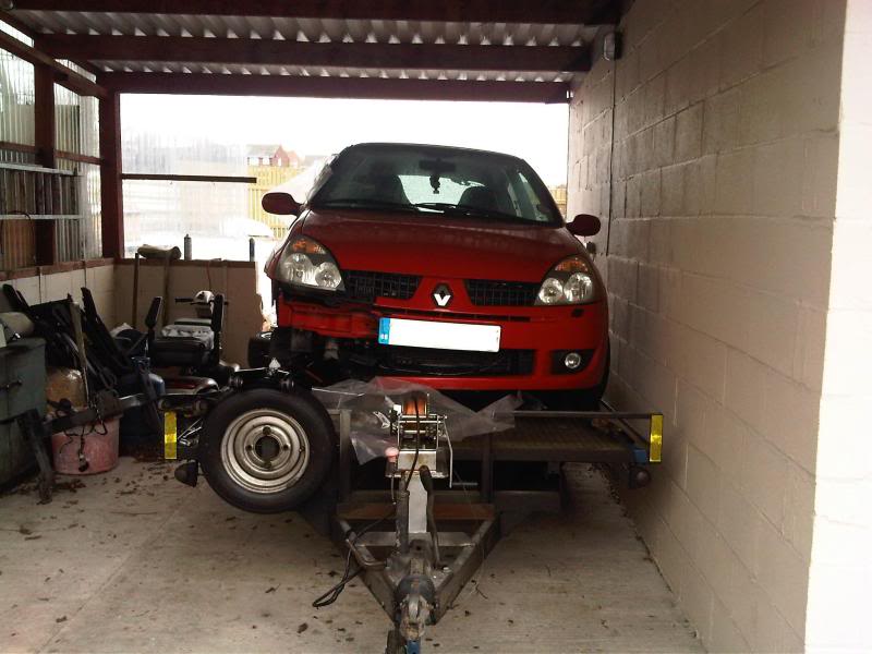

Finally managed to get myself a 182 after years of wanting one. Never thought i'd be lucky enough to get a Trophy.
Found it on a salvage site that my dad was using for work and pursuaded him to get it.
Its no. 400/500 and needs a bit of work lol.
When i first got it home

welcome Deb. Damage doesnt look to bad from the pics, just bumper and wing, cross member seems ok?

Welcome to the club. Car doesn't look too bad. Well done for saving it. Don't these normally get torn to shreds at salvage yards.

I think there may be damage to the bulkhead area where the wing is cracked i'm guessing that'as why the door isn't shutting.
Hopefully the shunt hasn't travelled through the shell and twisted anything.
Check the roof aperatures where the doors open, there's a good chance it could be kinked in there if it is then there may be some serious damage to the shell.

Was the Trophy a breaker or a write-off that you know of?
Good catch anyways...
Get it aligned on a jigg.

Thanks, will do :) it looks like there is a slight kink just above the door. My dad reckons it should be easy to sort though

Thanks :) its a cat D write off. Think its going on the jigg sometime next month

Lols thanks for lettiing me know about the kink, I thought there would be. Even worse on the sunroof models.
It only takes a slight knock on the clios are the front and the edges of the roof go.
I'm an Assessor so if you have any question fire away or PM me. Cheers.
