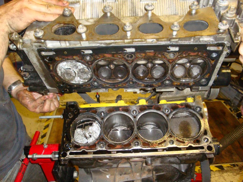

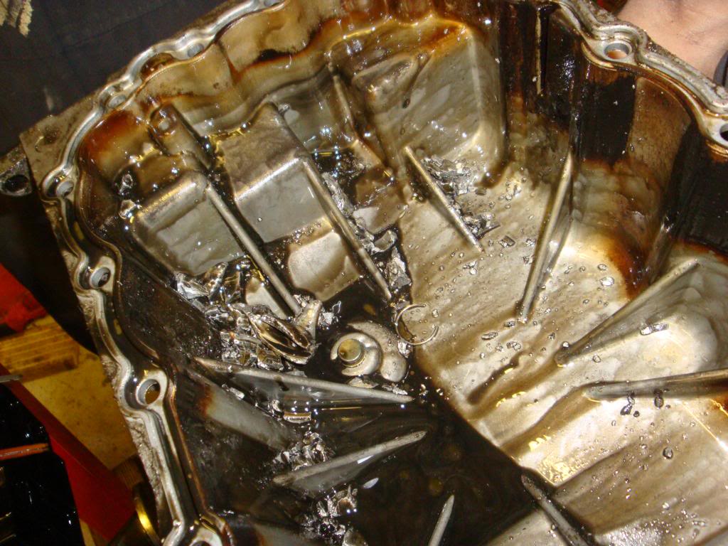

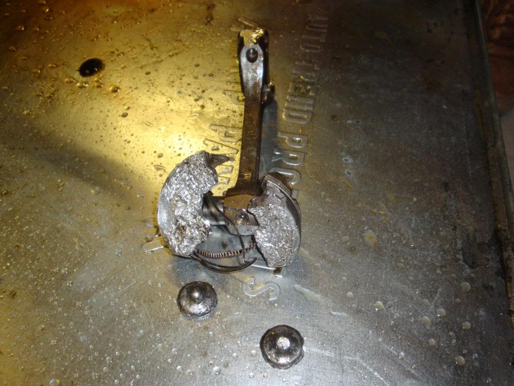

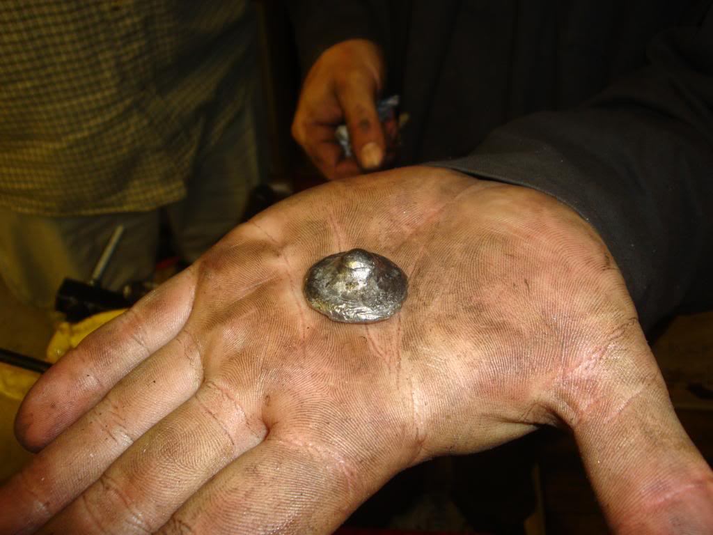

If you've managed to watch the video from the tintops race... you'll see that we had to retire. This is why:
We're still not totally sure what the catalyst for the failure was; the symptoms were that we had pretty high coolant temp, but nothing boiled off. We also had good oil pressure and didn't lose any oil leading up to the failure. Has anyone had anything like this happen to them before? We're running a standard engine with the factory ecu, so nothing fancy going on inside.
  AB182, Audi A5 3.0
dropped valves is a known problem on f4r engines, its happend to a few on here for no reasons at all (ie someone was on cruisecontrol on themotorway and it happend)!
