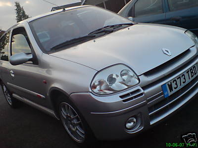

I never meant to buy a 172 to build into a rally car, although I have always thought about it for years. I was actually looking for a Metro GTI on ebay (told you the budget was small!), and thought I'd do a search for a 172. Anyway, I ended up winning this:
My mate collected the it for me today, and it was the first time I'd seen the car. Apart from the damage to the engine, detailed below, its in really good nick!

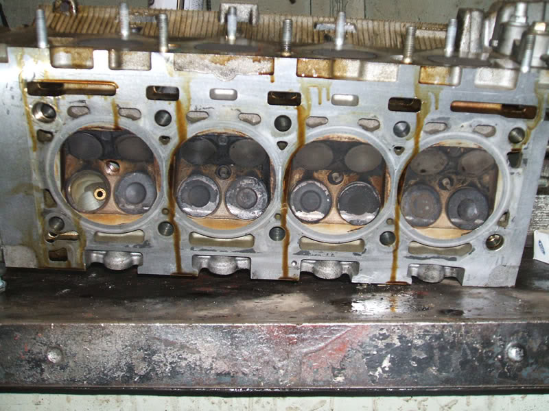

The cambelt had snapped, and the previous owner was told he needed a new engine. The head was in the boot, and has been partially stripped, so we dug it out and checked it over.

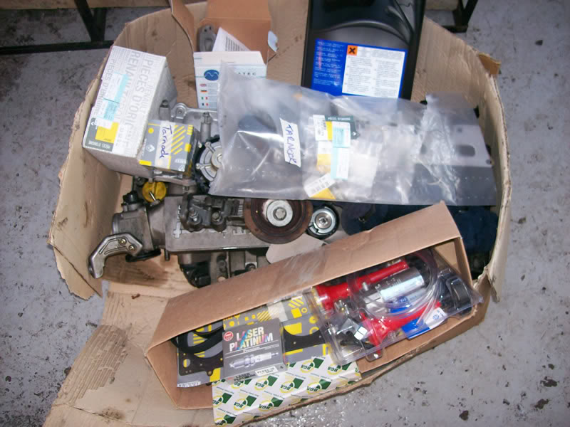

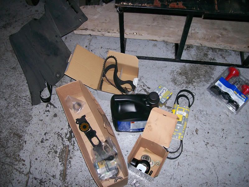

The pistons are all fine, and on closer inspection of the valves, only the 8 inlet valves apear to be bent. I am going to change the exhaust valves as well, as a precaution though. All the bits to repair the engine have now been ordered, and when the new valves are lapped in the head will be sent off to be skimmed and pressure tested. Then the hard work will begin! :)

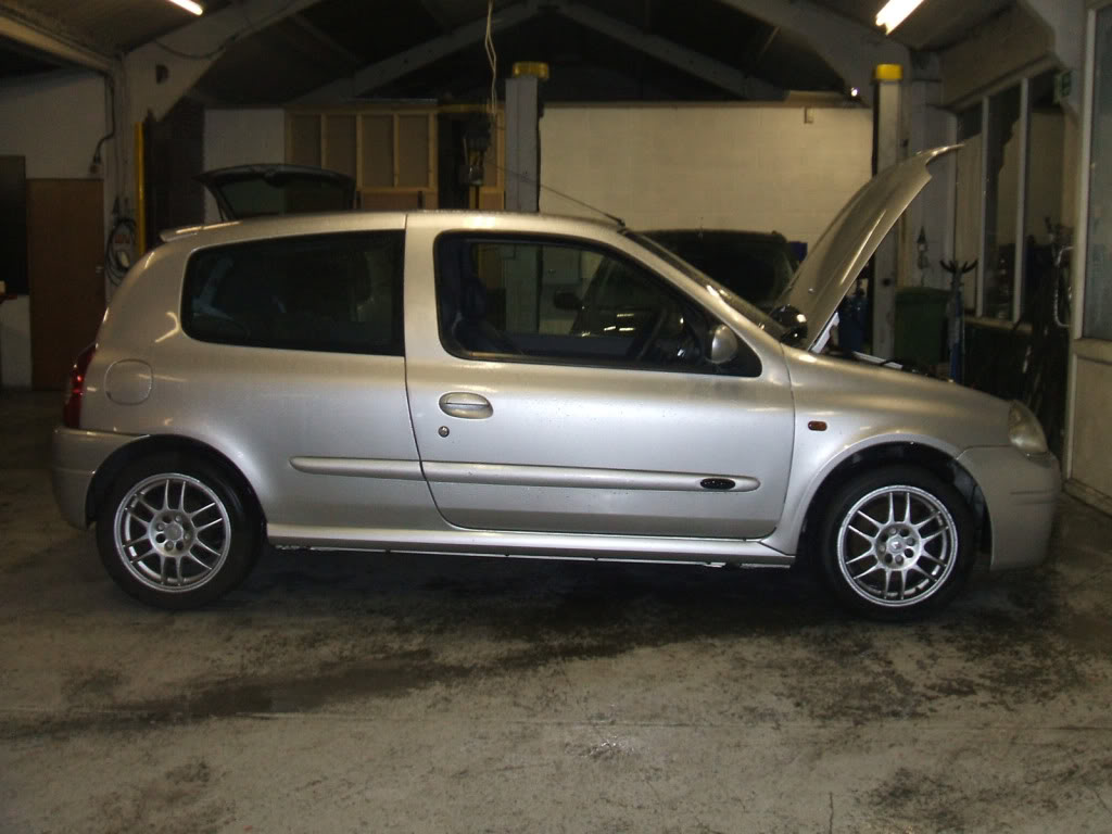

As it stands now, unaware that its gonna be ripped apart, and thrashed!

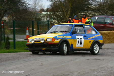

Oh, and my last couple of rally cars:

  Whichever has fuel
That fiesta was on ebay not so long ago!! I was going to bid on it!

the picture of the head with the valve on the left had me baffled for a bit, until i realised the valve wasnt there lol
Yeah, I saw it was back on there. Must have been the guy that bought it off me. He was a bit optimistic about the power output though... It made 135 at the wheels when I had it rolling roaded. The fester was my first rally car, and was good fun to build. It crossed my mind to buy it back... Cheap for £2500!

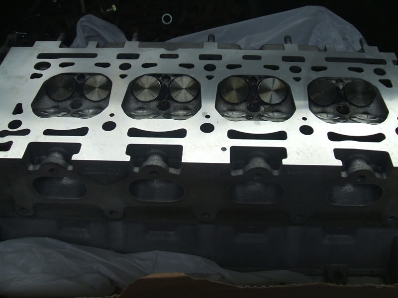

Wel today, bits to repair the engine have been turning up, and I've lapped in 4 of the new valves, and got bored! :boring:
Tommorow I'll get the rest done, and fit the new valve stem seals, and refit the valve springs and collets, so that it can go away and be machined and pressure tested. I'm well impressed with the inlet tracts on the head for a standard engine. The manifolds need matching though, so will probably get these done whilst its in bits.

The head is back from the machine shop and looks all shiney and new!
Was hoping to get it back on over the weekend, but the head bolts are wrong! :banghead:

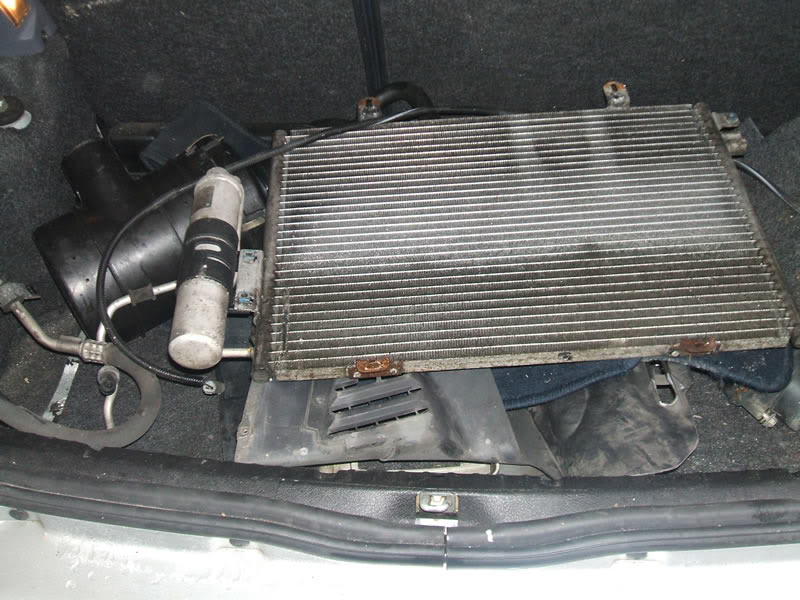

So, instead I've started to strip out unwanted parts.

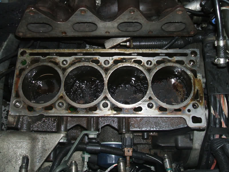

Came down with a bad case of man flu on Wednesday, but I'd already taken the day off, and the next chance to work on the car for any more than a few minutes at a time will be Christmas. So, I ploughed on regardless... :dead:

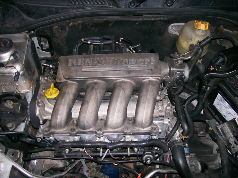

Started the day at 8:30 am (did I mention that I had the flu?!) with a big pile of bits.
And slowly put them all back togeather. Only ended up with 1 spare part in the end, a plastic pipe holder for the now removed A/C system. Not bad as I didn't take it apart!
So I got it back to the point where it should run, reconnected the battery and span the engine over with the coil pack unplugged to get the oil ways primed and the tappets pumped back up, reconnected the coil pack, crossed my fingers and span the engine over....
And bloody nothing happened! :mad:
A quick check showed no spark, and at that point I noticed the immobiliser light was doing its nut. So after 10 hours straight work, (I had a really bad cold by the way. I nearly died!) the car still didn't run. :(
I'm really keen to get this boring part of the project over with, so I can document all the more interesting things that I'll be doing. However, I have a key bloke coming on Wednesday this week to try and recode the 1 key I have, and I have another spare key on order from Renault that should be with me by the weekend, so fingers crossed I'll get to hear it run this week!
