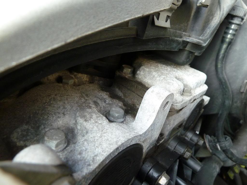

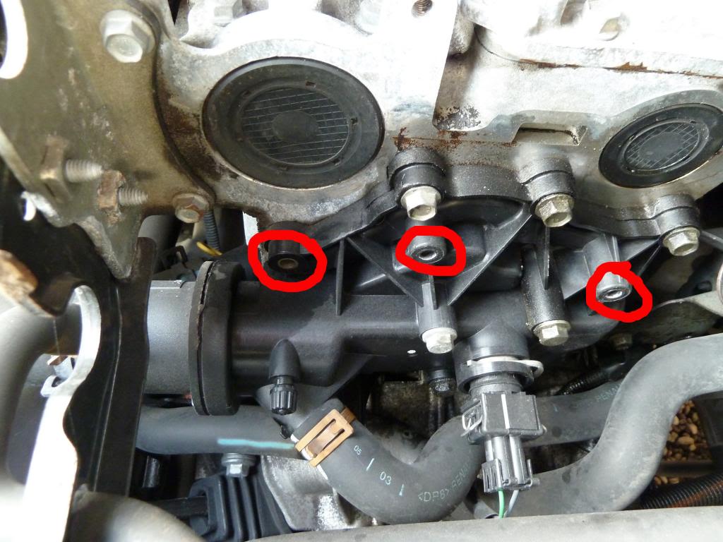

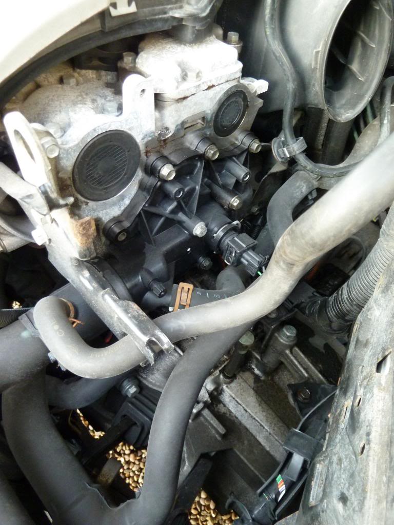

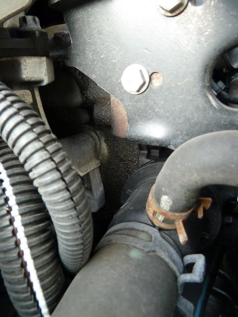

The oil leak looks to me like a winning combination of the cam plugs, but even more likely the thermostat housing. You can see the extent of the oil leak around the housing, a little around the upper seal on the rocker cover area (breather plate?), but also worryingly around towards the front of the engine, though I think it might have sprayed that way out of the front of the thermostat housing sealing area, if it indeed it also carries oil as I've read on other threads.

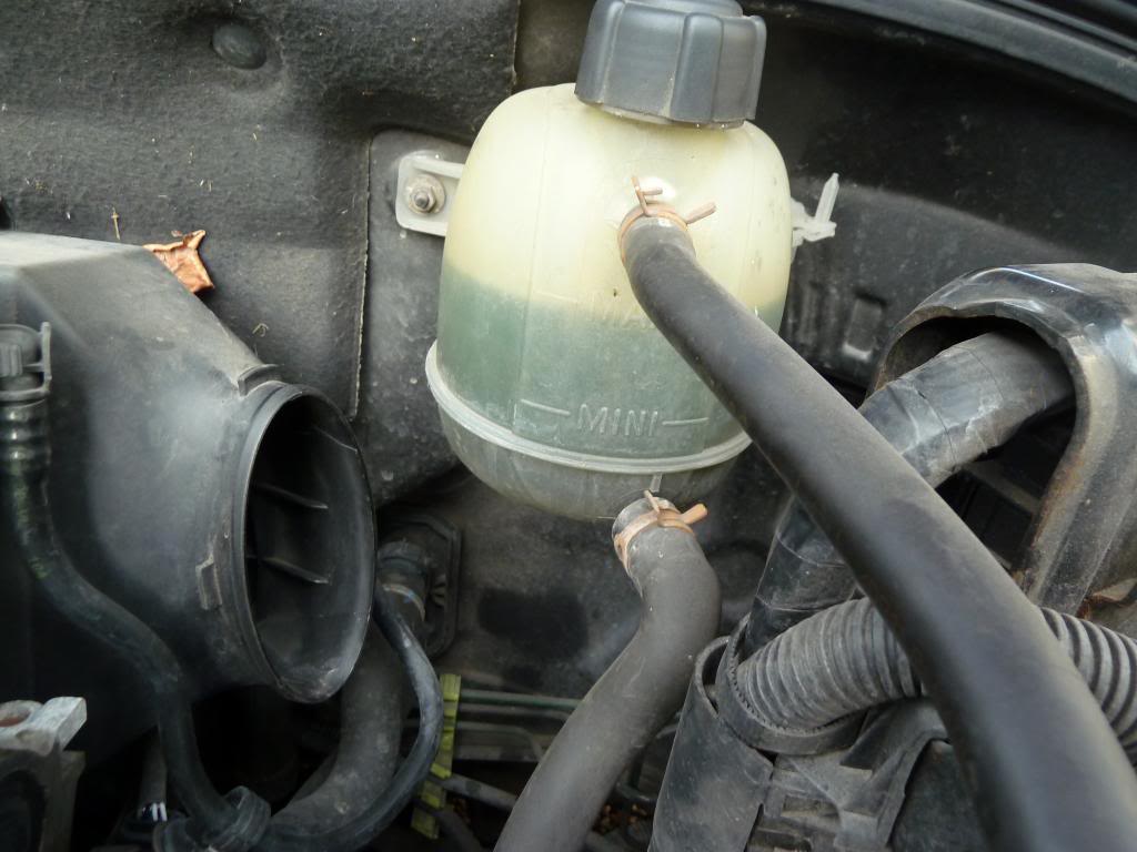

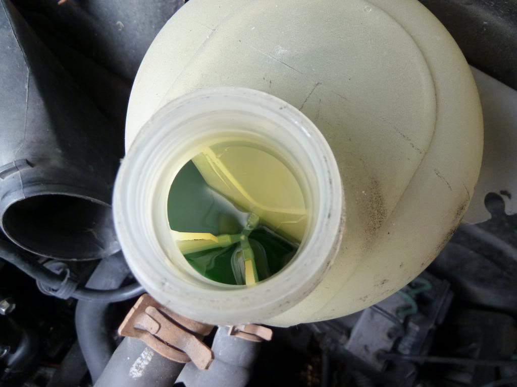

It looks to me like at least one bolt is missing from the thermostat housing, though possibly more (see picture). What also makes me think the housing is knackered, is the colour of the coolant... (The oil appears to have no mayo, thankfully).
Should there be more bolts there? Change of thermostat housing required? Are the bolts available as well? etc.
