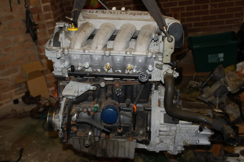

How...? Ive been trying to fit a 172 engine in but for starters i cant get the engine crane to hold the engine properly without it swinging out of alignment and then it doesnt look like theres enough room. Is there any certain ways that it has to go in?

no a clio mk2 ph1 If i have it so that the pulleys and belsts arent getting trapped or subbin on the side then the gearbox doest fit past the other side

Yeh all the wiring is out and the gearbox mount is not attatched to the car. the side of the gearbox though is catching on the sides of the engine bay and there is no room on the other side as the pulleys and belts are touching on the healight surround bit

you got the engine and box hanging with the box end down?
engine \ box (if you get that!)
like this, but with the box hanging closer to the floor

No, on the engine there is only one of them pick up points so ive been having to wrap around the box to pick the other side up so if anything the box side is higher. Is it only Ph2's that have the other pick up point?

you're just missing the brackets then, hook the belt under the plenham or throttle body or something! the engine has to go in with the gearbox lower than the engine, otherwise it won't fit, once the gear box is past the passenger side chassis rail you're laughing
