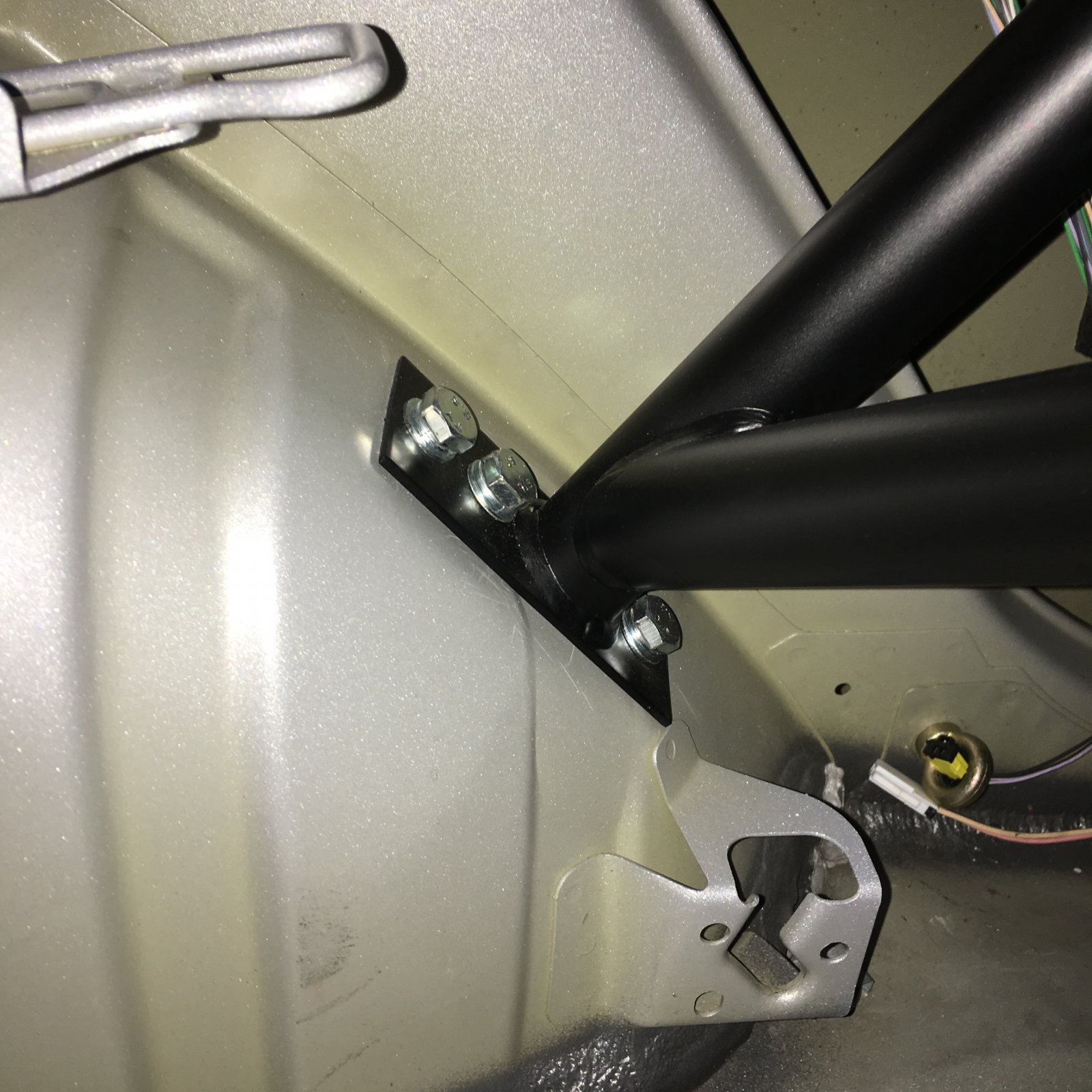

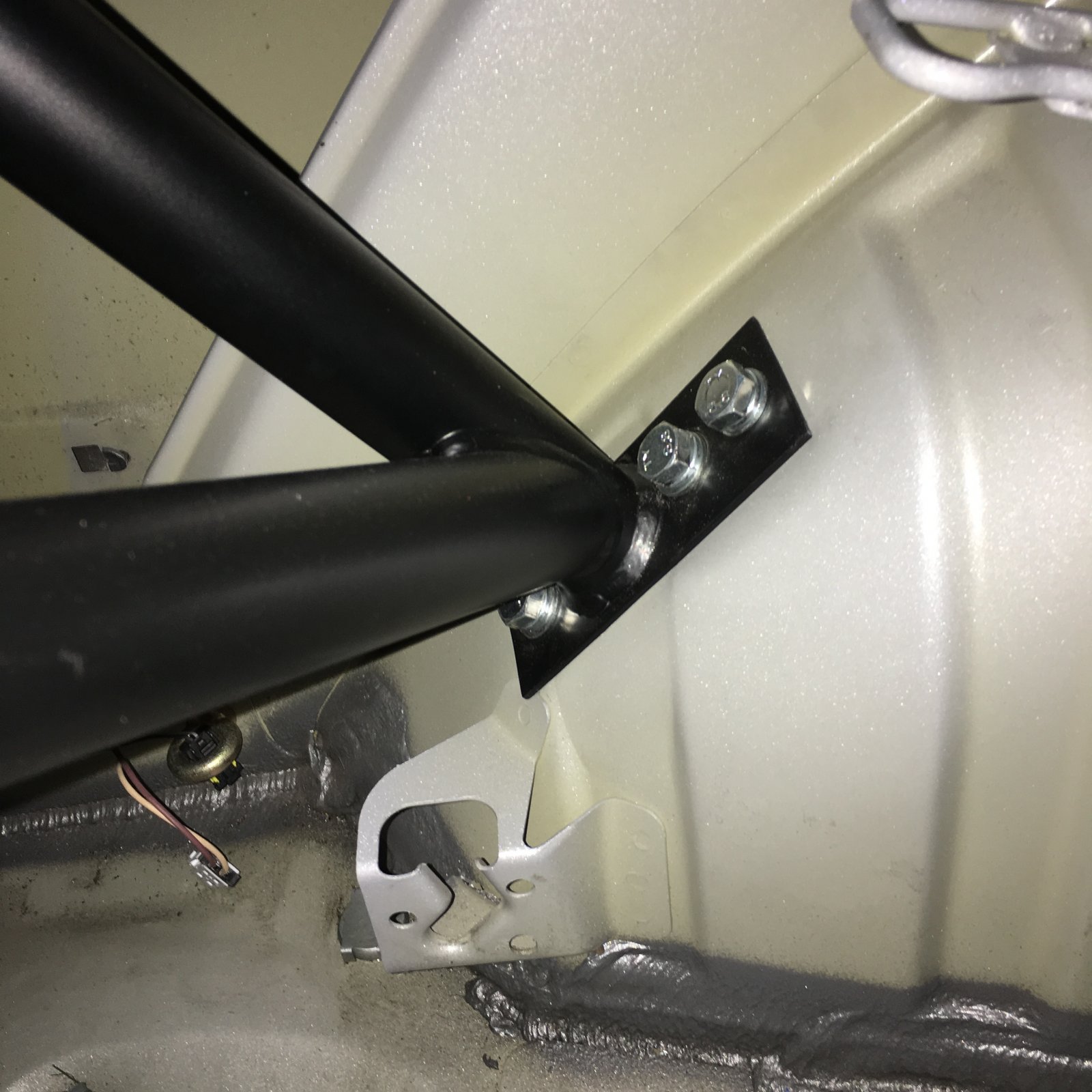

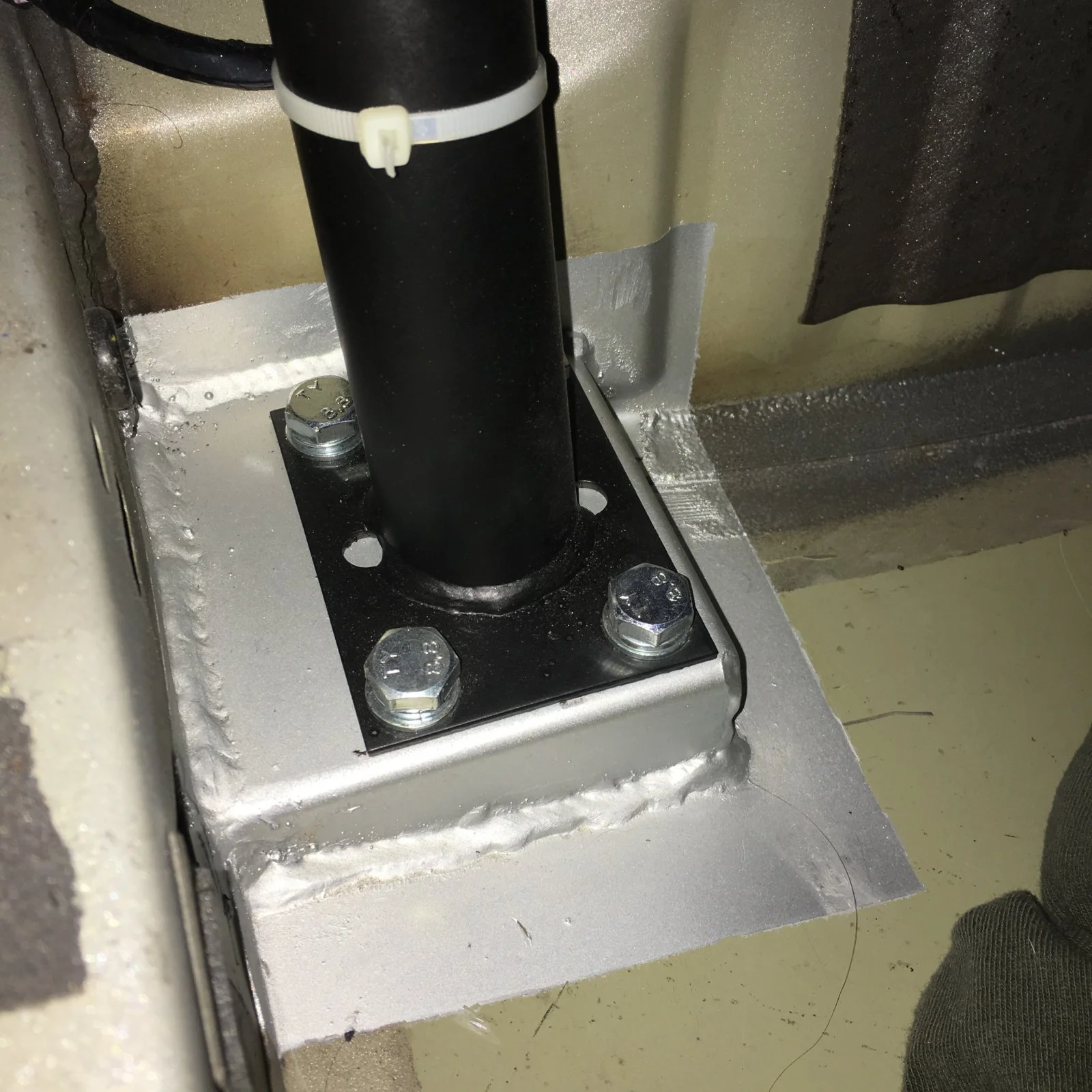

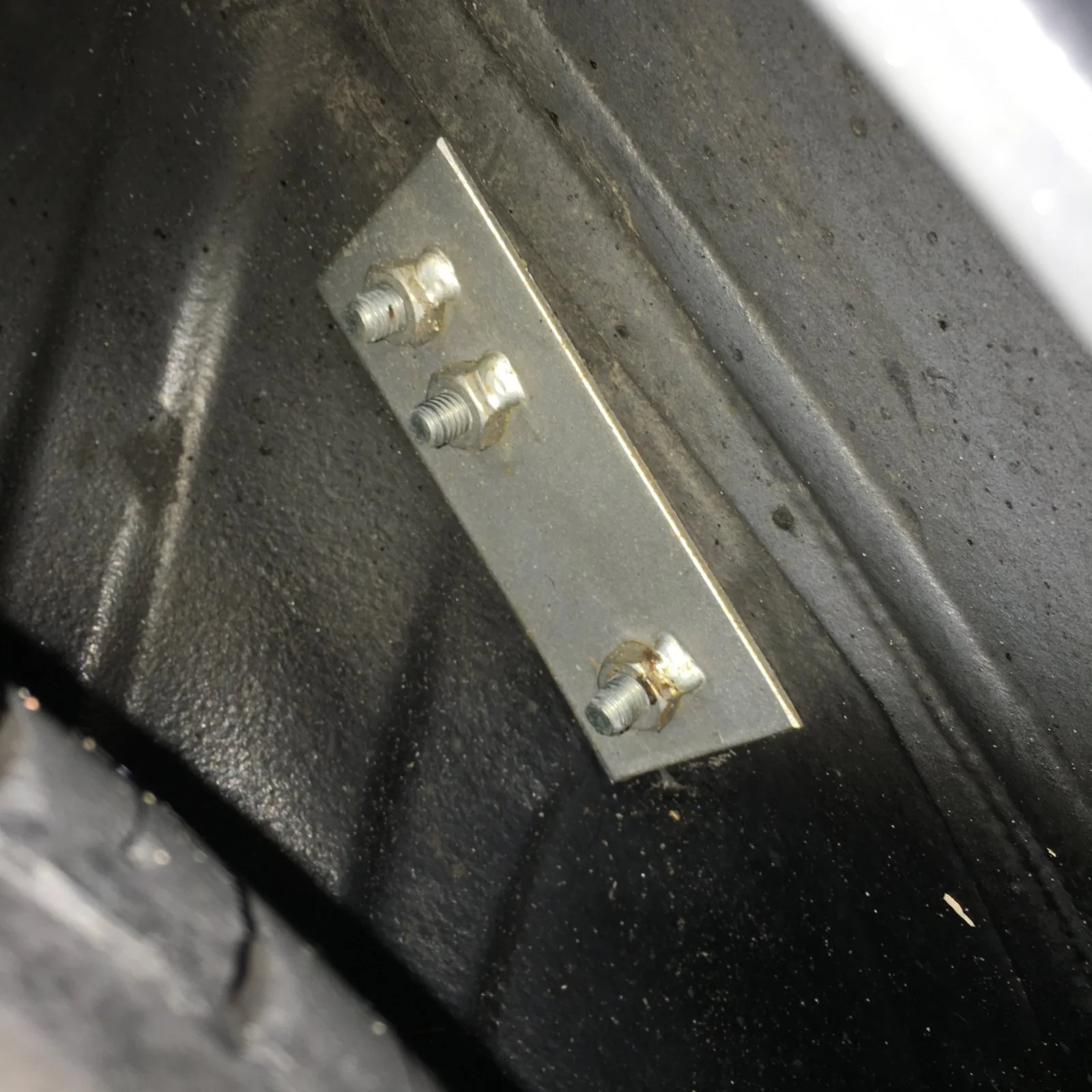

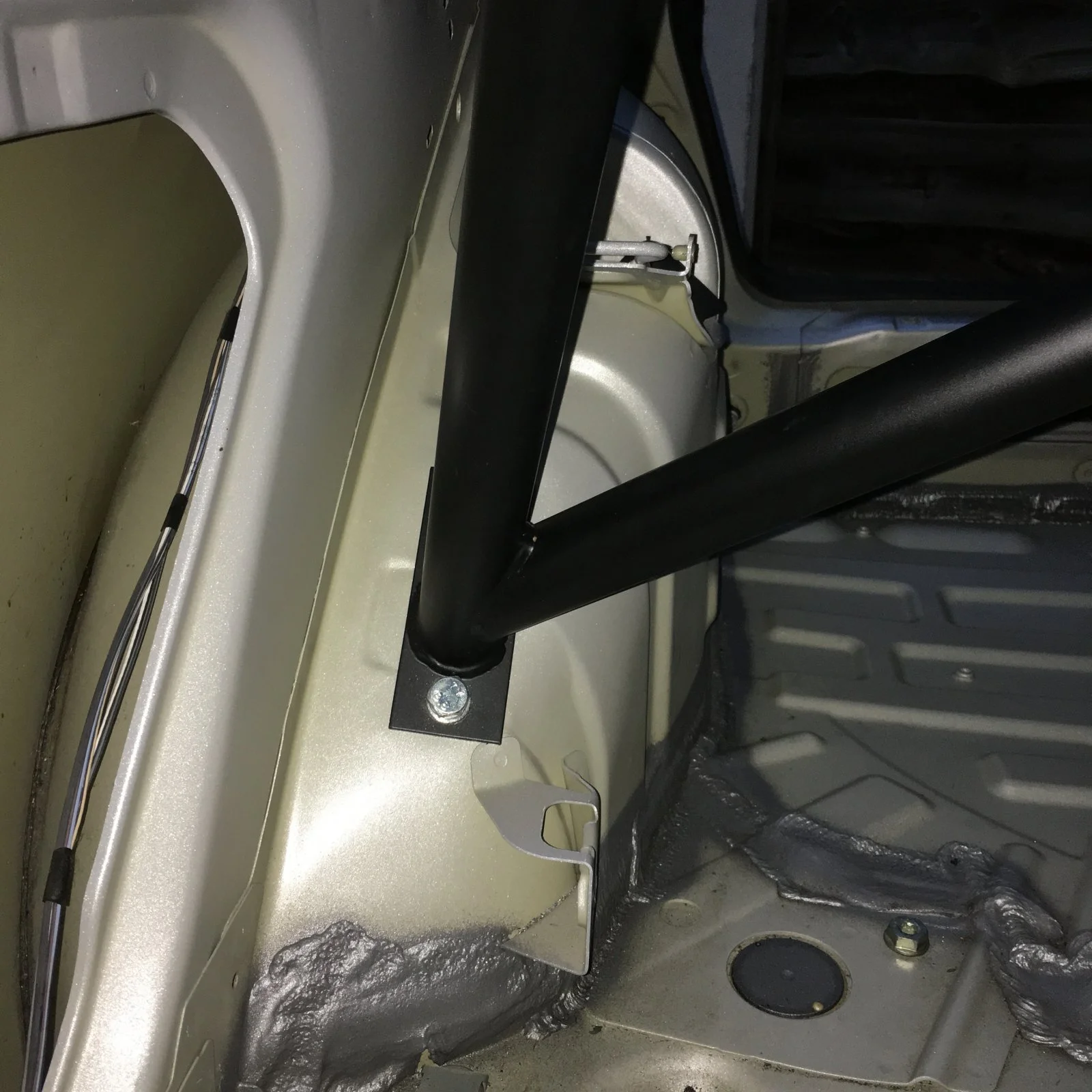

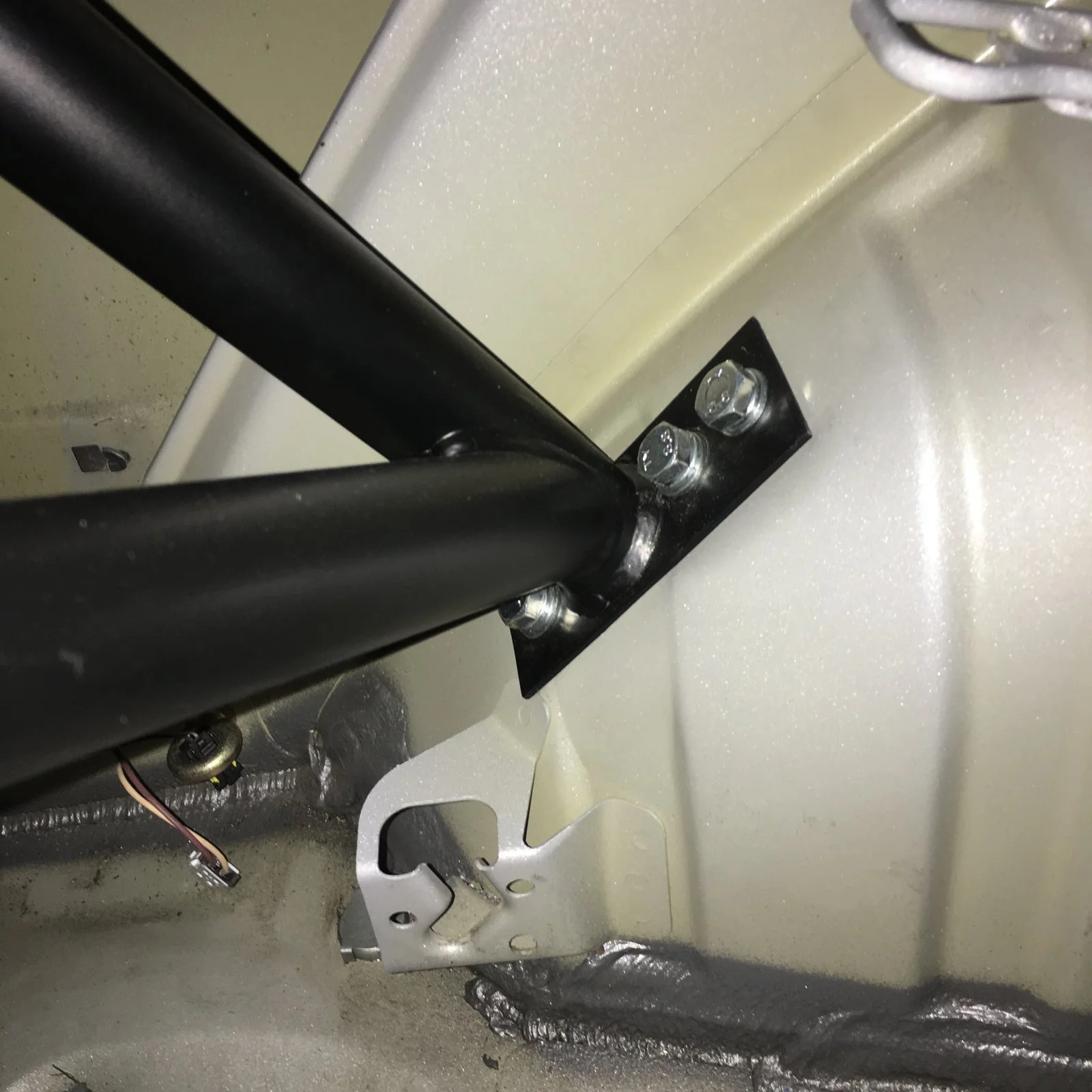

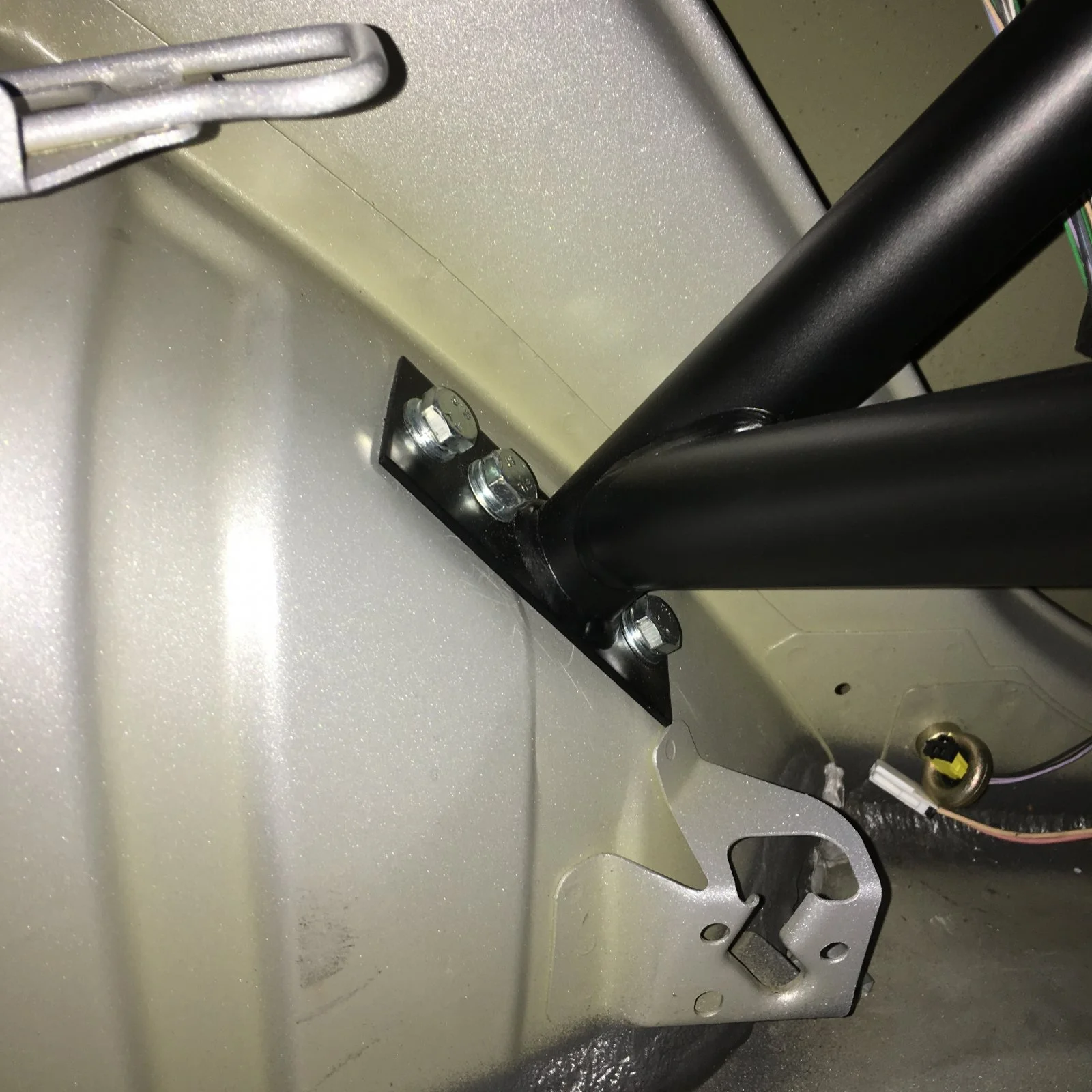

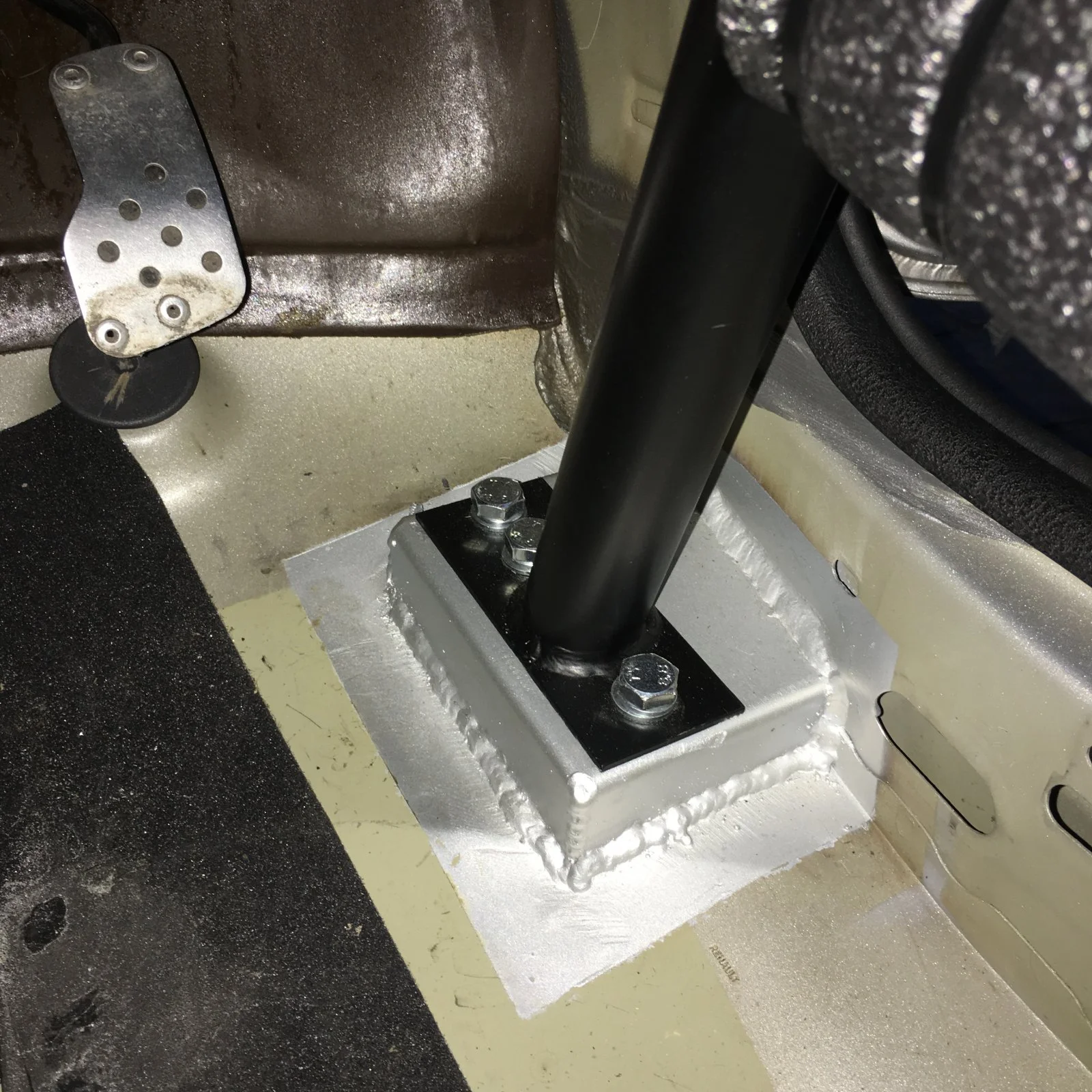

Hi
You don't happen to have pictures of the cage feet do you?
I have a rear safety devices cage from Mark Fish and fitting this weekend, would be good to see another fitted first!
Cheers
I'll get some for you, I'm getting the same photos for someone on the facebook page already lol.

Hi
Cheers

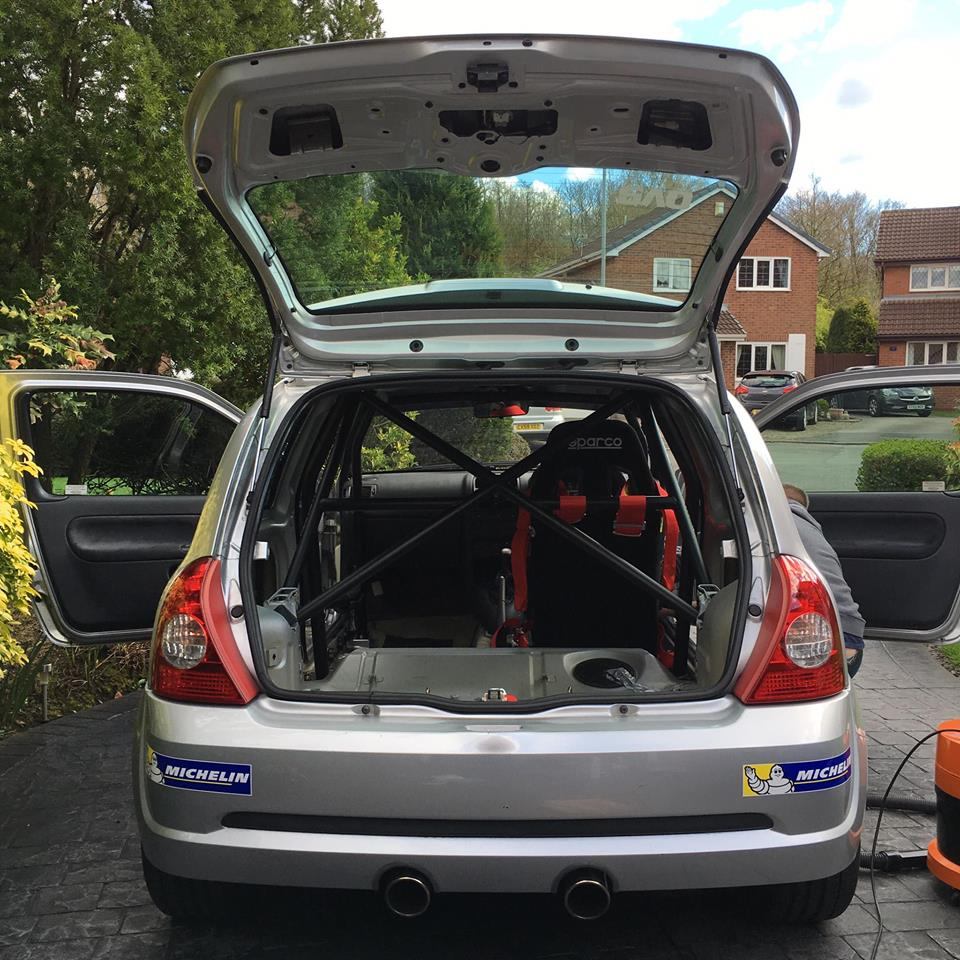

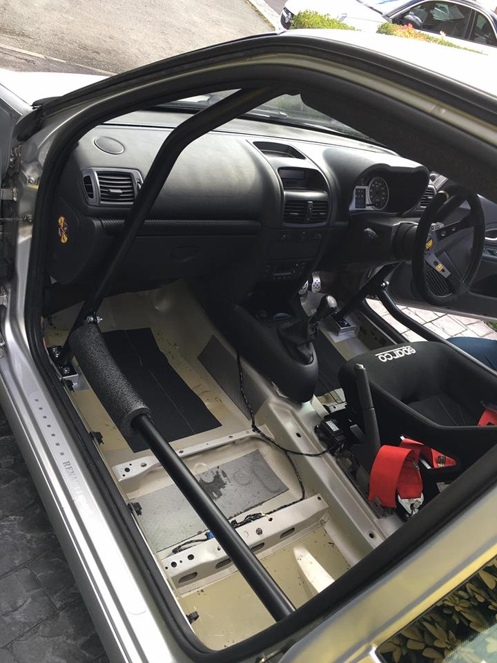

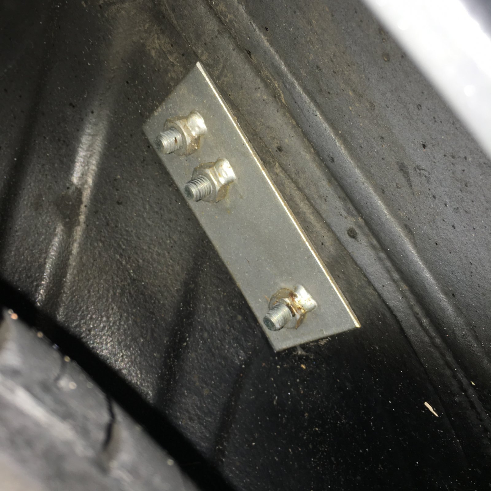

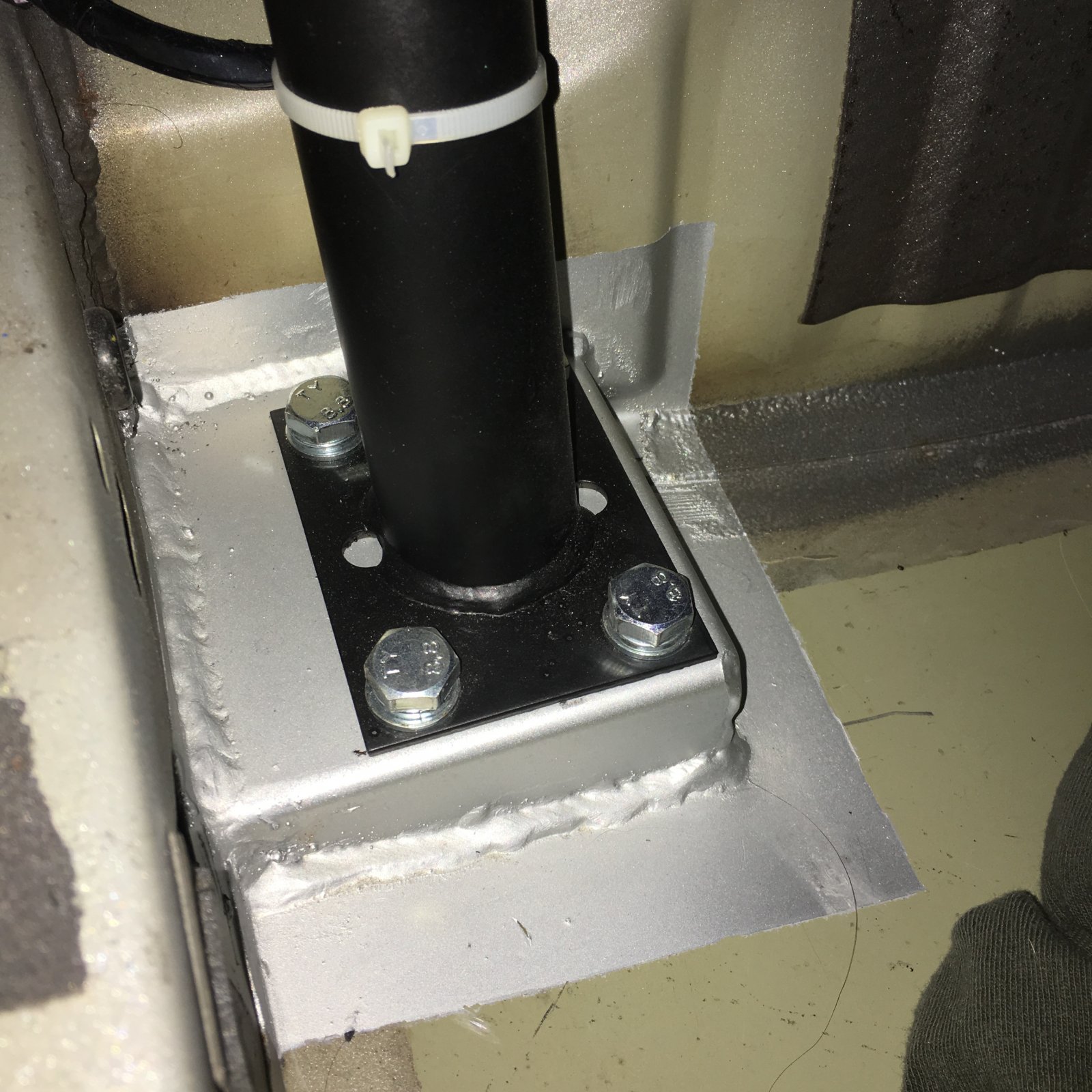

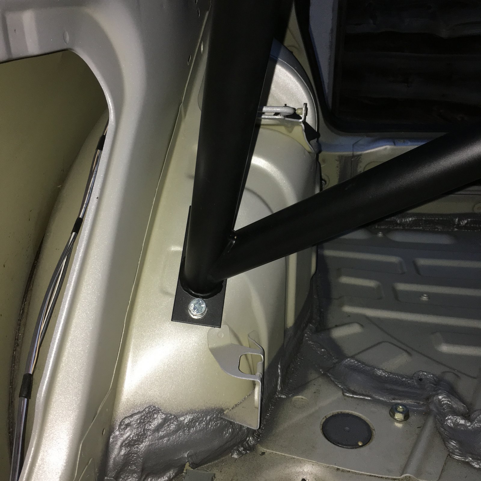

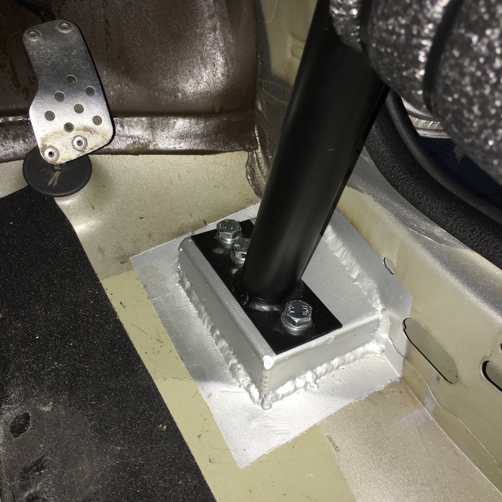

As promised.

Just on the hunt for a welder in my area that will weld plates for my rear, bolt in, half cage.
Only 4 places to bolt, 2 on the wheel arch, and 2 in the footwells behind the front seats
Do all 4 need 3mm welded in steel plates to fix too, or just the 2 feet behind the seats?
Any pics of these footer plates welded in would be useful
Am looking at 6inch square, 3mm steel?
