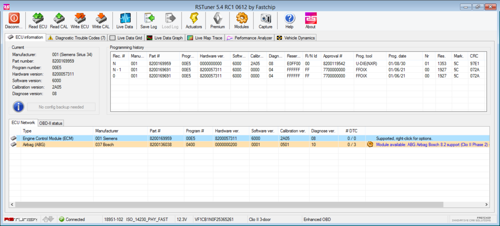

I've got this;
charltjr
Where are you seeing that?
To get your unlock code you just send the key from the "about" box in RSTuner by email and they send you back the unlock code. If you've send them a screenshot of the ECU information too then you'll also be sent the map you want.
