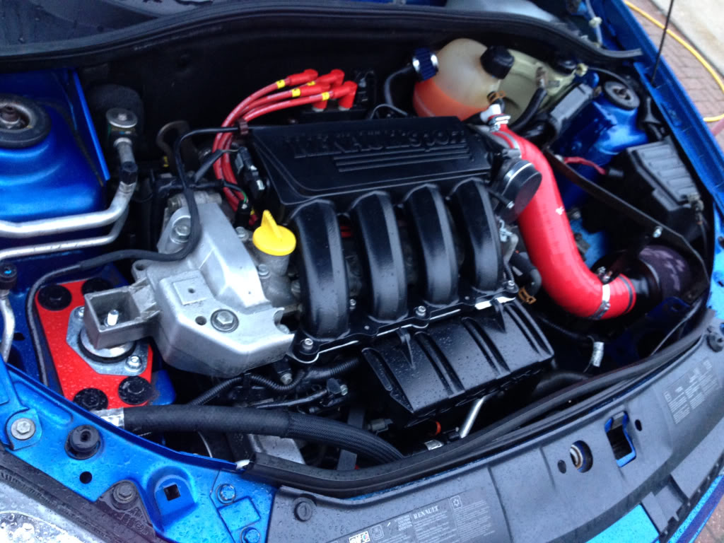

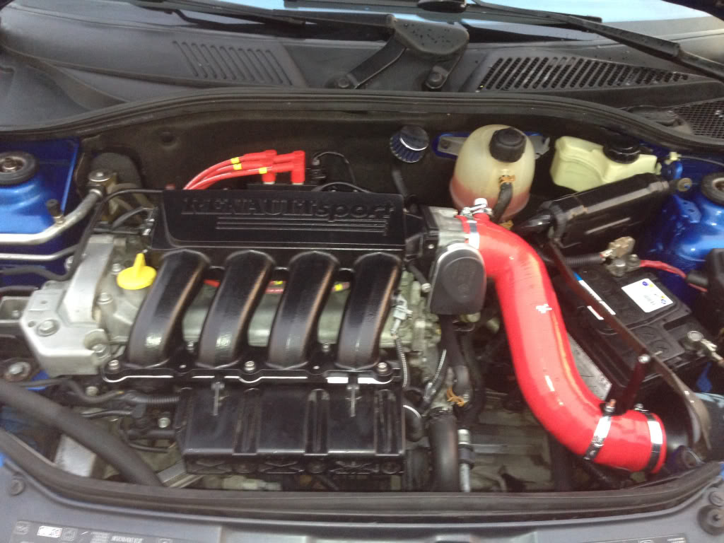

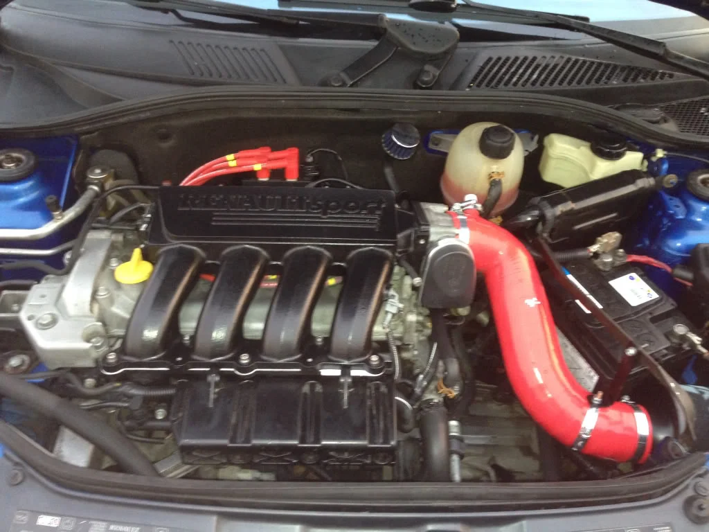

Had a good chance to get some work done this weekend with a good mate of mine Dom Narf cheers for the help mate. Managed to sus out that my car was running on its cold man so fitted a new CTS (coolant temp sensor) and thermostat at the same and flushed the jiz looking coolant out and filled it with some lovely fresh red stuff haha. Swear that coolant had never been changed from factory it was minging!! Didn't fancy that freezing and cracking my block!!

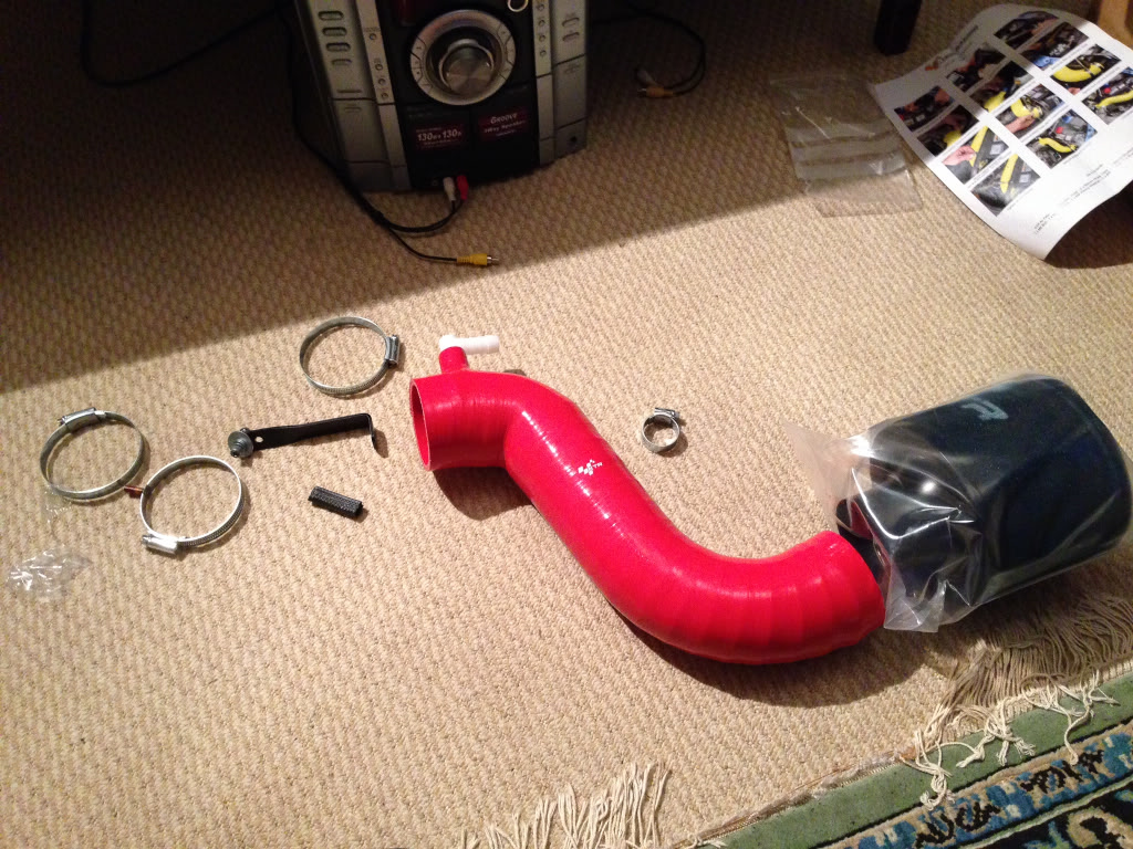

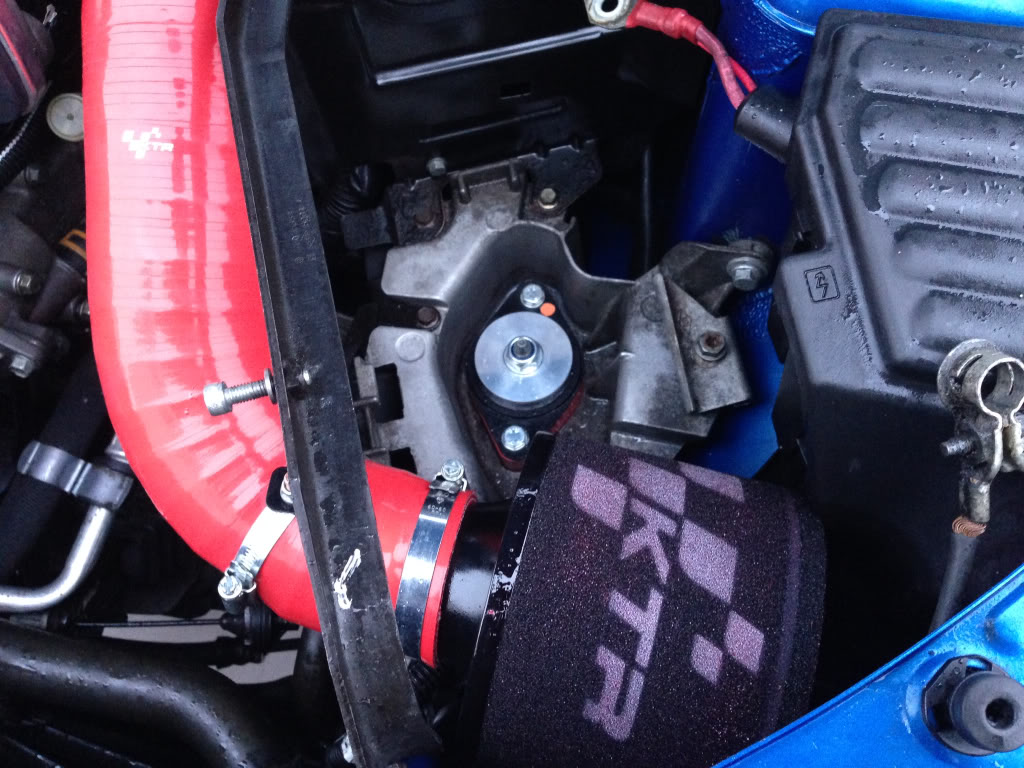

KTR induction kit looks nuts and sounds well probs does nothing for performance! Ah well it's worth it IMO lol I reckon when it comes to a custom remap and RSTuning that will benefit it.
KTR 2.5" decat to tie the "Ultra" performance exhaust up just nicely!!

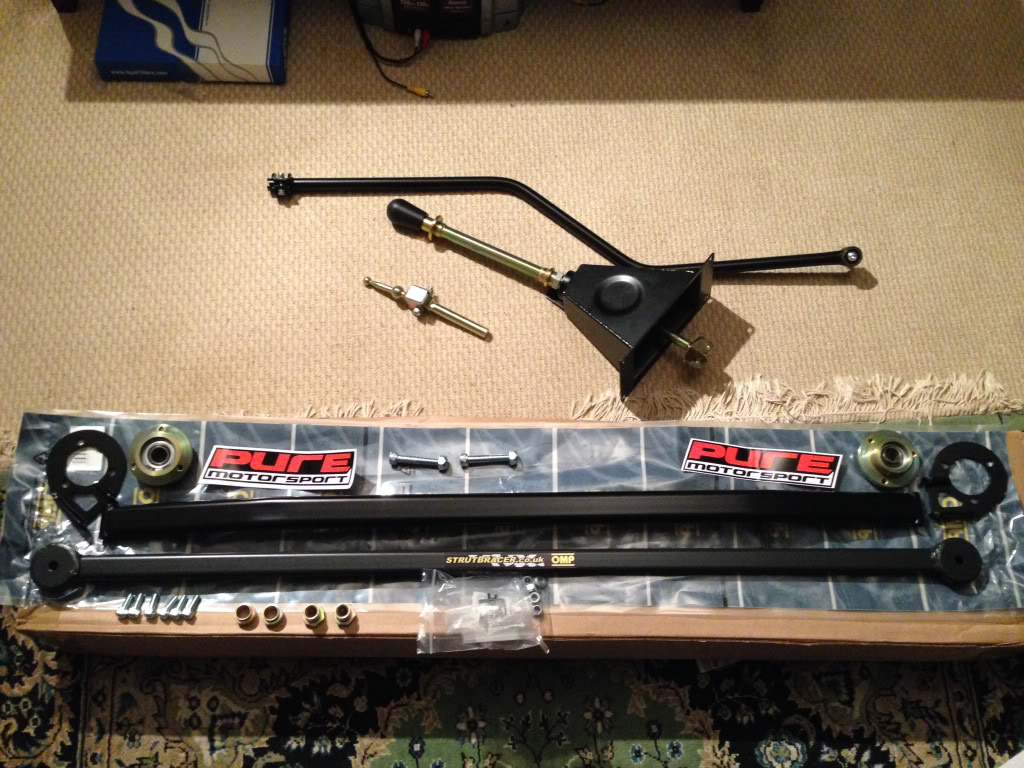

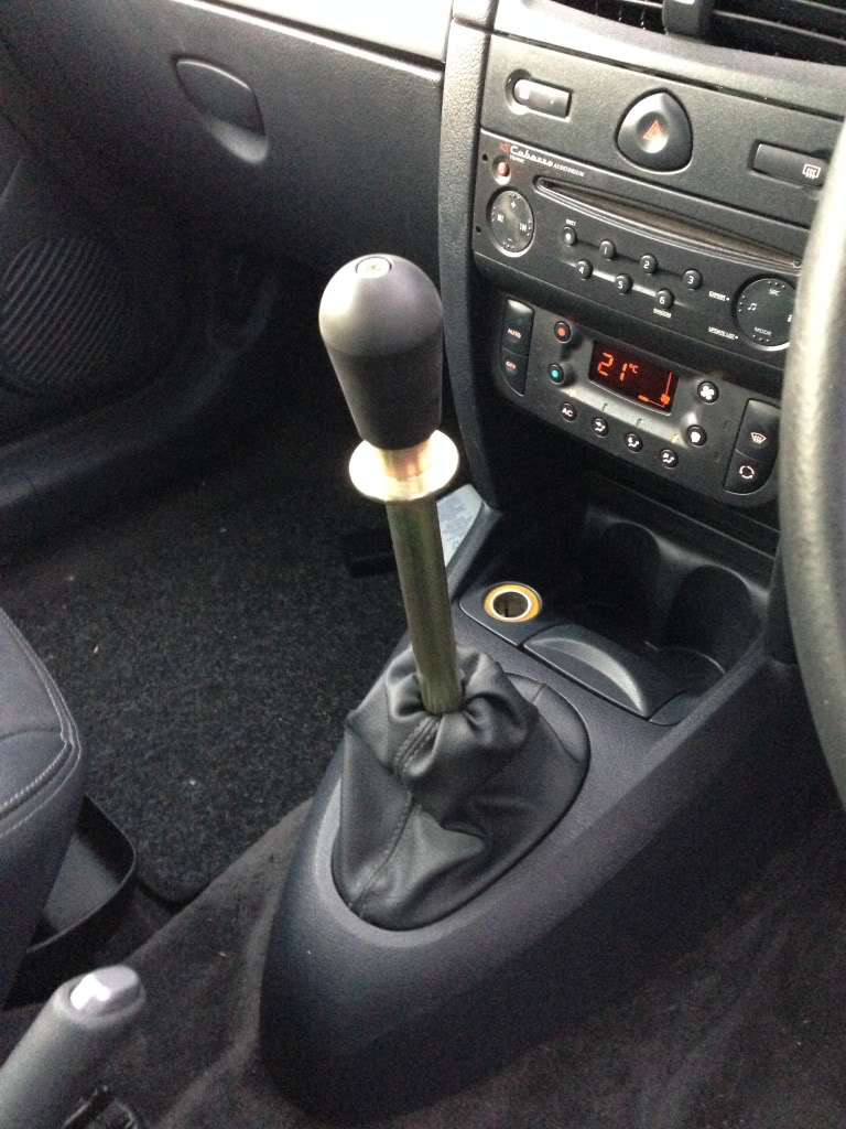

Pure Motorsport Gear linkage fitted! One word WOW!!! Feels nuts and looks nuts!! Transforms the the feel of the car!!
Just waiting to fit strut brace and solid top mounts :p

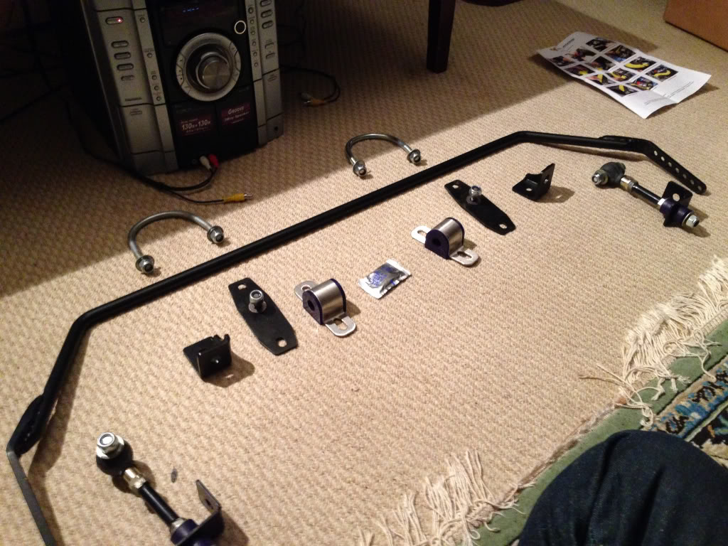

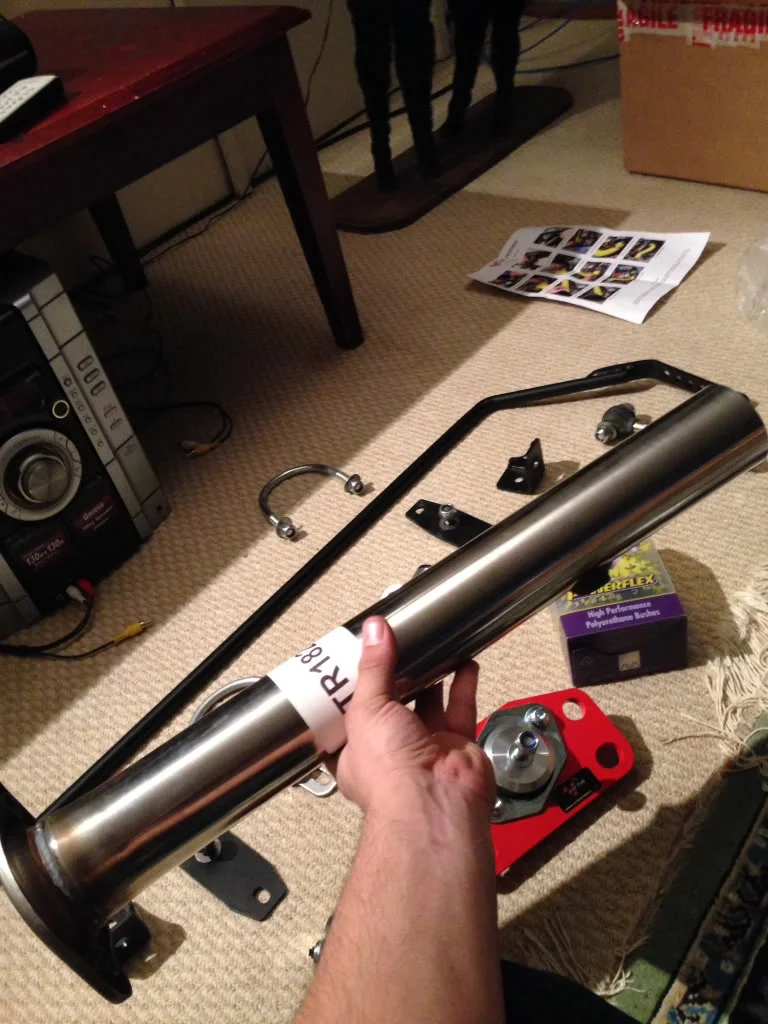

Anti Roll Bar to fit.
Solid top mounts to fit.
Powerflex Gearbox lower mount to fit.

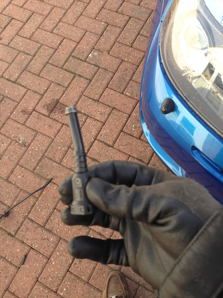

Ohh found out why it had the elusive "Random misfire" no4 injector was working but at like 75% so sacked that off and she's sweet now.

Where is that ARB from?
Track developments. They did a custom build order like 3 year ago. A chap on here never fitted it so sold me it! Was chuffed when I received it. Right piece of kit the adjustablity is nuts probs too much lol and build quality is great. On rose joints and powerflex bushes. ;)

Never seen one before. Looks a lot better than the Whiteline one.
  CLIO 182
Re: Newbie from Yorkshire! Clio 182 Full Phatt
That's what I thought too mate. These aren't meant to rust as bad either haha which is a bonus. It's the little things which make the difference. All stainless hardware and built buy a reputable chassis and suspension specialist.

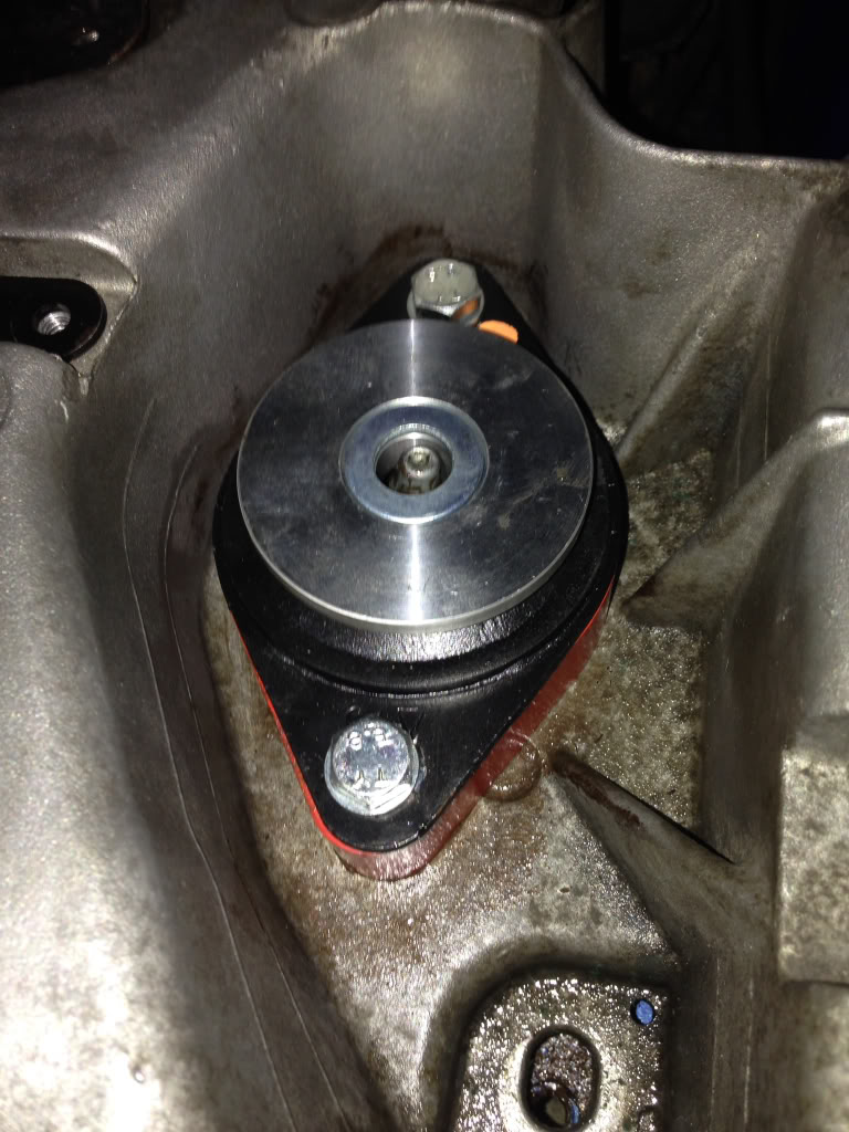

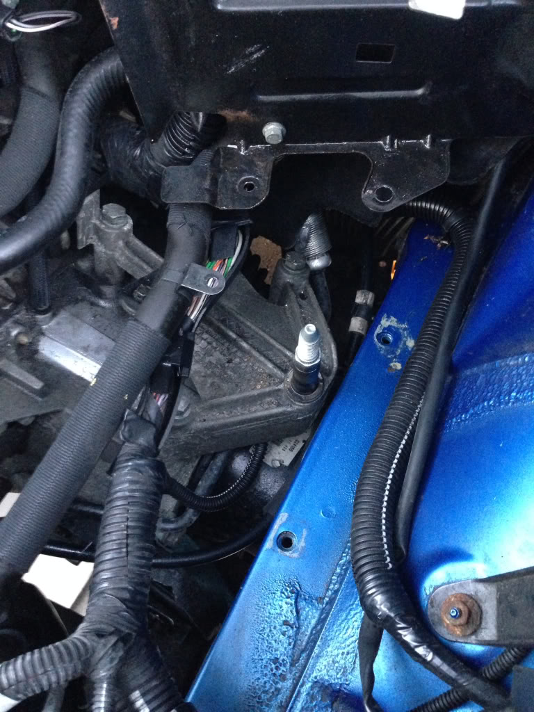

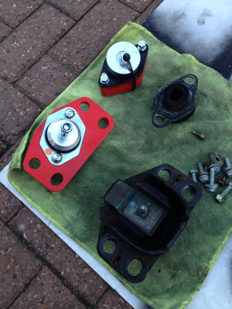

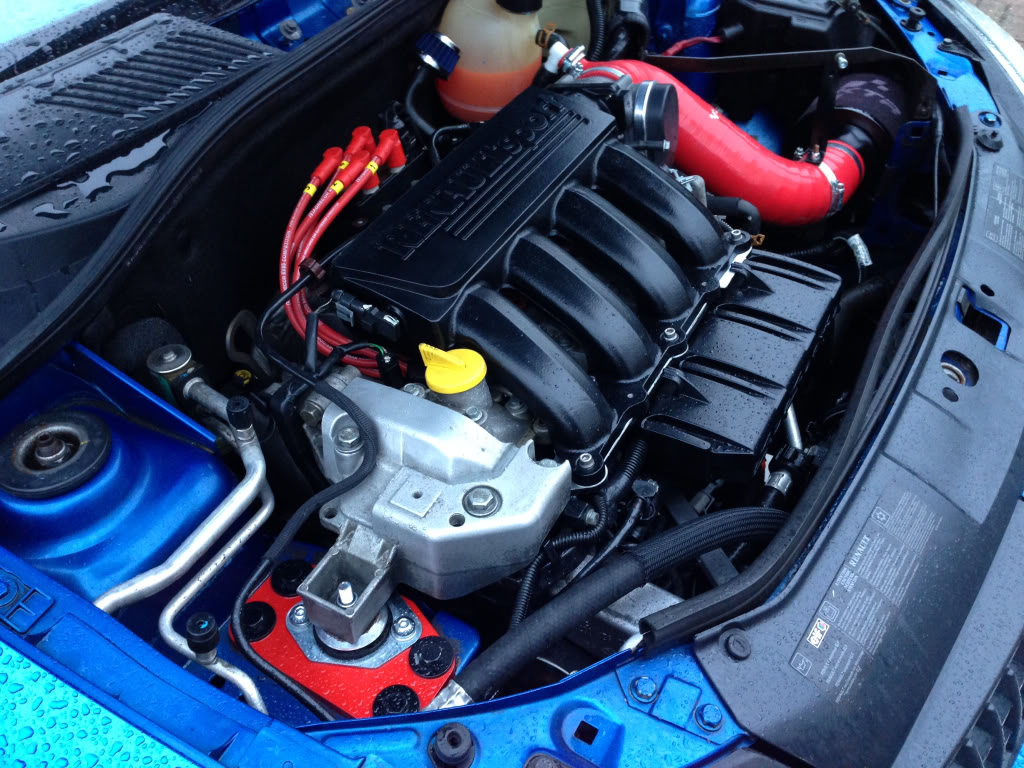

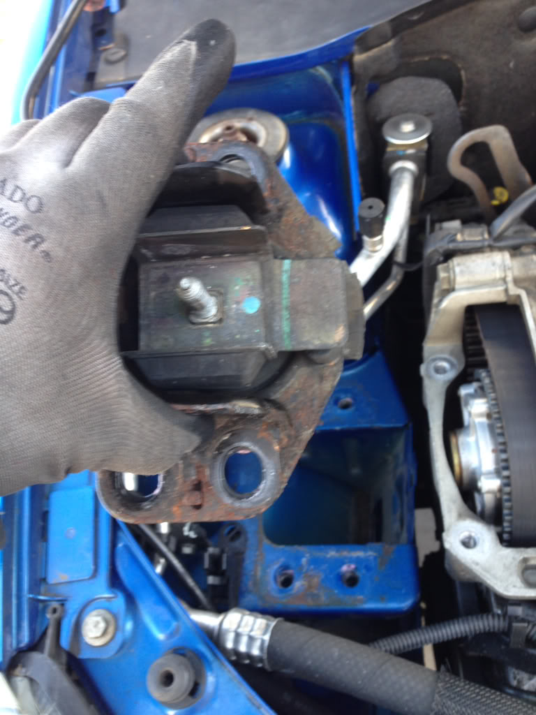

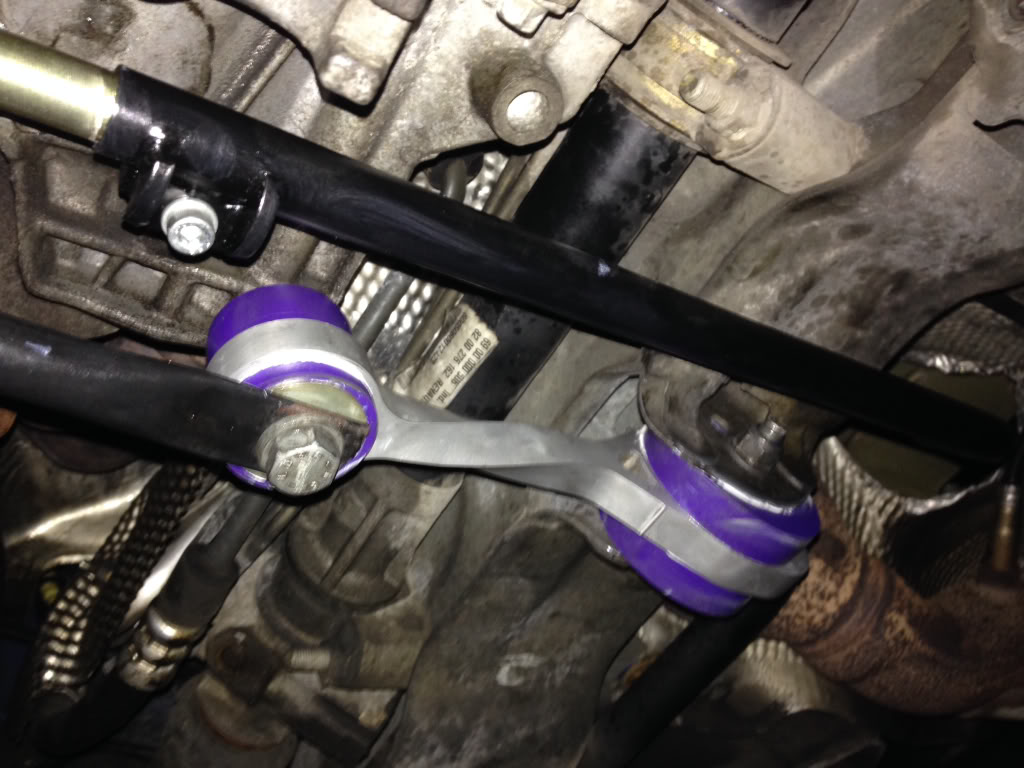

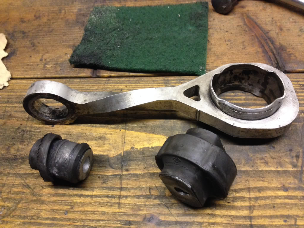

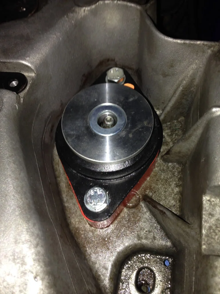

Finally got around to fitting all new uprated engine and gearbox mounts and twisted dog bone mount. Engine and gearbox mounts from vibra-technics and lower dog mount was powerflex. Absolutely transformed the car and whoever says the vibration is unbearable IMO is absolutely being a little girl. Slight and I mean slight dash rattle on tickover but as soon as you rev it, it goes only really notice it when it's cold tbh.
not sure if its common with these mounts but found I had to die grind away some of the gearbox mount away to get it to slip over the stud little frustrating but went on okay after this the paint was making an interference fit was like 3/10th of a mm

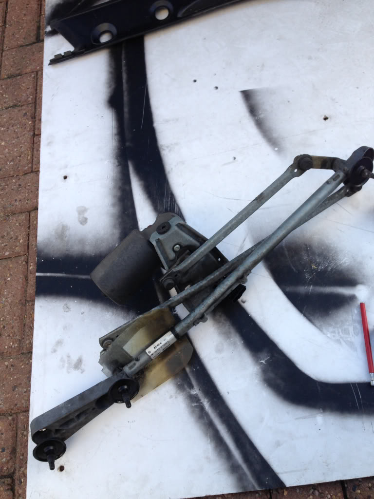

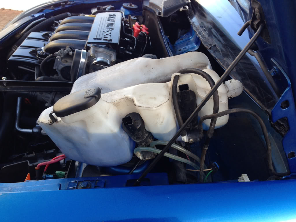

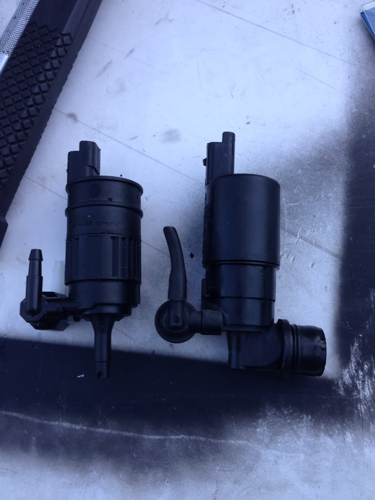

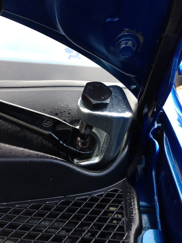

Also had right bloody mare changing my bloody windscreen washer pump

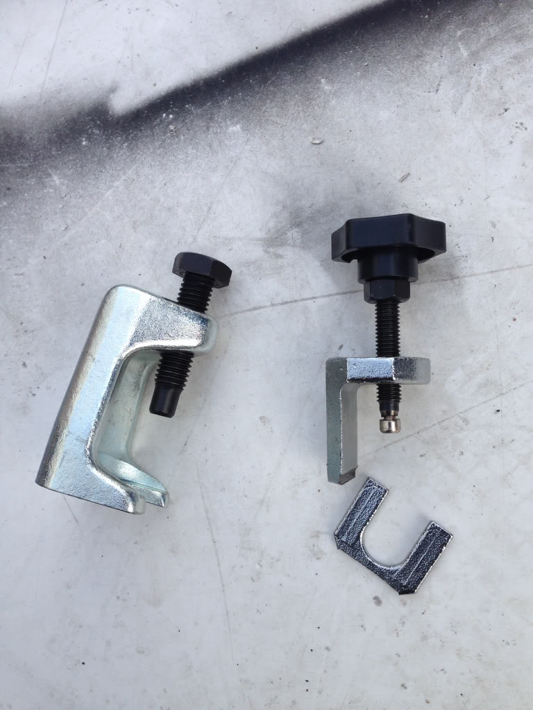

broke my windscreen puller so bought a beefed up ball joint splitter which was a tight fit but did the job an absolute beauty!!!
even cracked out my blow torch at one point these buggers were on tight! Well and truly lubed up when they went back on
wiper mech off
  CLIO 182
Fitted new pump after I was given the wrong one @Feirny came to my rescue[FONT=.HelveticaNeueUI] top[/FONT] lad!
think its a 172 pump on the left so if any needs one give me a PM lol 182 pump on the right is correct for my car the 90 degree one.

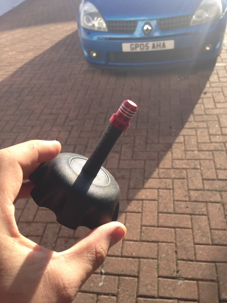

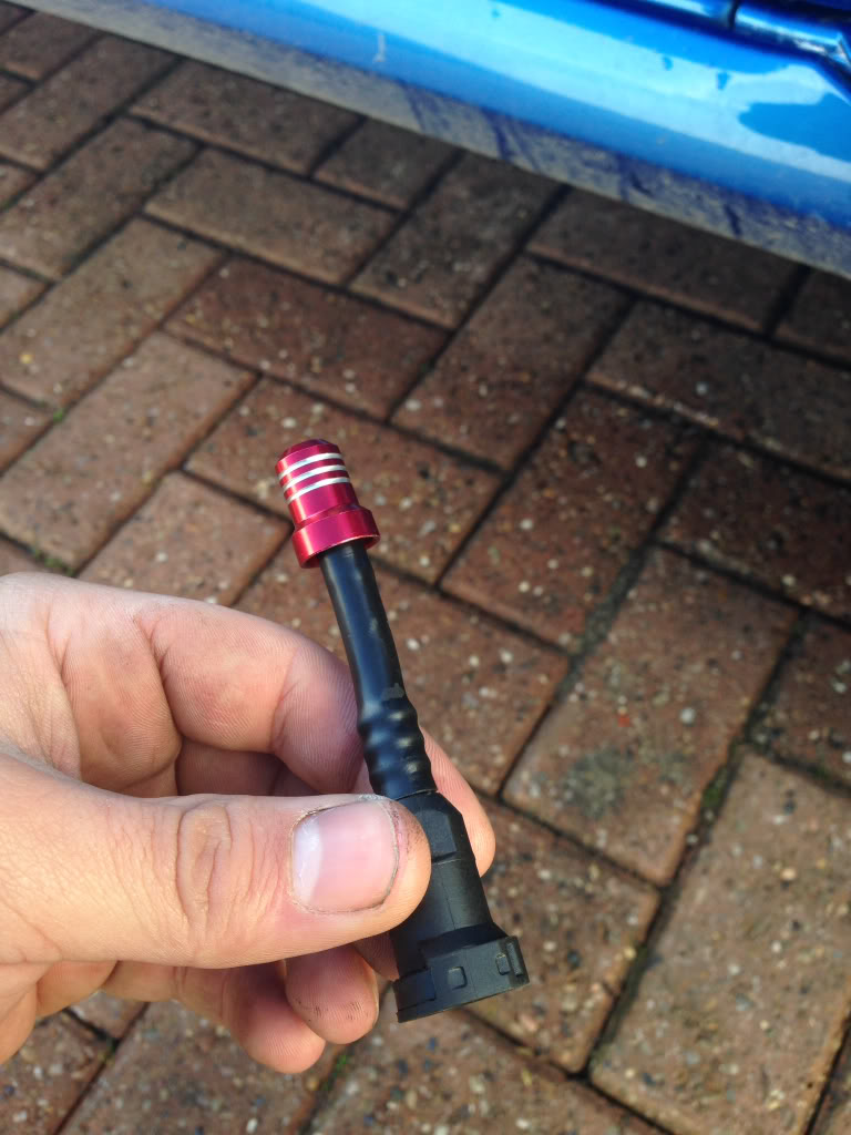

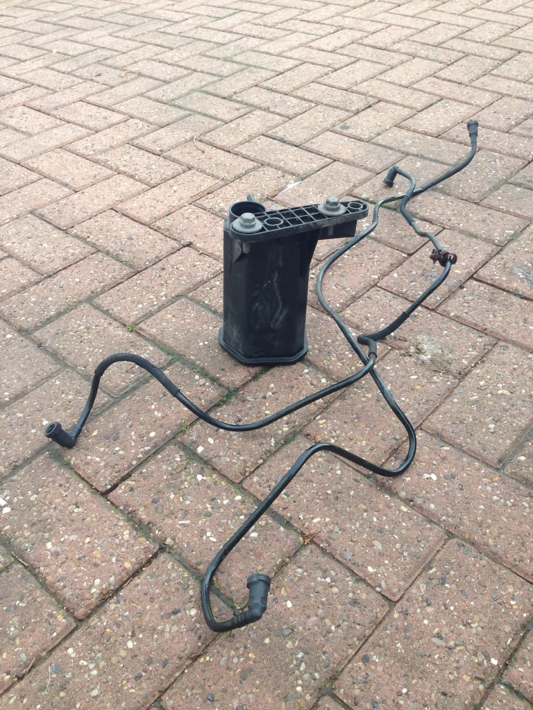

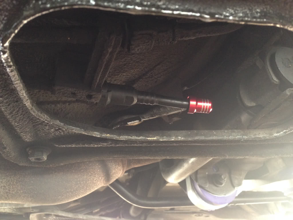

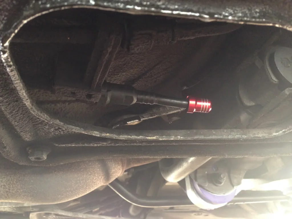

Anyway...removed the carbon canister quite gladly actually as upon further inspection it was full of bloody water! So no idea if that was misting lovely water vapour into my inlet or not but anyway that's been sacked off and blocked up.
For any if you interested in weight, it weighs sod all lol but every little helps weighed just over a kilo with pipes but I'm guessing the water contributed to some of that,
Originally I blocked off the line from the tank, this was only temporary as it was causing a vacuum in the tank. You could physically here it whining after a short journey and feel the pressure when taking the cap off, so I'm guessing it used the canister as a breather too.
changed the bolt for a one way breather I pinched of my mx bike. Looks nifty and does the job perfect! Allows air to be sucked in but doesn't vent fumes near my exhaust. You can buy these for like £7 in pretty much any colour new.

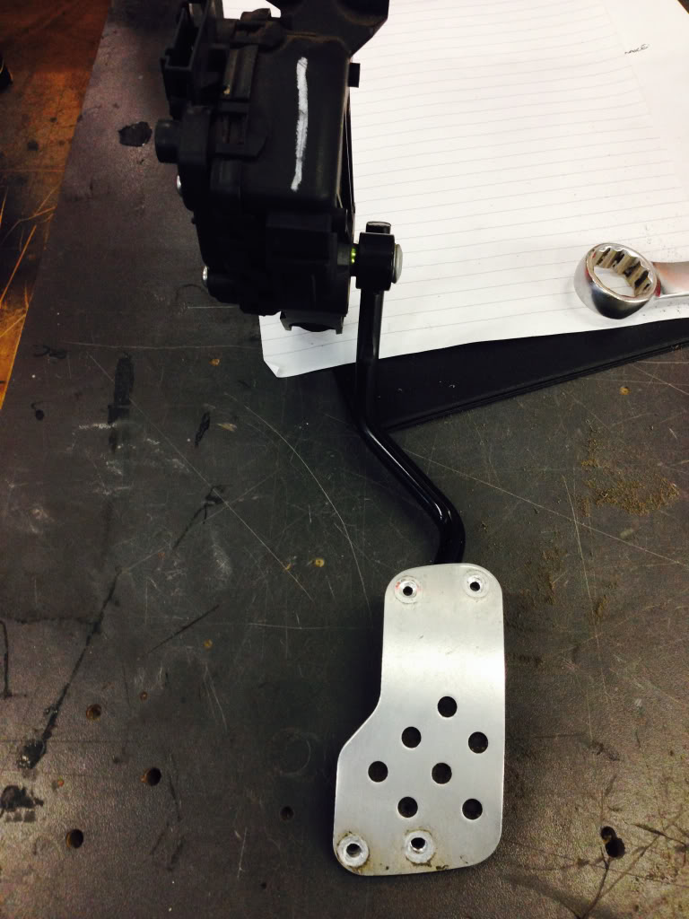

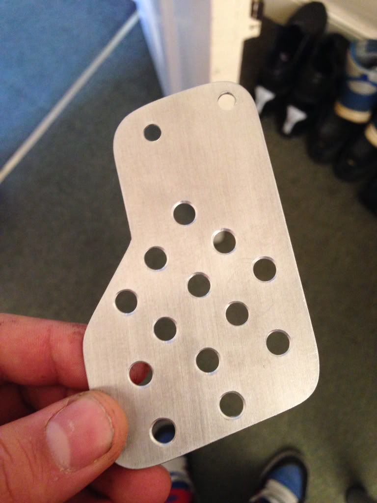

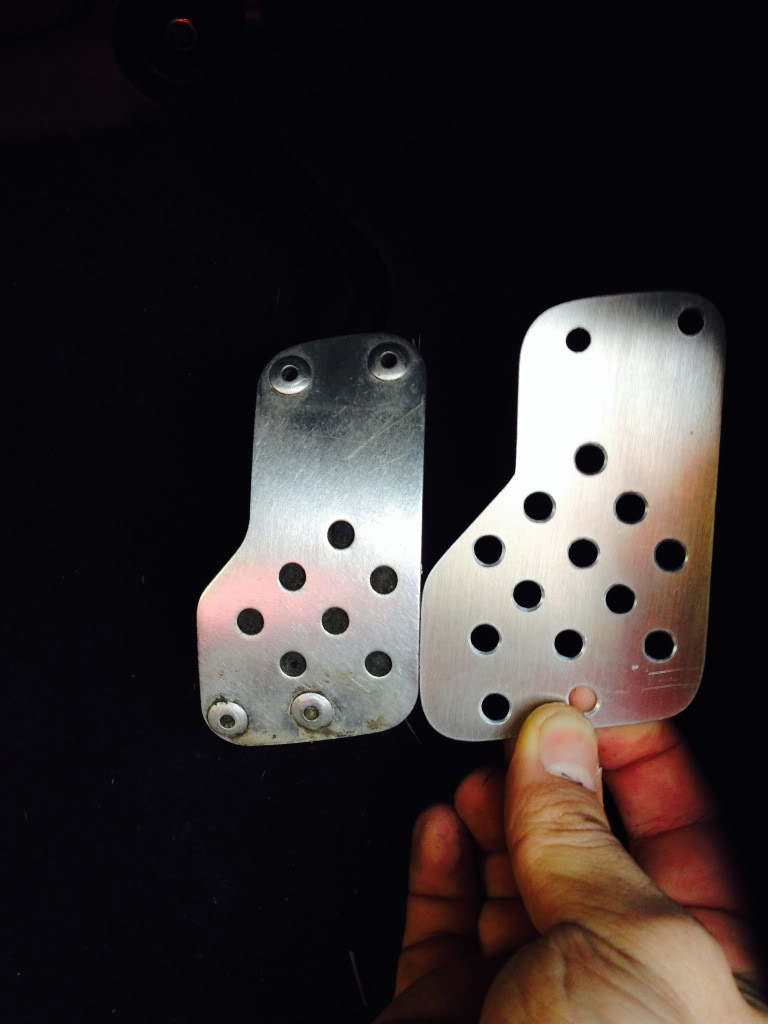

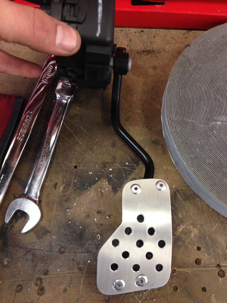

And a big thanks to NorthloopCup who provided me with a wider throttle pedal plate at £14 its probs the best money I've spent on the car. Really worked great on track and doesn't get in the way on the road. Highly recommend. Get in touch he's got a couple more sale. But there selling like hot cakes so pull your finger out that includes you Narf
