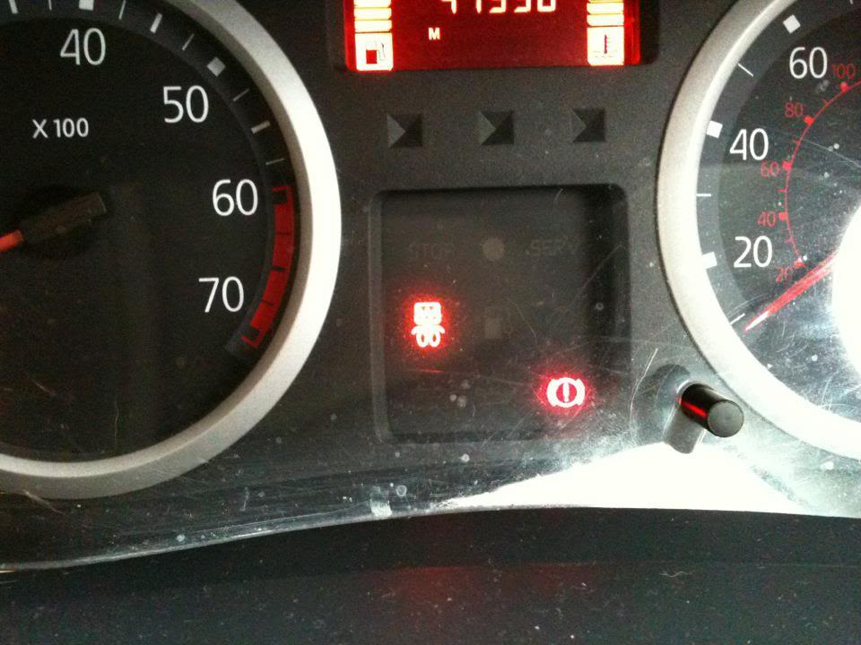

Someone Please tell me how to fix this
  Clio 1.2
This light came on dash earlier and wouldnt go past 4000 revs so i pulled up and turned engine off left it a few mins and turned back on and it went and no more misfiring but the engine managment light is now on any ideas?
  twingo
could be anything. but the light in the picture above is limp mode warning light, need to get a diagnostic scanner on to retrieve the trouble code before you can begin to track the problem down :)
  clio dci , ren8
Throttle body is the most common on a 1.2 16v but as said earlier would pay to put it on diagnostic as throttle body is not cheep .
