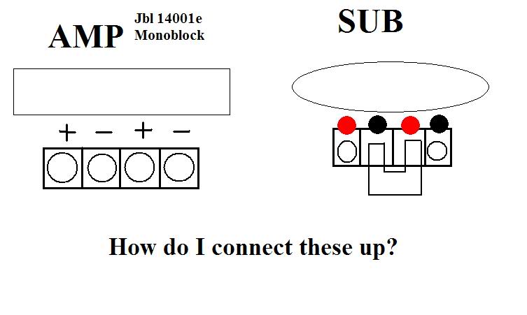

I have never fitted a monoblock amp like this so i dont really know what to do with the speaker connections part.
Here is my best paint skillz for ya. If anyone could point me in the right direction that would be great.
Thanks

well the connections on the amp are connected anyway (both +'s and -'s are connected)
so run some fairly thick speaker cable to the sub and either leave the link on the sub and connect it to the spare terminals or link both reds and blacks and connect to one pair of red and blacks
if that makes any sense lol
  Polo + Micra
yeah the first red and black is one coils and the pair is the other
basically you either connect them in series or parallel depending on the voice coil impedance
  Ph1 172 + Combo van
The spec for the sub says impedance: 4 ohms.
Would i need to connect it up in series or parralell?

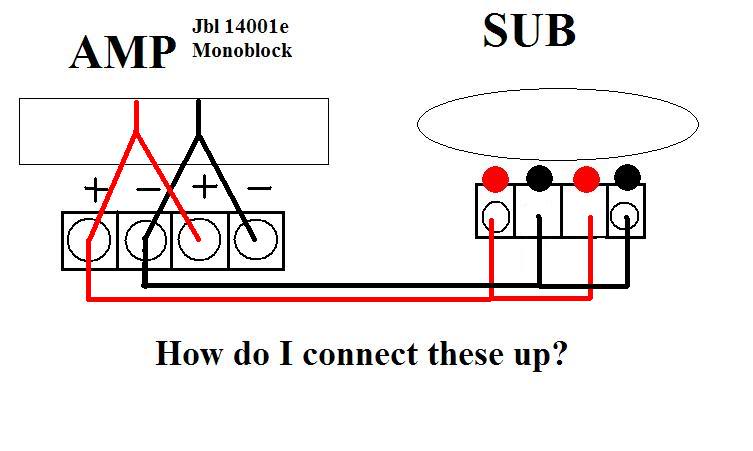

You state the sub is 4ohm, but is that dual 4ohm, or dual 2ohm wired from factory as a nominal 4ohm....Could do with a link to the actual sub to clarify....
The JBL GTO14001e will handle a 2ohm load no bother, the question is, will your current power supply & charge circuit ???
From your pic above;
If its a dual 4ohm, with coil jumper fitted as above final impedance is 8ohm....
If its a dual 2ohm, with coil jumper fitted as above final impedance is 4ohm....

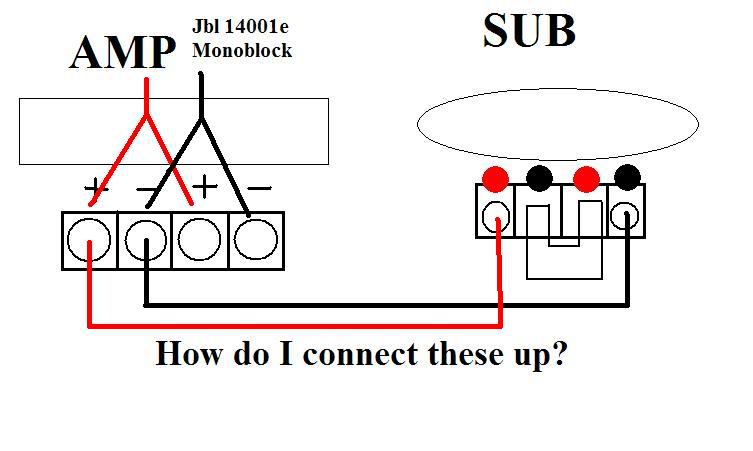

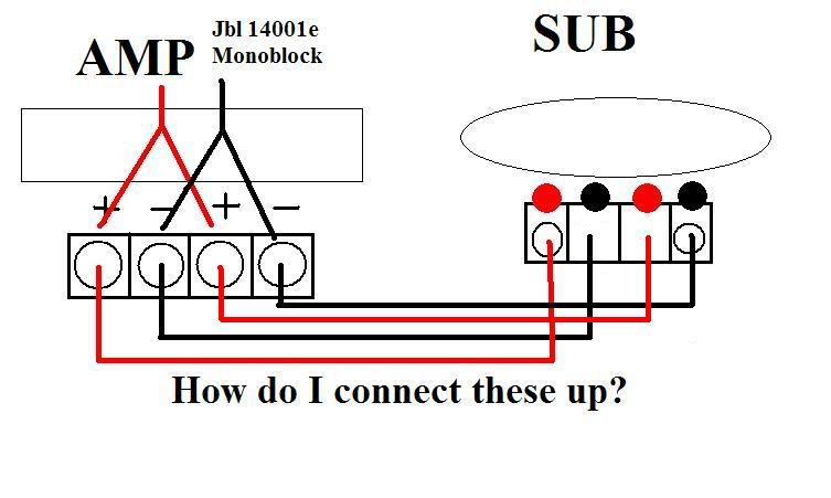

With regards sub voice coil configuration;
If your sub is dual 4ohm, then connected as;
If your sub is dual 2ohm, then connected as;
OR AS;
Your final overall load/impedance will be 2ohm....
Your final overall load/impedance will be 1ohm....14001e is NOT 1ohm stable
Configured as;
Your final overall load/impedance will be 8ohm....
Your final overall load/impedance will be 4ohm....
So, if sub is dual 4ohm connect as;
If its dual 2ohm connect as;
Hope thats clear enough mate....
