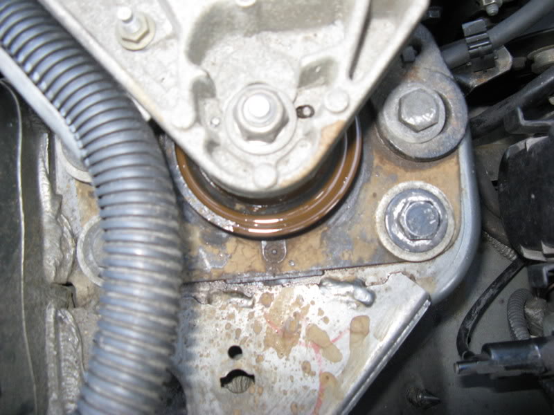

Hi all,
During my recent cambelt change i notice this mount seems to have perished underneath and is leaking like a oil ? are they oil filled and will this effect its performance, the reason i ask is the mount still seems very solid and the cars done 26k miles bit low for an engine mount to die ?
Thanks Tom

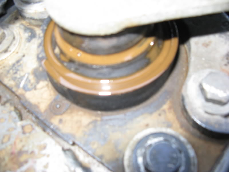

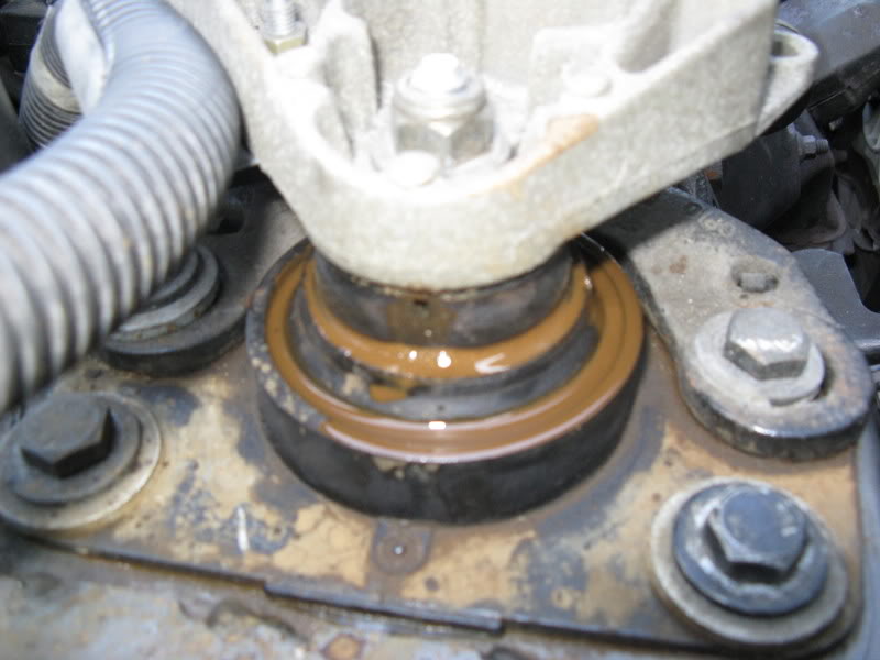

No it must have been spilt or leaked from somewhere else. Maybe spilt from an oil change. Theres not much near the mount that would leak oil tbh. The rubber can perish but it doesnt look like oil. Can you take a pic?
on photo bucket, what part do I post on here to get the pics up, ive just put them on there
  Fiesta Zetec
is the mount fked then??
cheers
  RS RIP
yes, defo gone.. this is what the Renault mech was talking about
